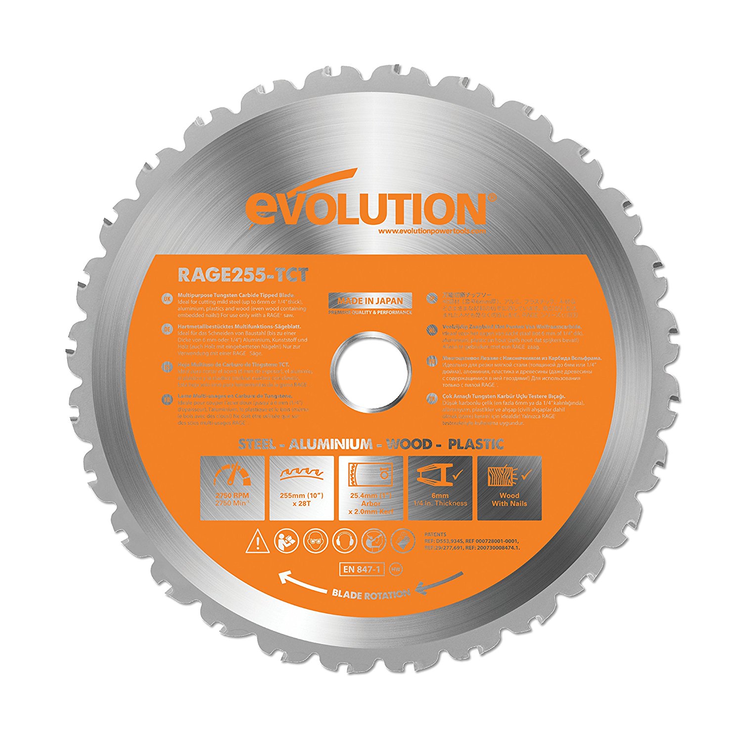

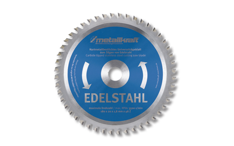

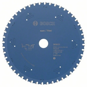

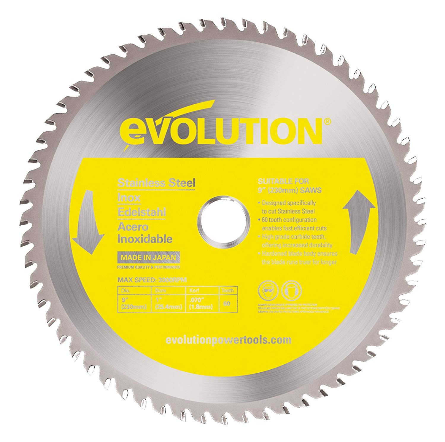

    So I figured I would add some images to this post to see if I get what you guys are saying.
    Below are two blades sold as steel and stainless blades that seem to have a positive angle. And the one from Bosch with a negative or 0 angle. Is this correct?
    What is your take on the two first blades?
    Also, what do you make of "multi-material" blades like the last one posted? That angle seems to be odd.

    Mate, #s 1,2 &4 are not MADE of stainless steel, they are for cutting stainless steel. Stainless steel is not used for the blade's blank. Some, like CMT, 'Chrome Coat' some of their blades for rust resistance, sort of like a dull chrome plating..#4 is the 'universal' cut anything blade,(meaning, in reality that it does not do any job well...). It is designed to be used to cut through materials that may have nails embedded, metal parts or flashings attached etc. Notice on 3 & 4 the small gullet with a 'bump' after it. This common on metal cutting blades. It keeps the blade from grabbing the hard material too aggressively, which will cause problems. #1 is the closest to what you might want for a chop saw or RAS. The 'hook angle' is the slope of the face of the carbide tip relative to the radius of the blade. So, draw a line parallel with the face of the tooth and compare it to the radius of the blade. #s 3 & 4 have negative hook, and are for stationary chop /mitre saws, cutting metal. #s 1 & 2 have perhaps 5 deg forward hook and for cutting metal in circular saws or table saws.
    What are your uses? What materials and of what thickness do you cut? What make and model of tools do you have? Where are you located? If you can help with the details, I happy to make recommendations for you, as it is a real minefield these days trying to select saw blades! Cheers
    Jim
    30 yr expat in AUS

    I respond to threads without enough information of what the intent is. But I did mention in my reply earlier the crosscut and the rip, if anyone know anything about saws they would already know I was referring to wood. The brown stuff. I forget today there are blades designed to cut metal and as the 4th blade you posted can be used for that. It is all in the design and the insert that is brazed on it. This blade will not do a great job on wood even if it says it will. It also says it will cut plastics, I would be very surprised if it did a good job. Plastic get hot and starts to melt with nothing but disastrous outcome. I have seen some videos of chaps cutting steel, flat and angle stock with good results. I think it might be worth a try but first I would need to clean all the wood dust up. With the sparks generated it would be very easy to have a shop fire and burn your equipment up.
