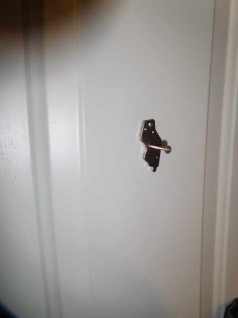

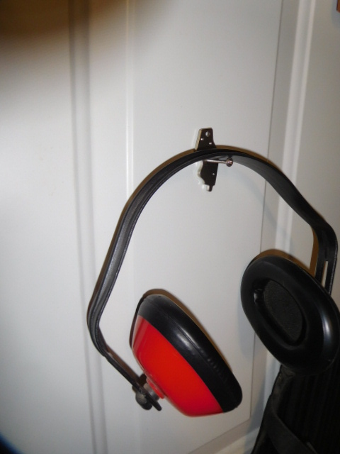

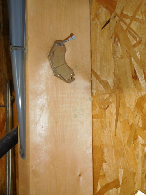

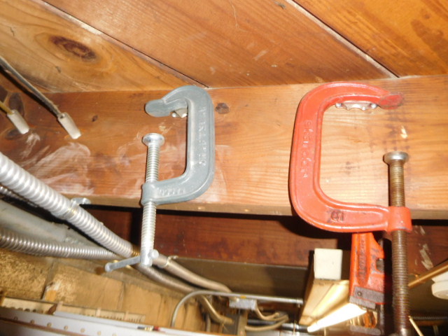

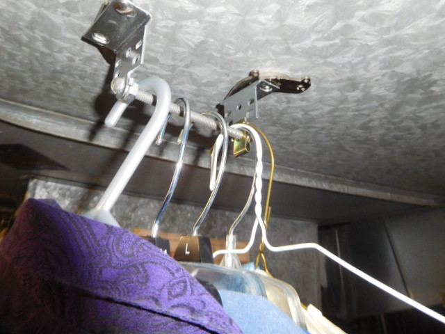

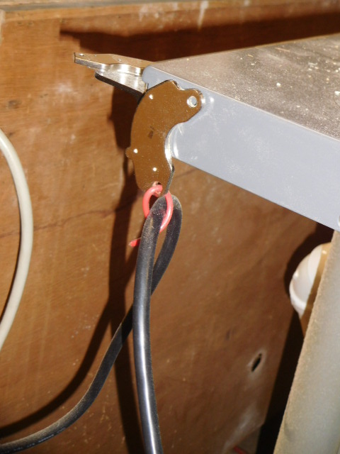

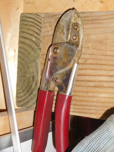

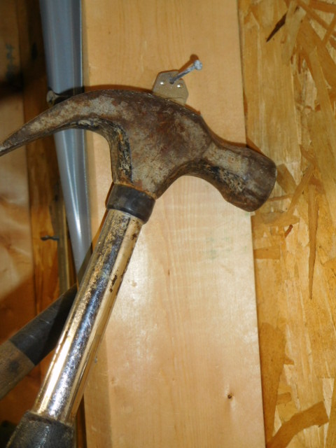

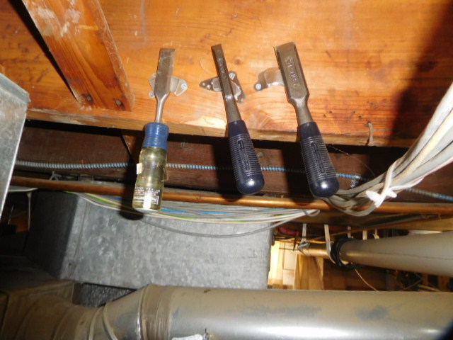

    Hard drive magnets uses
    Uses for Magnets-tool-board.jpgUses for Magnets-tool-board-magnets.jpgUses for Magnets-tapped.jpgUses for Magnets-tapped-magnet.jpgUses for Magnets-pruning-shears.jpgUses for Magnets-p-s-magnet.jpgUses for Magnets-house-chisels.jpgUses for Magnets-hammer.jpgUses for Magnets-hammer-magnet.jpgUses for Magnets-garage-chisels.jpgUses for Magnets-garage-chisel-magnets.jpgUses for Magnets-door-curtain.jpgUses for Magnets-cord-keeper.jpgUses for Magnets-clothes-hanger.jpgUses for Magnets-c-clamps.jpg
    Magnets from hard drives in various uses in the house and garage. I have a stack of drives from which to retrieve the magnets.
    Tool board, Metal door hook in garage, Pruning shear holder, Chisels on basement joist, Hammer on garage stud, Chisels on garage wall, Curtain on metal door, Cord keeper on table saw, Clothes hook on basement duct work, Clamps on basement joist.
