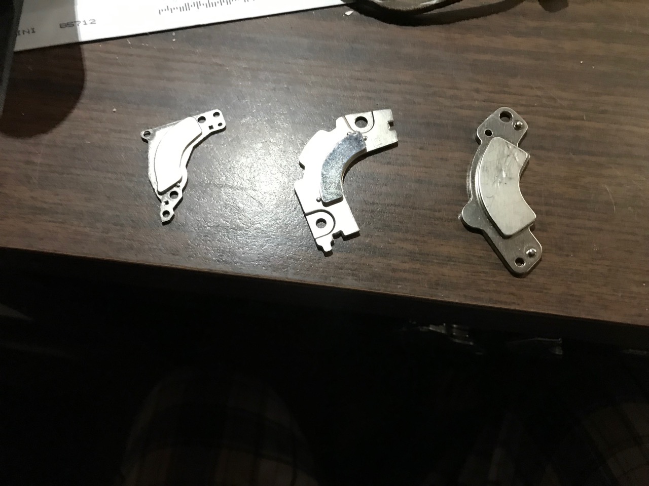

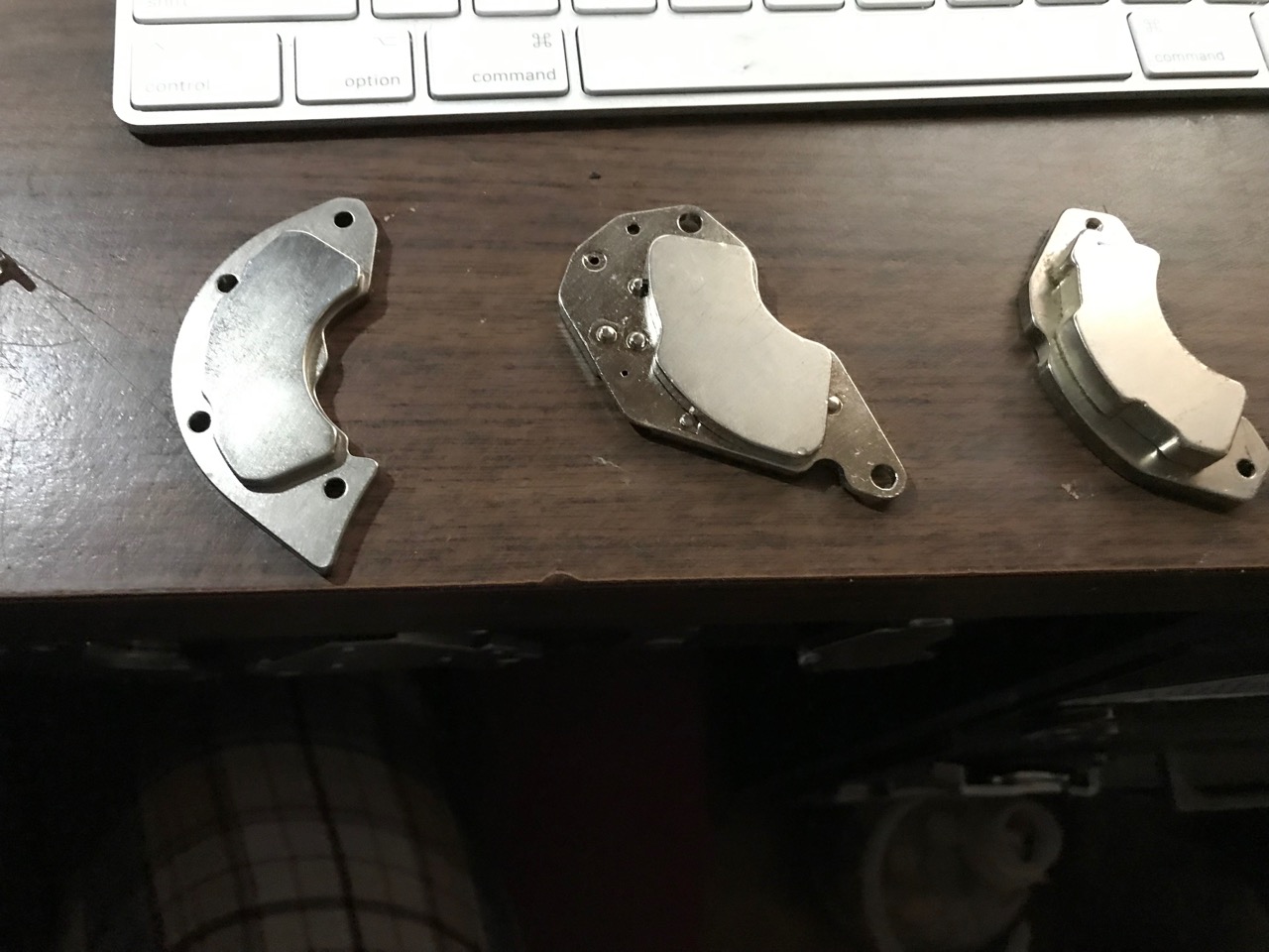

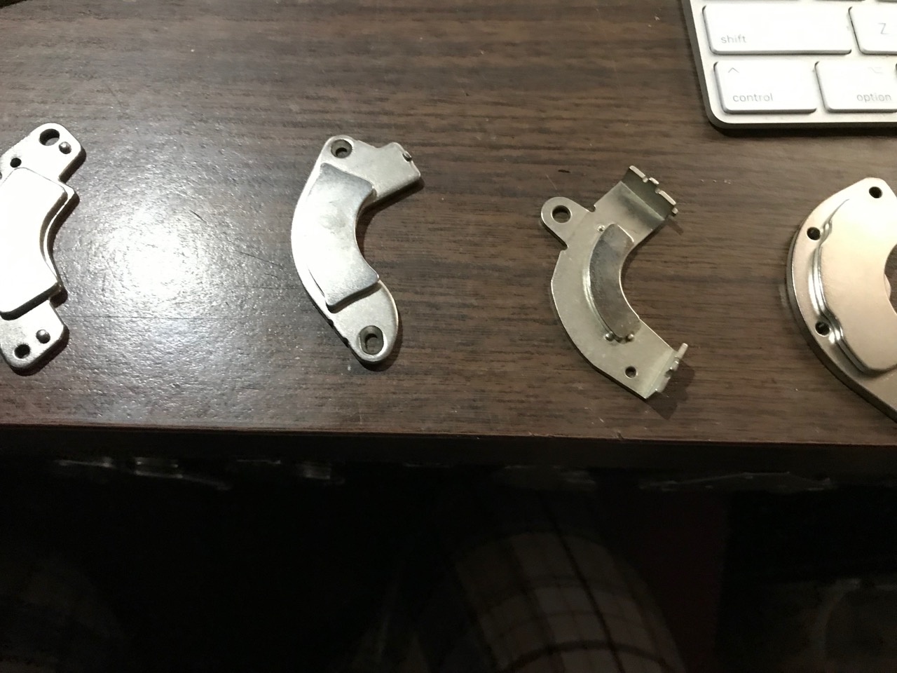

    I have one of those little round magnets on the top of my drill press, holds the chuck key right there.
    A good source of scary strong magnets is old computer hard drives. They're fiddly to disassemble (but you then have a large collection of nice little 4-40 torx 8 screws as well) buy they're very strong and come conveniently (or inconveniently, depending on your needs) attached to a sturdy steel back with pre-drilled mounting holes. The best come out of old 3½" SCSI server grade drives. One I have in our kitchen holds about 30 pages of recipes to the fridge. attached are common examples.from a 2¼" laptop drive, some consumer grade drives and the thick ones are some of those server SCSI drives. You most definitely don't want those bigger ones tocome together at any speed, they shatter into a billion highly magnetic, razor-sharp shards.

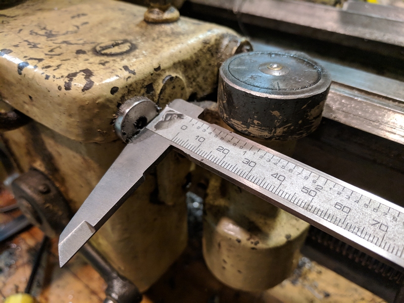

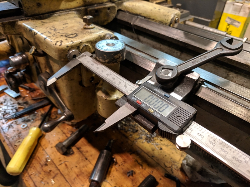

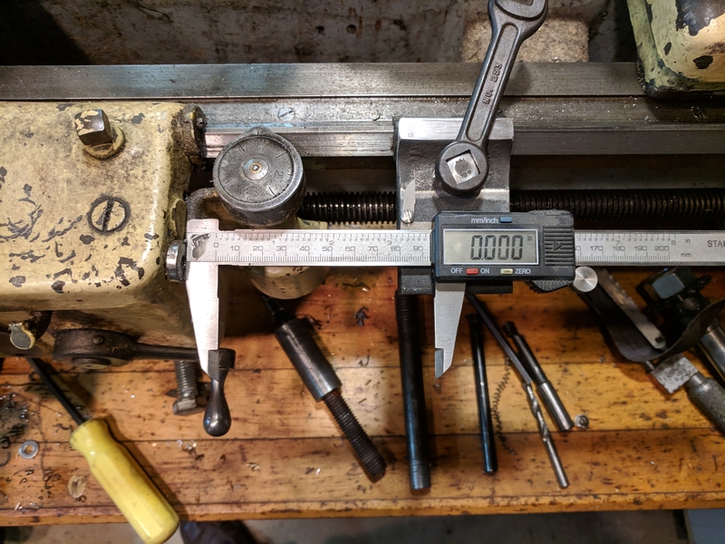

    At the risk of being slightly off topic: I made my own version of a carriage DRO for my lathe from a stainless 8" digital caliper. One jaw is screwed to a bracket that clamps to the front way. The other jaw hangs out in space when not in use, and attaches very nicely to the carriage with a 13mm neodymium magnet when in use. It's really very snug and tight and reliable, and very easy to attach and detach.
    You can see the remnants of JBweld, which I originally had used to attach the magnet to the caliper jaw. But it actually made alignment more difficult, and the magnet sticks to the caliper head so nicely that it's much easier to just leave the magnet on the carriage and stick the caliper head to the magnet.
