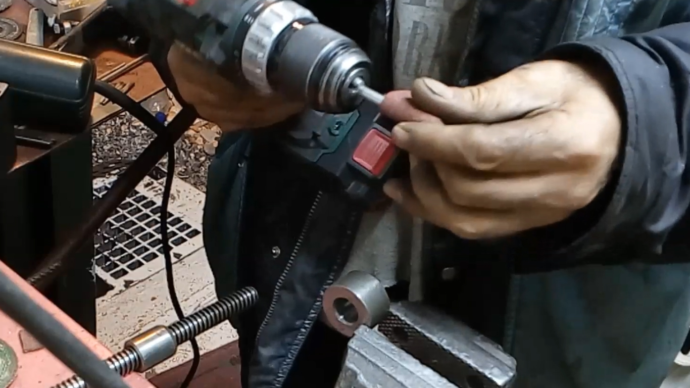

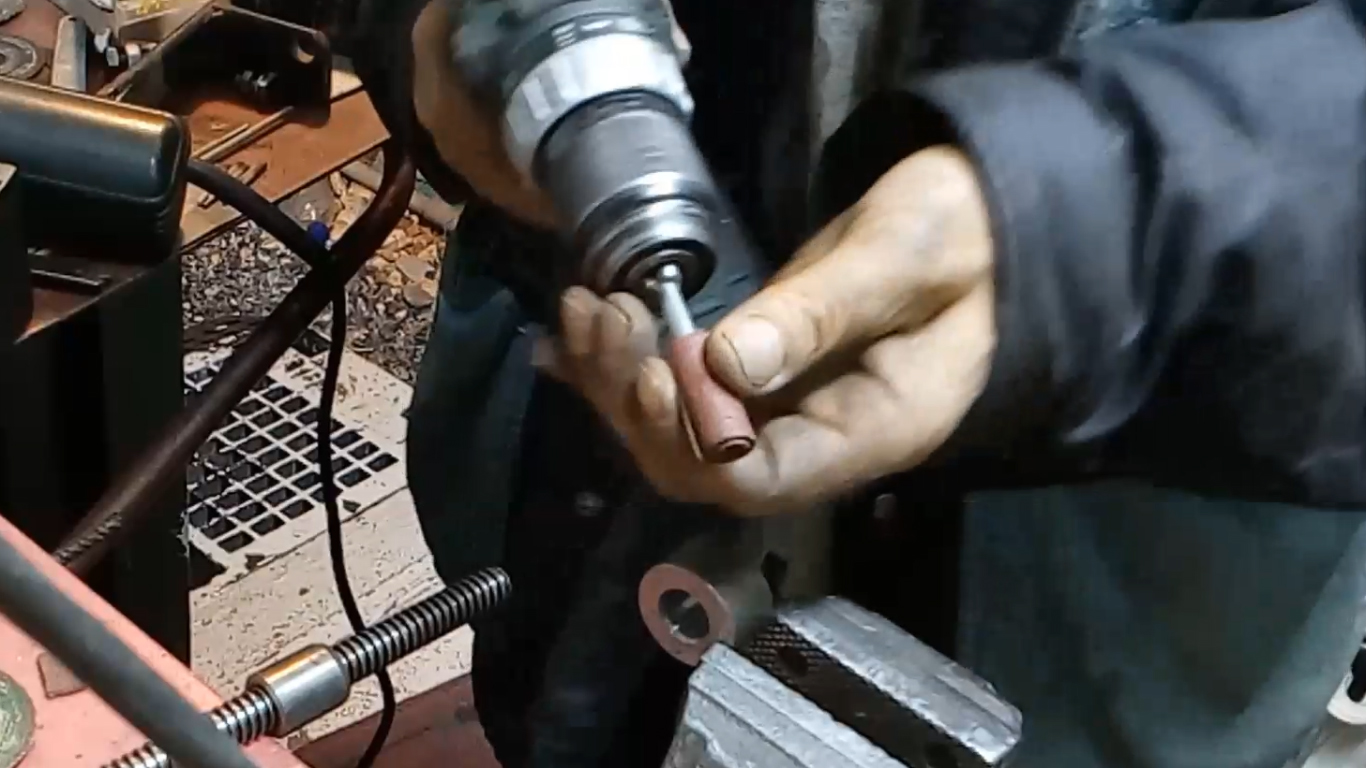

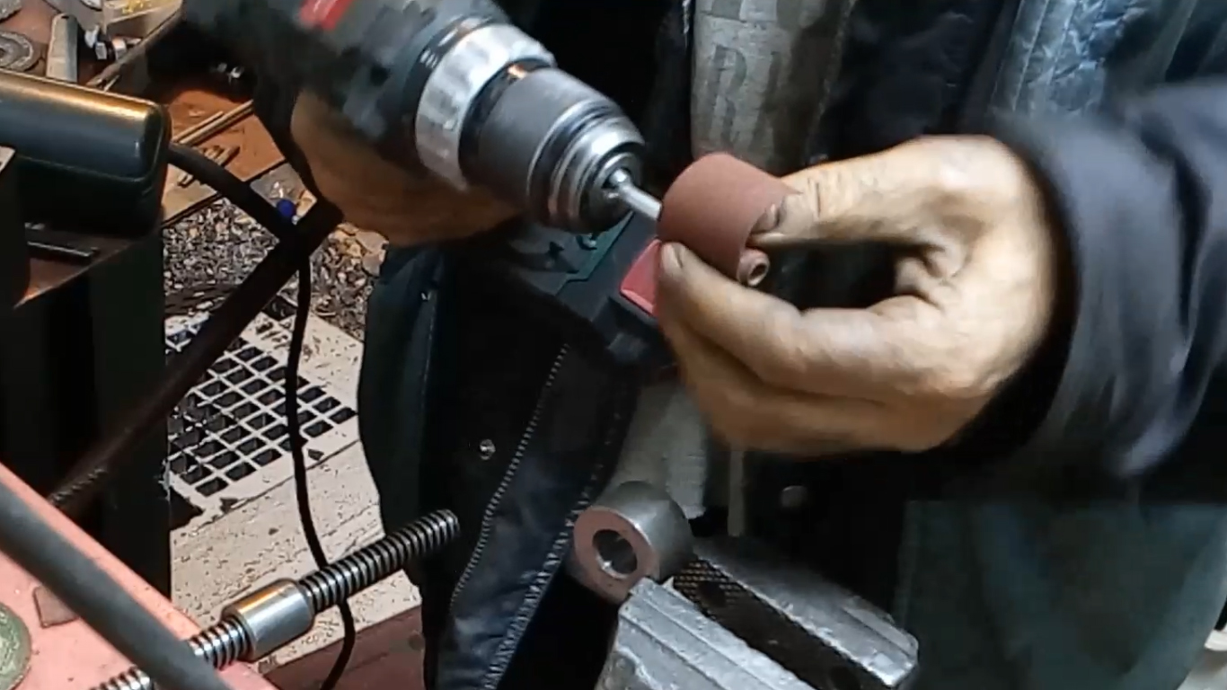

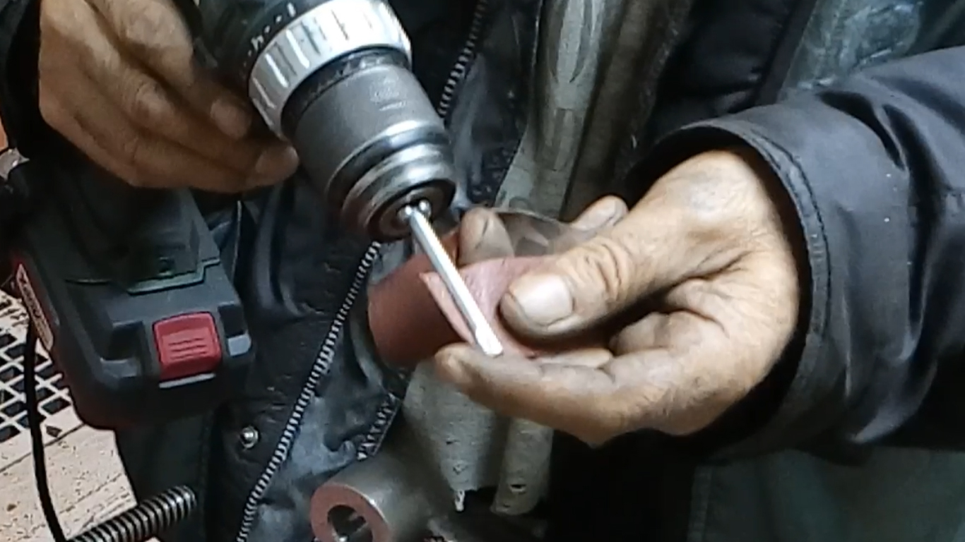

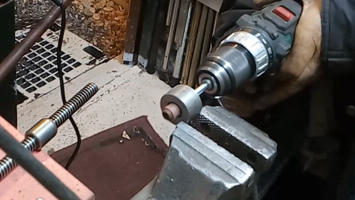

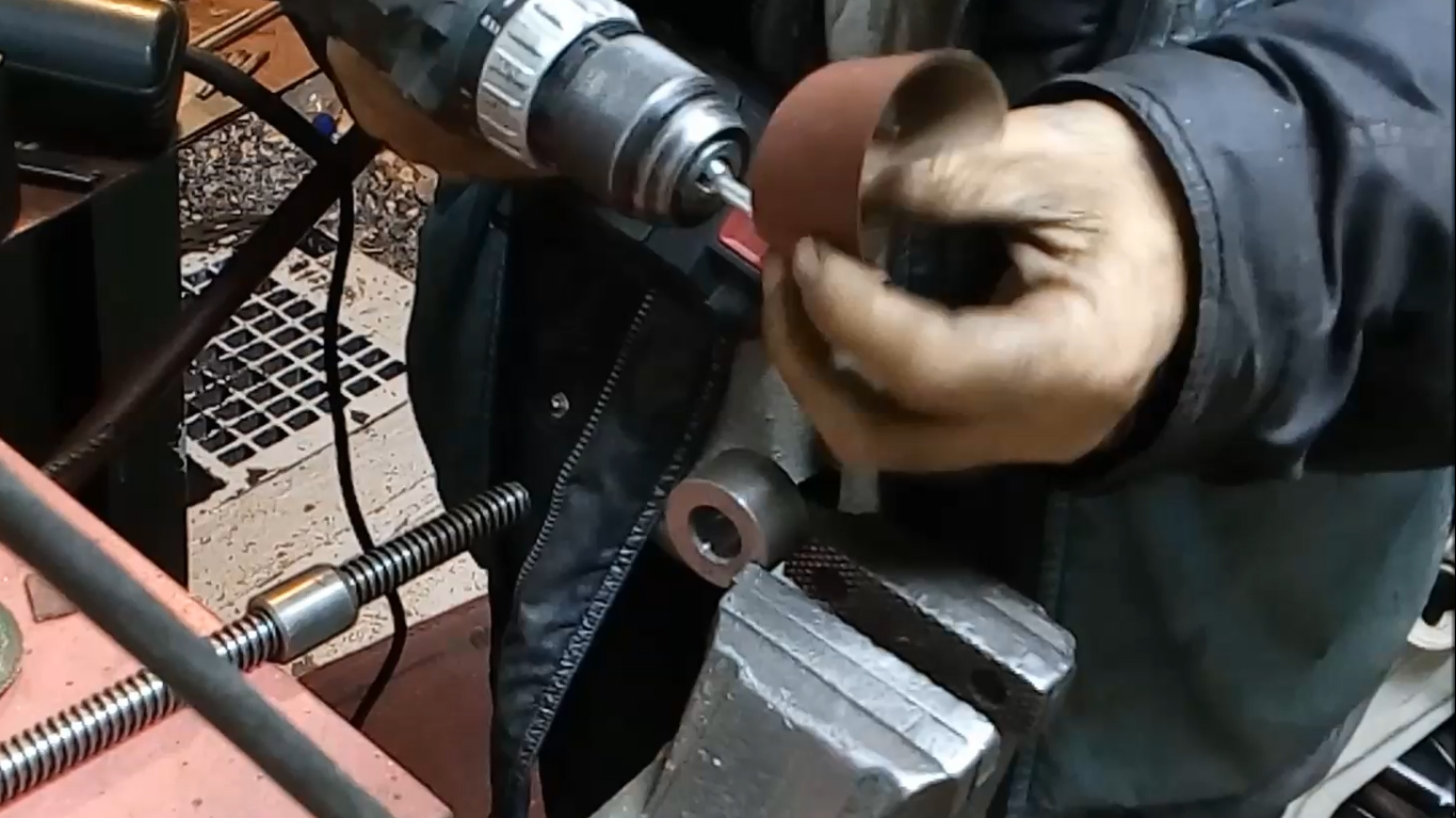

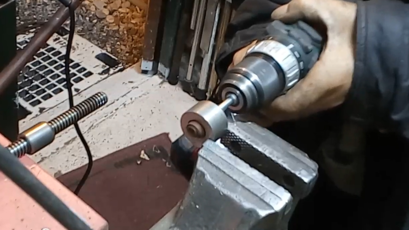

    An easy and useful trick when some times the standard numbers of drill bits (In my case Ø16 & Ø16.5mm) isn't suitable for our needs and the price of midrange numbers is too expensive to bay one and perhaps for only one time use.
    I have use an Ø6mm aluminum pipe (because it was at front of me),
    but a piece of an Ø6mm steel rod it is a better choice with longer life.

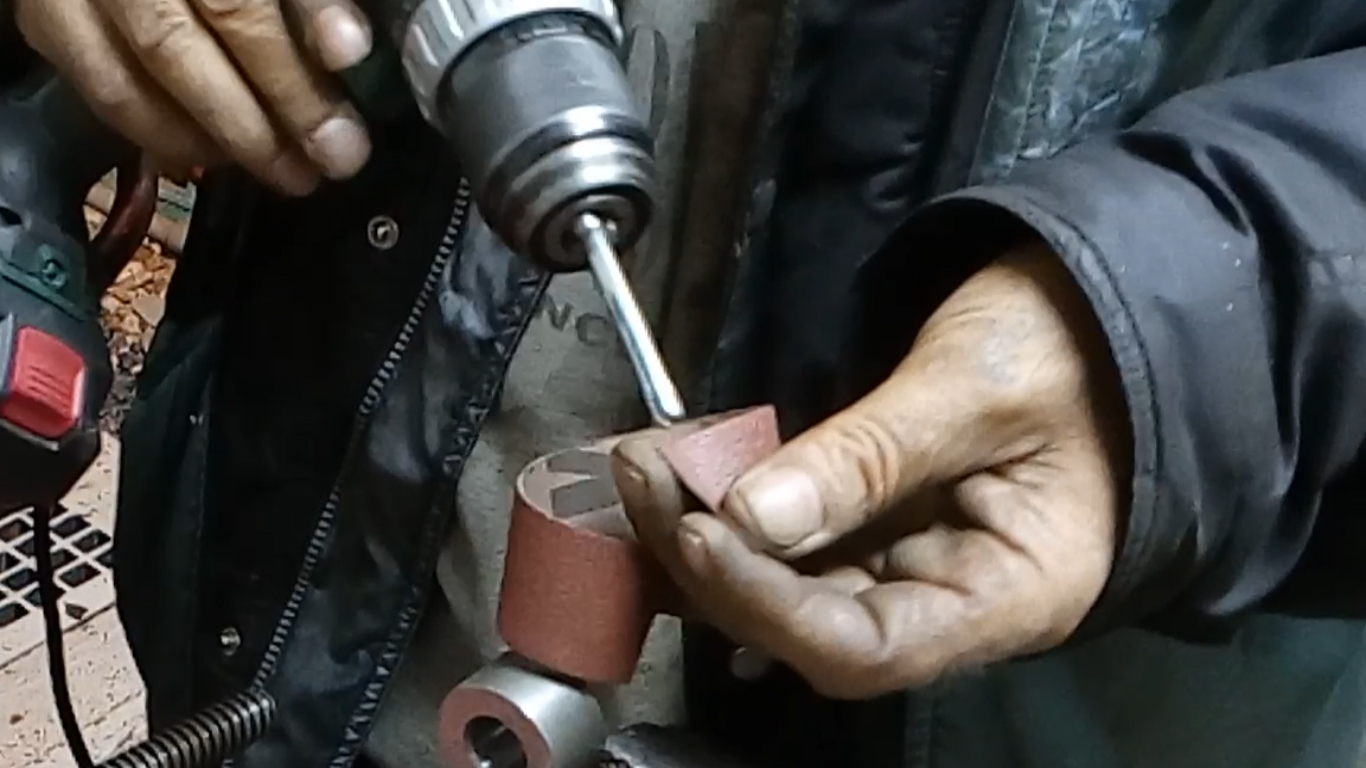

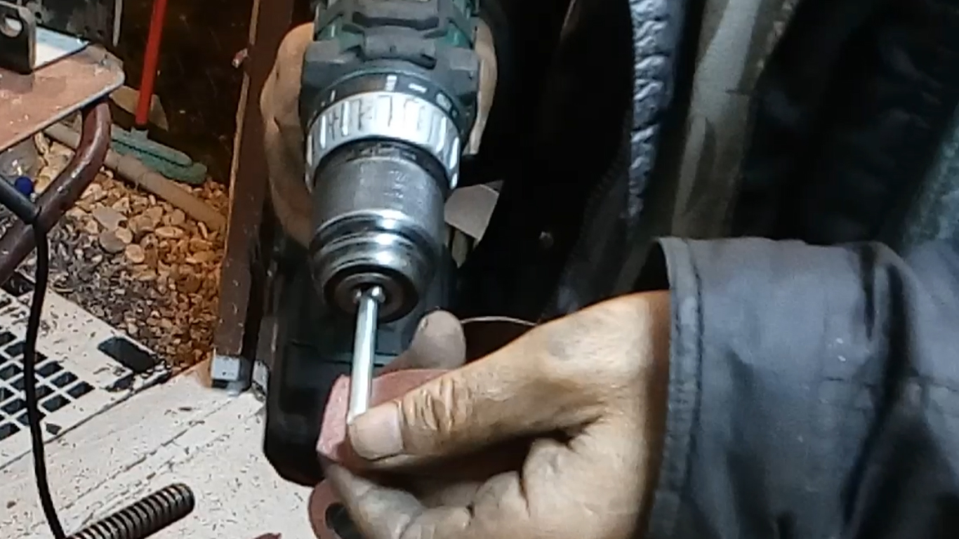

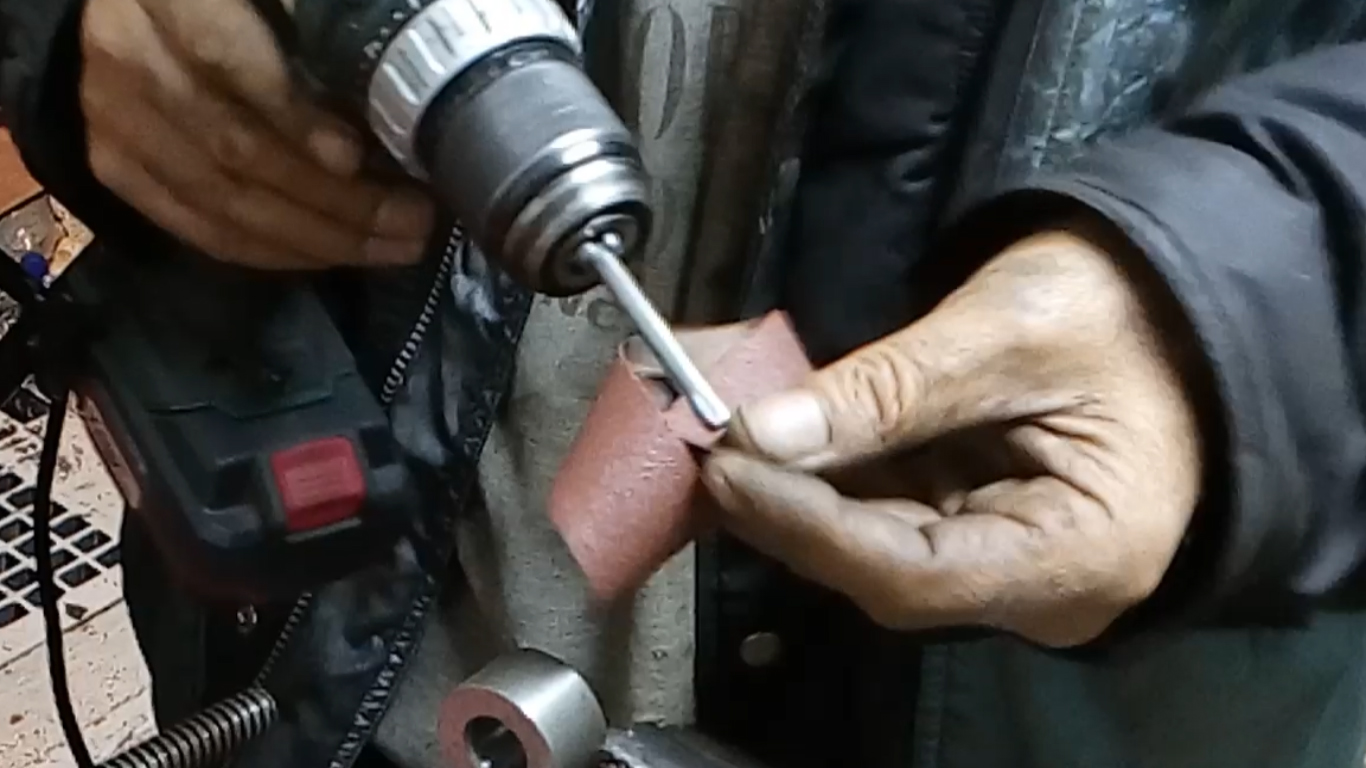

    At the middle of the one edge I make a cut using my grinder with a cutting disk 1mm.
    Then I passed through a strip of emery-cloth Num-150 and wrapped anticlockwise.

    This is operation is known as honing. The results are suitable for a low speed shaft/ bushing combination.
    An improvement would increase the rod diameter [wood dowel is fine] so only 1 or 2 wraps encircle the rod [mandrel], delivering more pressure to the diameter being worked. That also reduces misalignment to bore. Use cutting oil, the mandrel will do admirable job chucked in a drill press.
    The fastest cutting is RPM producing 45° grind lay while stroking straight axis forward and back, without letting the paper bell-mouth entry or exit.

    For many years, I used that method with wooden dowels, mostly in a drill press & didn't really think of using the method on steel. Looking beyond the box but I have a large range of bits but very useful all the same.
    Thanks for posting.
