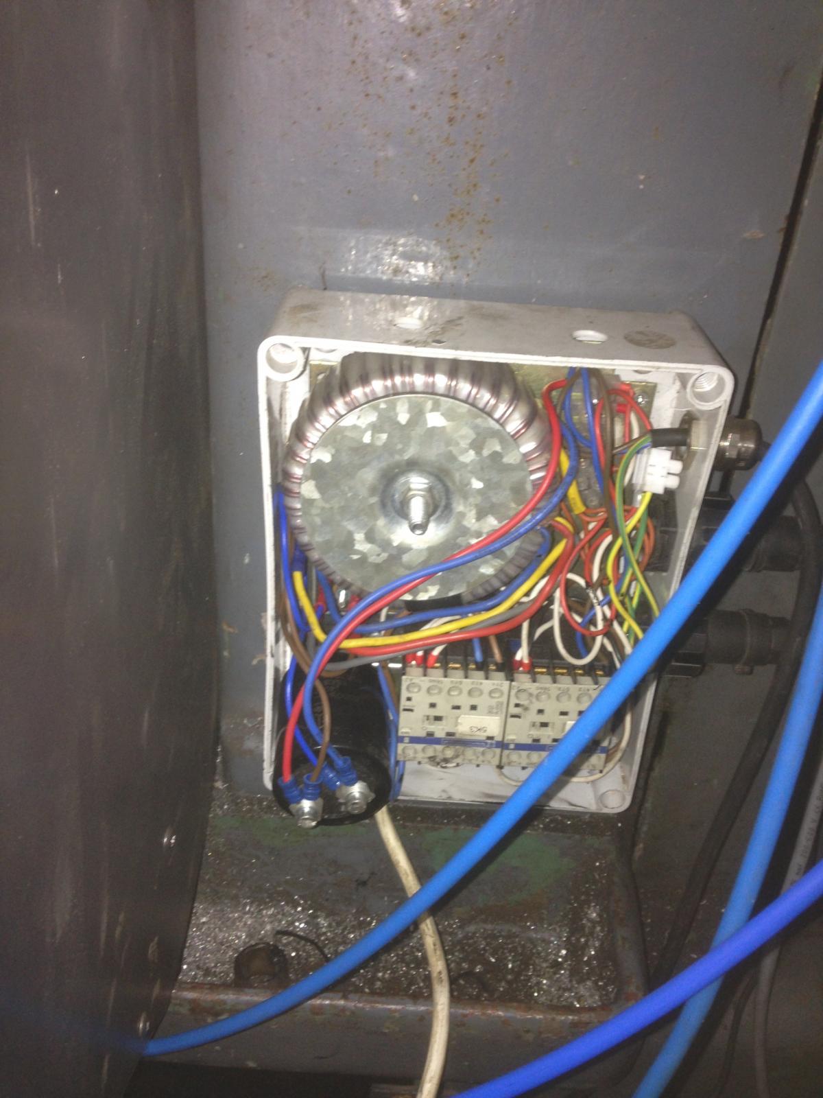

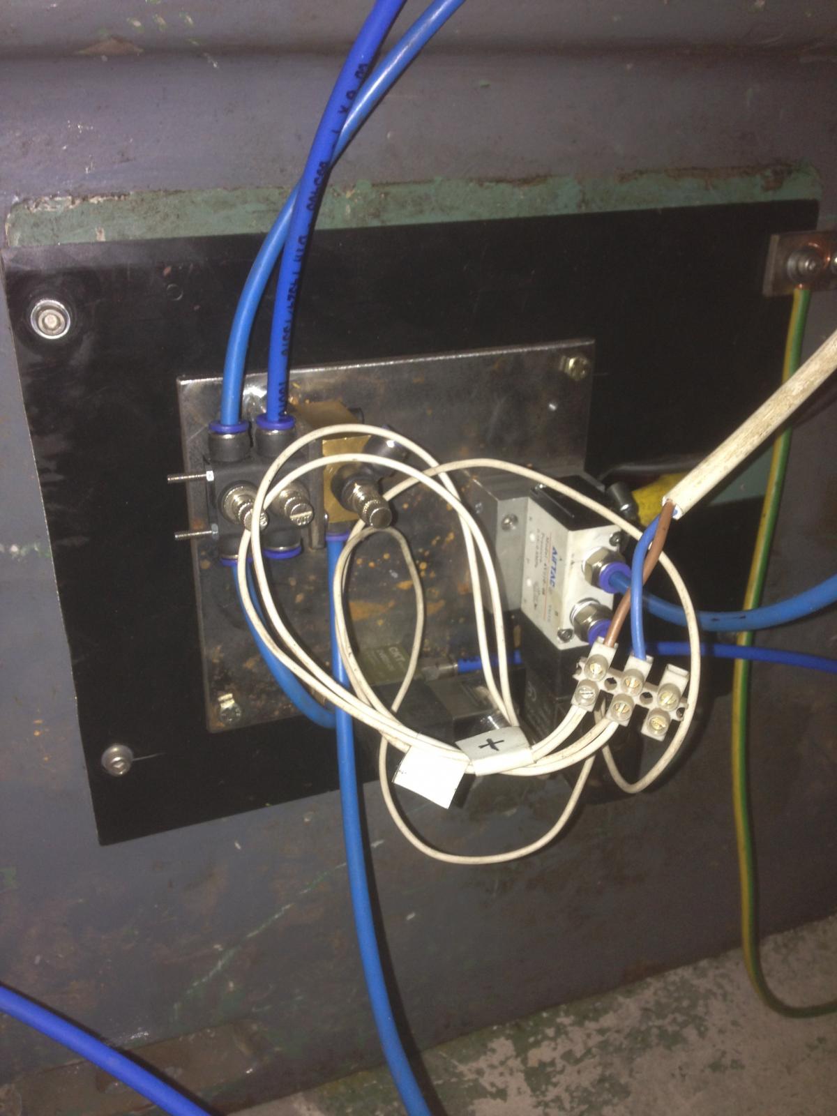

    I continued working on the coolant system, I had to buy a coolant pump. The old pump from the machine had flow issues, it was like the flow rate from a urinating toddler - yes it dribbled more down itself than succeeded in aiming at the work piece.
    A control panel was built which provided both flood and mist coolant options (Gcode M7 & M8), the plan was that with either option the flood coolant pump would run. option 1 would simply divert the flow directly to the work piece and option 2 supply coolant to the mist via a venturi so that i wouldn’t need a separate reservoir.
    It failed
    The (pneumatic) solenoid valve i was using to divert coolant flow just leaked like a sieve and its output was negligible. Before an academic jumps in here, you can use pneumatic and hydraulic parts in either system its the same only the media is different, air, water, oil. Pressure is a concern pneumatics wont work well over 120 psi and hydraulics well pressures in excess of 3000 psi is normal (Im trained to work with high pressure systems exceeding 10k psi).
    My conclusion other than a leaking seal is that the 1/16 hole in the valve is more of a hindrance than anything else especially added to the fact i was using 1/8 hose.
    The fitting size on the pump was a bit of a giveaway at 1/2".

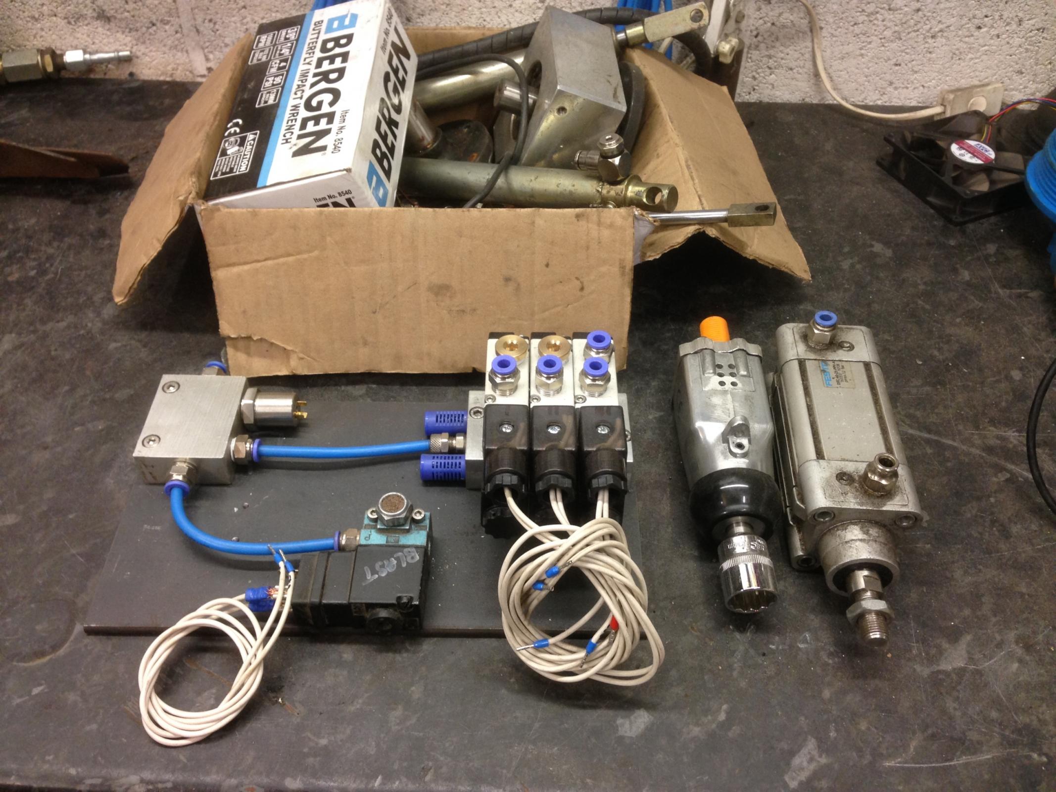

    Im also starting to accumulate bits for the ATC (Auto tool changer)

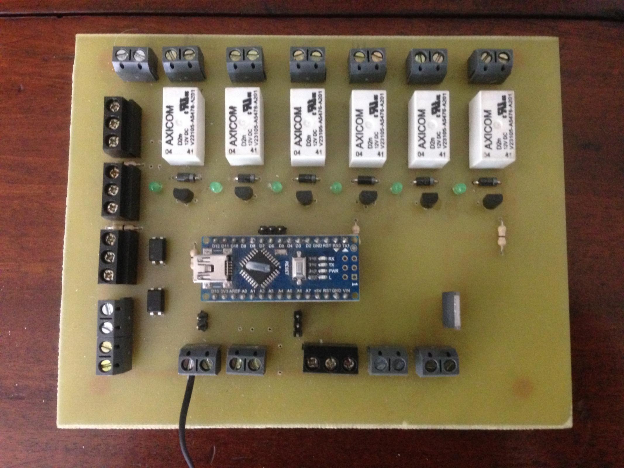

    A schematic has been drawn up and a board etched and assembled for a controller
    The board is ok but my firmware leaves somthing to be desired.
    I have made the aquaintance of a good chap in Glasgow, Scotland who is building electronics for interfacing with Pathpilot David Loomes. If i were the spending type of guy i would have purchased a controller from David. We cant advertise things for sale on the forum but im sure pointing people in the direction of good people isnt against the rules - McMaster-carr, Sears and Lowes get mentioned often enough.

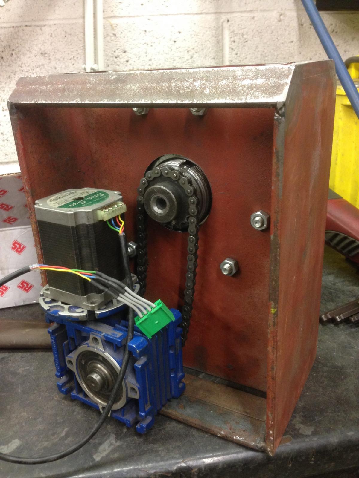

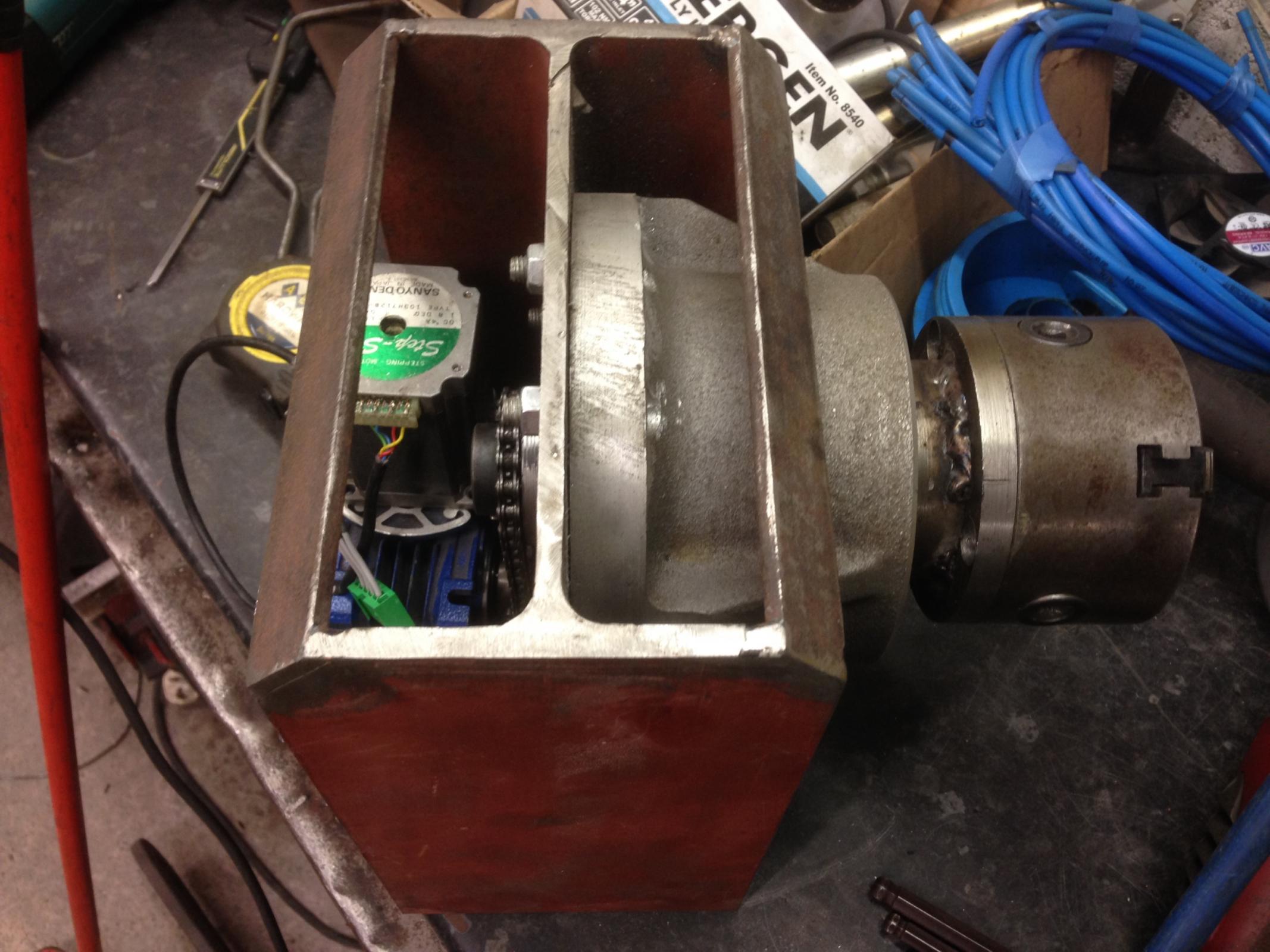

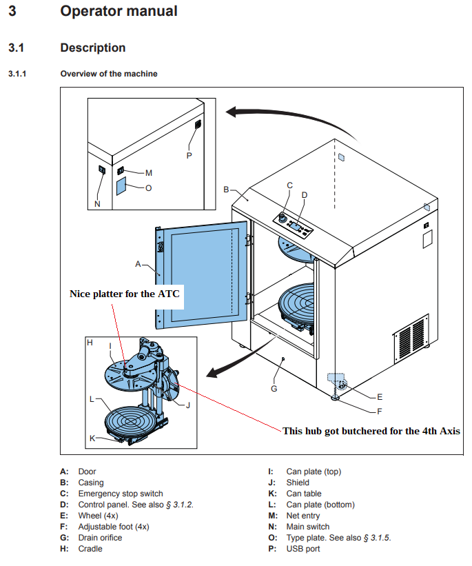

    The 4th axis started off life as a paint mixing/shaker machine
    Updated - Conversion of milling machine to CNC-400x400_schuin-rechts-van-voren-met-blik-deur-open.png
    To be fair my manual machining is as rough as a bag of spanners so i tend to manipulate to get what i want. In this instance i butchered a part from this old shaker as it was obviously designed and built to take alot of abuse and be hold a reasonable accuracy. I chose the "I" beam as its base as it was a solid frame which again was fairly square so that i didn’t have to try fabbing something to farmer boy precision.
    The hub and chuck have been manually spun by hand on the table and the runout measured, It was 2 thou by pure luck. both top and side on to chuck.
    The weld on the back plate looks like i used a mastic gun but i can assure you its not as bad as it looks, a flap disc will soon have it looking pretty. will it work as a basic 4 th axis, i think so. Its £500 for an asian import of 3k+ for a manufactured one. Did i mention not spending dosh.
    all the interconnecting parts like the Gearbox shaft/cog and the drive cog in the end of the spindle were turned on the lathe to a reasonably tight tolerance.
    As the spindle was already part of the shaker it and its mate were both matched. Using the "I" beam gave a flat surface on which to mount the hub, all things being equal that should keep the hub running true. The plan is to use the I beam on its side for 4th axis and at some point in the future the trunnion could expand to a 5th axis by mounting the 5th onto the back plate of the fourth and using the i beam stood on its end (shimmed up accordingly etc). Getting the miller back up and running is going to help immensely.
    You will notice that the recycling theme extends to robbing parts for the ATC as well.

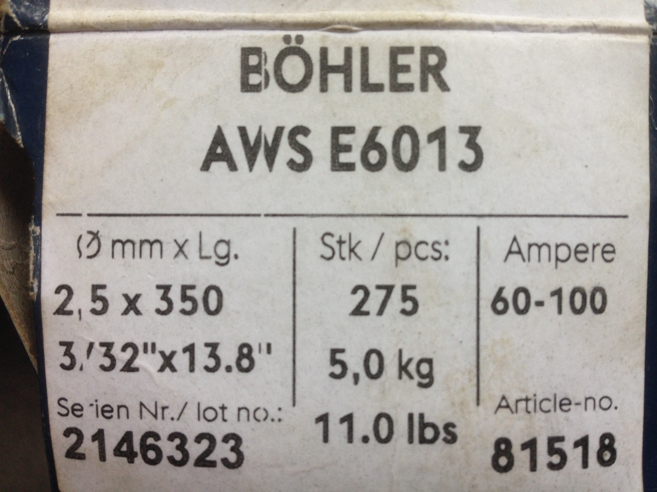

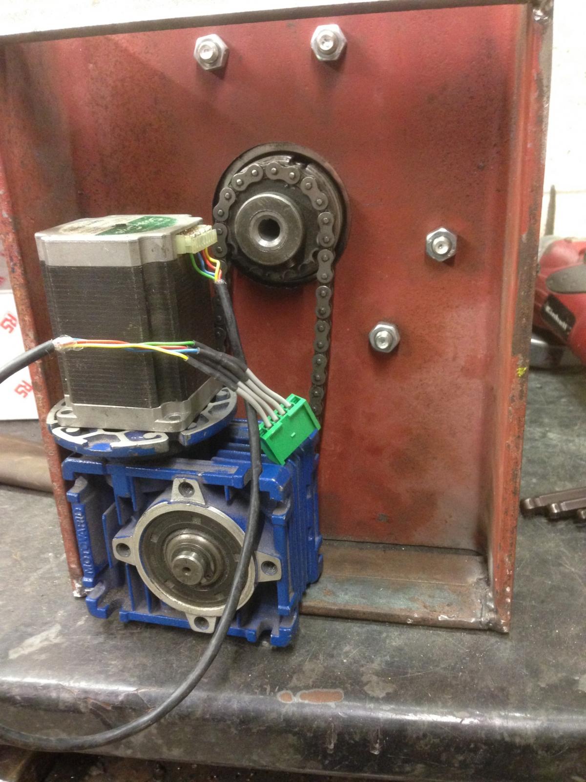

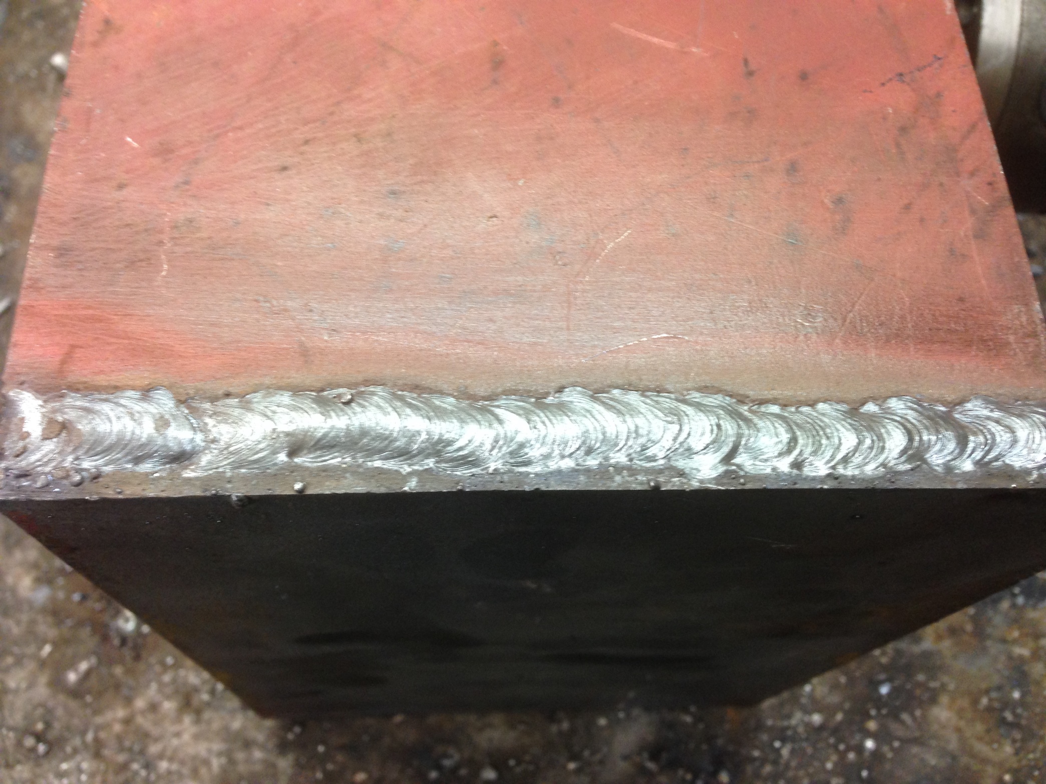

    The 4th axis received a base plate yesterday. I wouldn’t normally share images of my welds to show off but today is different, I was vey pleased with them
    just using a Bohler E6013 mixed metal universal rod 2.5mm and 80 amps. I cheat i use the amperage im told to use on the box the rods come in.
    simple fillet weld where the plate was "V" prepped to make the channel.
