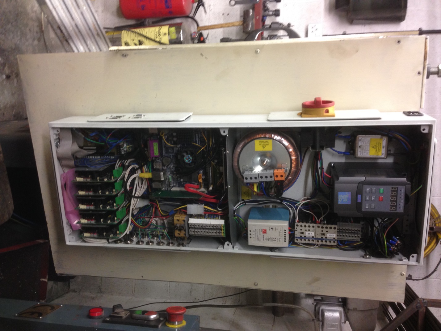

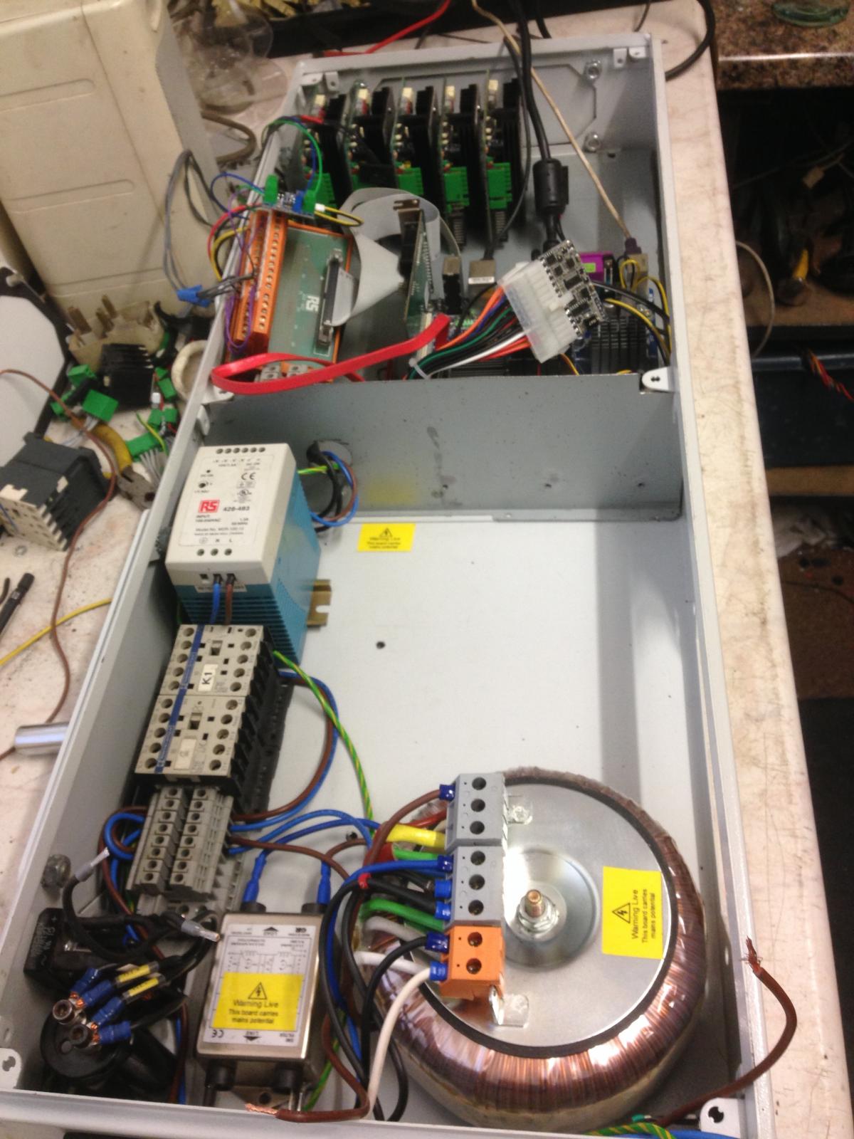

    The brains of the machine is a Gigabit PC motherboard, all the nerd gubings were attached to make it a pc ie. HDD and the handy move thingy and anger thumping buttons. The pathpilot USB drive was installed and the PC operating system installed. If only Tormach wrote windows, the whole task went like clockwork, hats off to the tormach guys for a fantastic product. As a shadow user i find it only fair to endorse their fine work. I am not affiliated with them in any way but feel they should get full recognition for their part in this project. I would certainly not discourage anyone from purchasing their product quite the opposite. - just to be clear we have strong rules on selling on this site.
    Another point that should also be stressed is that pathpilot is a registered trademark of Tormach, they will sell the software as its core is linuxcnc which is open source software and therefore cant be sold or owned. But, the graphical layout and some of the functionality of pathpilot does belong to Tormach. hence the purchase. I went with PP as linuxcnc is typical linux people, i breed of individuals who all think they are in mensa and the rest of us are beneath them, asking for help is like selling your soul. mach3 - in my opinion the graphics look like they were drawn by a 3yr old. Its also expensive compared to Pathpilot which is really only intended for Tormach machines. I have heard Haas users say if only the hass Gui was laid out like Pathpilot it would make using their machine really easy. I think Tormach missed a golden opportunity, they could have had a side business selling controller and interface packages like Fanuc and Heidenheim. I guess its down to the linuxcnc open source thing. Enough politics already.
    I decided to try building the Pc into the panel as it was going to reduce the footprint of the space required for the machine, having used GRBL and having experienced numerous issues with emf/rfi noise causing system crashes i was putting alot of faith in this build. by laying out and getting my head around location and spacing of various items such as the motherboard/transformers and stepper drives etc, i was able to figure out a way of including segregation between power components and control electronics by means of a steel plate divider in the middle of the electrical/control cabinet. whilst building up the panel a number of test were carried out to see if any item would be particularly noisy and affect the machine operation. Good news was not a single issue. with the wiring of the cabinet completed it was time to mount it on the machine, this stage took ages. Procrastination is a very serious part of engineering and takes up so much valuable time, I have come to the conclusion im more of a professional procrastinator than i am an engineer. This should be a new discipline/career path in engineering.
    Finally mounted the panel and started to hook things up, all went without a hitch. the only issue was that the spindle speed was not calibrated and the motor homing and directions had to be altered, obviously the software was not intended to run my machine.

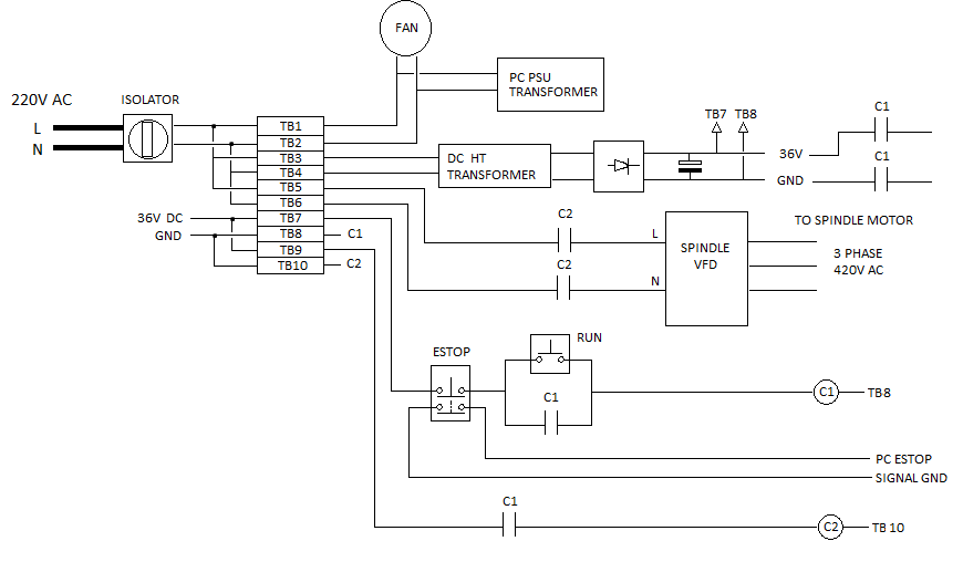

    The mill is still presenting me with gremlins, A second transformer was installed in parallel to boost the current for the axis motors, not successfully i may add. It would have worked better for heat shrinking cutters into tools, spent ages chasing down erratic axis moves until i realised the transformer was nice and toasty. back to one transformer now and the machine is back running like a dream, all be it close to the power limit of the transformer. 3x 4A axis motors from a 10A transformer, umm another purchase is on the cards. Its unlikely that the transformer will take a hit of all motors starting up at the same time, its the inrush current that dictates the necessity for matching the transformer to the load. The 4th axis is going to be a bitch.
    Transtronic in Ireland will make a custom transformer so getting the secondary voltage increased and a higher rated amperage.
    I’m currently running at 30v but taking it up to 46v ac before rectification is well in range of the stepper motors and drivers - getting the feedrate up without screaming the motors would be a real advantage.
    pathpilot can feed at 2000mm/min the best i can get is 500mm/min which is acceptable but not fantastic. Stepper motors average 1000 rpm for both nema 23 and nema 34 shell sizes but i also have a 80:1 ratio gearbox on both X and Y axis, I’m considering that may be the cause of my restriction. However the torque is amplified so holding accuracy should be mechanically that bit easier.

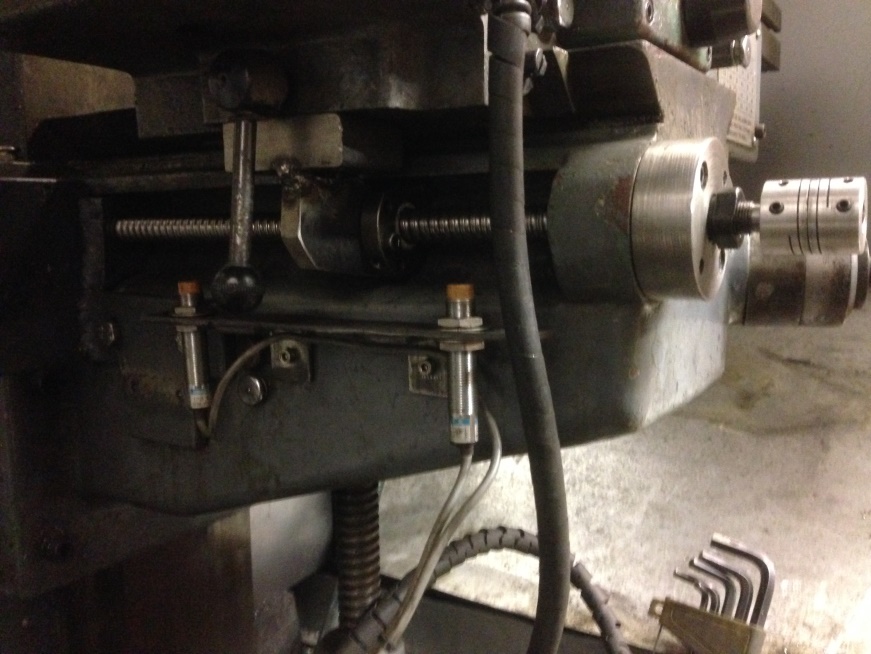

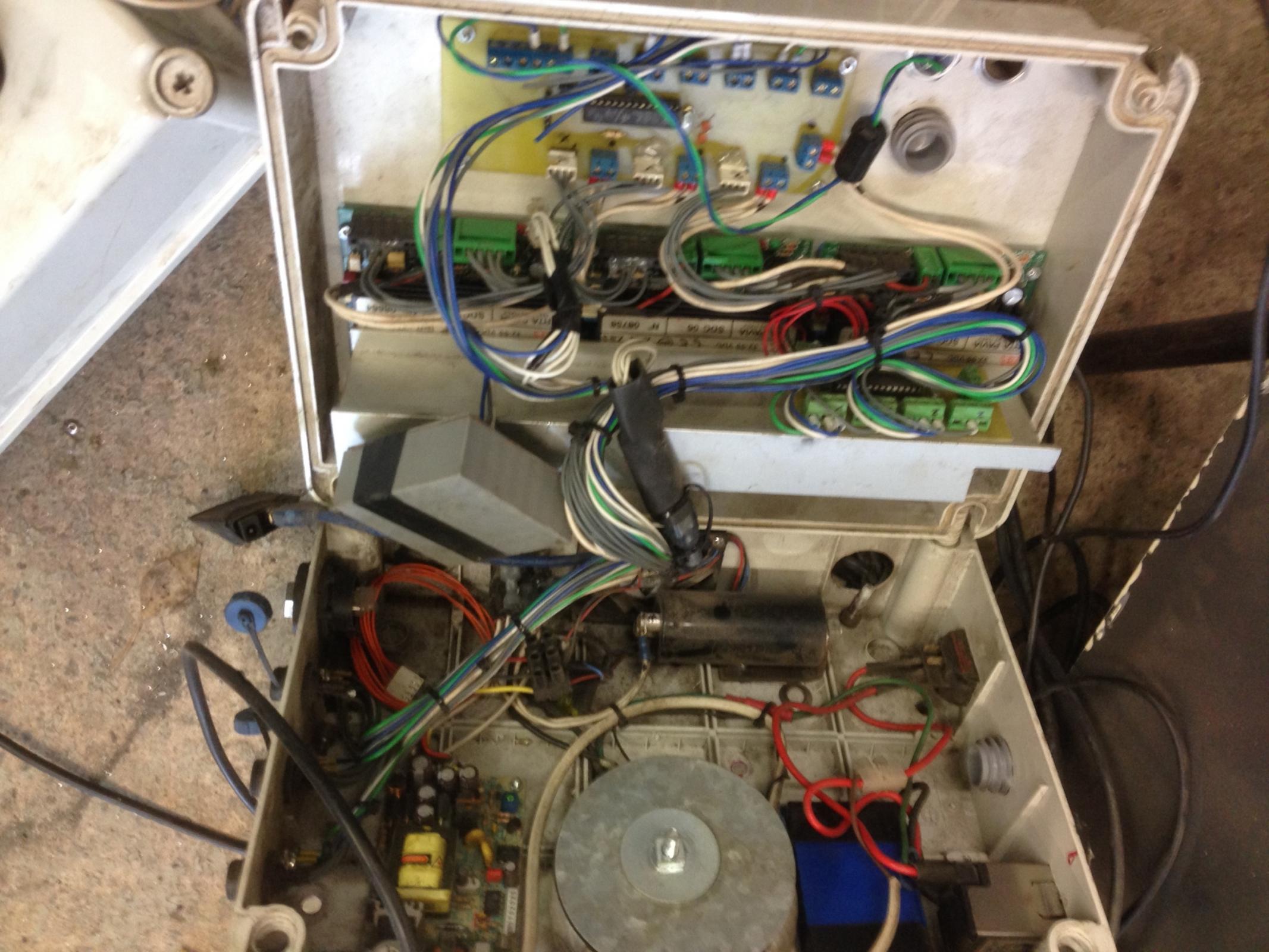

    This was the GRBL controller; you can now see why going down the road of rebuilding the machine became necessary

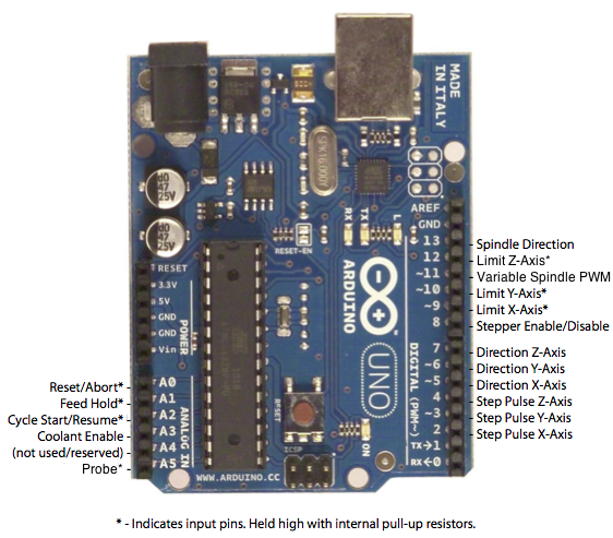

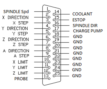

    GRBL (actually the firmware) ran on an Arduino Uno. The hardware interface was/is relatively simple and straight forward, the Arduino uno pins are 5v tolerant and easily connect to Stepper drivers. The limit pins are connected to micro switches, the only big issue is the Spindle it required a little bit of signal conditioning and pcb building to get the pwm output for speed to a 0-10v signal for the variable frequency drive (VFD). It turned out the drive was particularly noisy signal wise so the spindle data was carried over a plastic fibre optic. Its not as if technology has all the answers, the fibre could only transmit data at a max baud rate of 2400. Where the Arduino was at 115200 baud.
    The basic layout of the Arduino based cnc controller

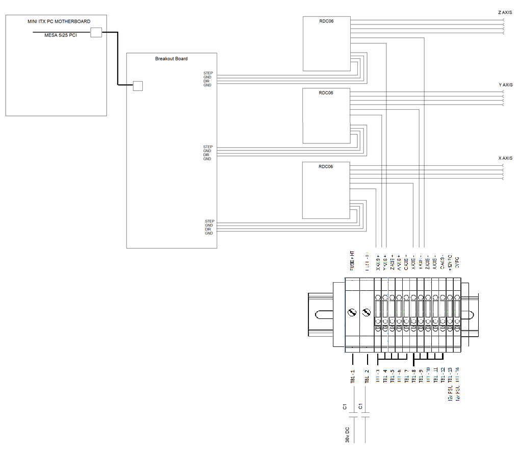

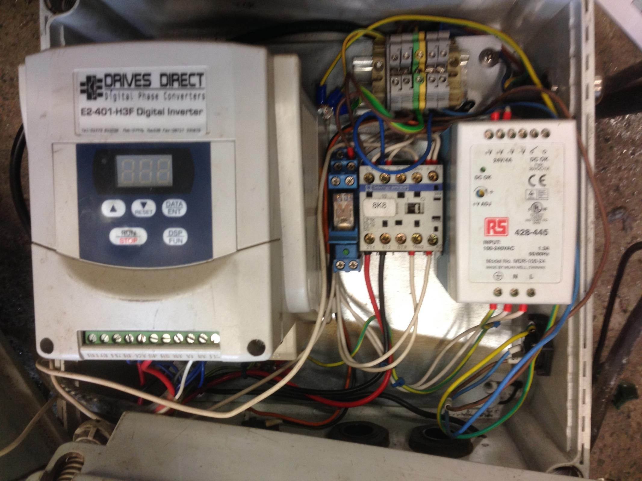

    The control/software was still hindering, my views of linuxcnc ive already covered. I chose to go down the pathpilot clone route. It wasn’t a simple decision to make; it was a toss-up between buying a second hand machine or the upgrade. The second-hand machine is still on the cards but the upgrade was already a financial commitment.
    Researching the Tormach hardware and interfacing, I came across details of the Mesa interface card they use, oddly enough its wiring connection looked quite similar to the one above, in fact it’s identical. It wouldn’t have been to hard to simply swap the GRBL board for the mesa interface wiring. I wanted to upgrade the stepper motors from 2Nm nema 23s to 4Nm nema 23s, the transformer needed to be upgraded to supply a higher current and voltage output.

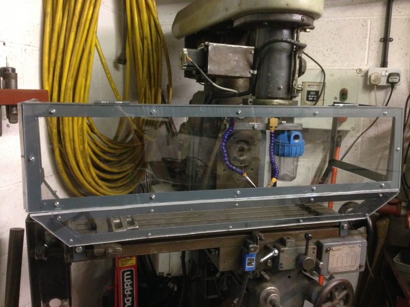

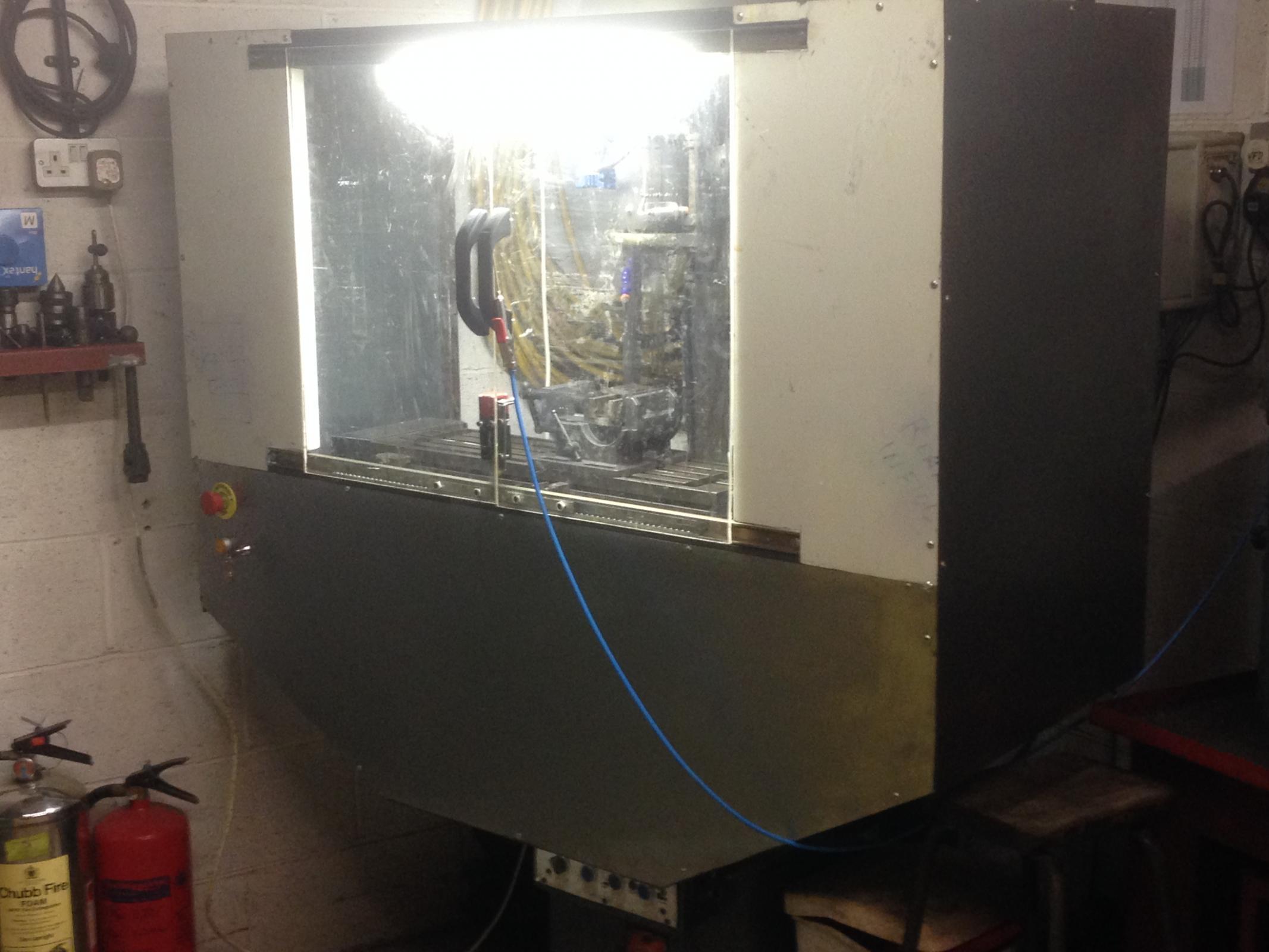

    Improving the machine and planning to use it with much greater anger means a proper coolant system was required (bye bye Fog buster) ok perhaps I could adopt both. The enclosure was built for the best practice and health and safety practicality, na - just keep the coolant inside. My apprentice and I decided that we should send a picture to Haas and beg/plead for a VF1 sticker for it, now I have to ask Tormach as I owe them a debt of gratitude.
