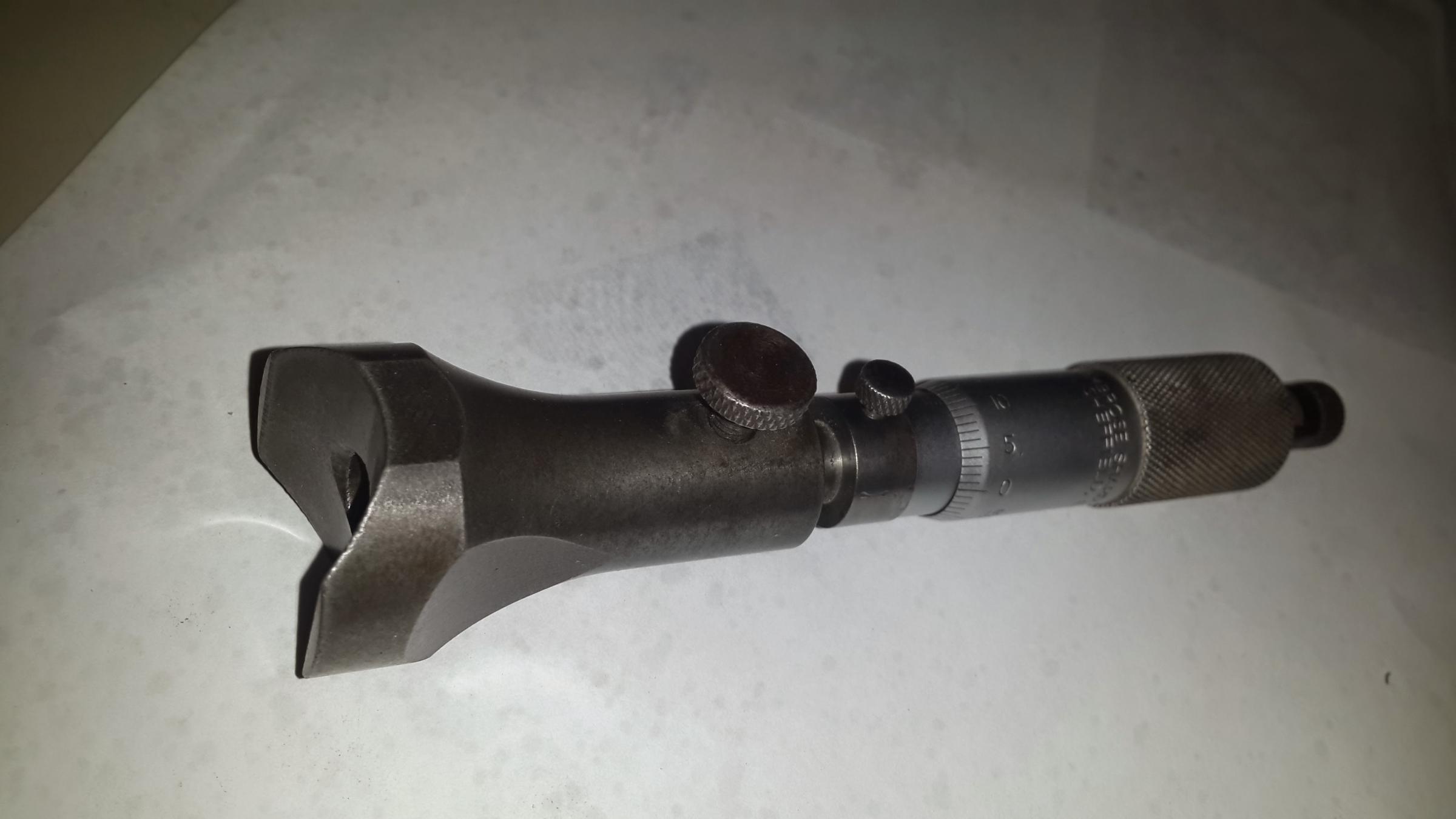

    Not sure that this is the right place to post this, my apologies in advance if I got it wrong.
    I have this micrometer which was part of my dad's tools when he died, it must be at least 80 years old and I have no clue what it would be used for.
    It was manufactured by Ambrose Shardlow in Sheffield. I have downloaded one of their tool catalogues (company closed many years ago) and can not find it, also done Google searches and spoken to many machinists with no joy.
    The company also manufactured aircraft engine parts during WW2.
    Hoping that some of our erudite members will know what it is for.

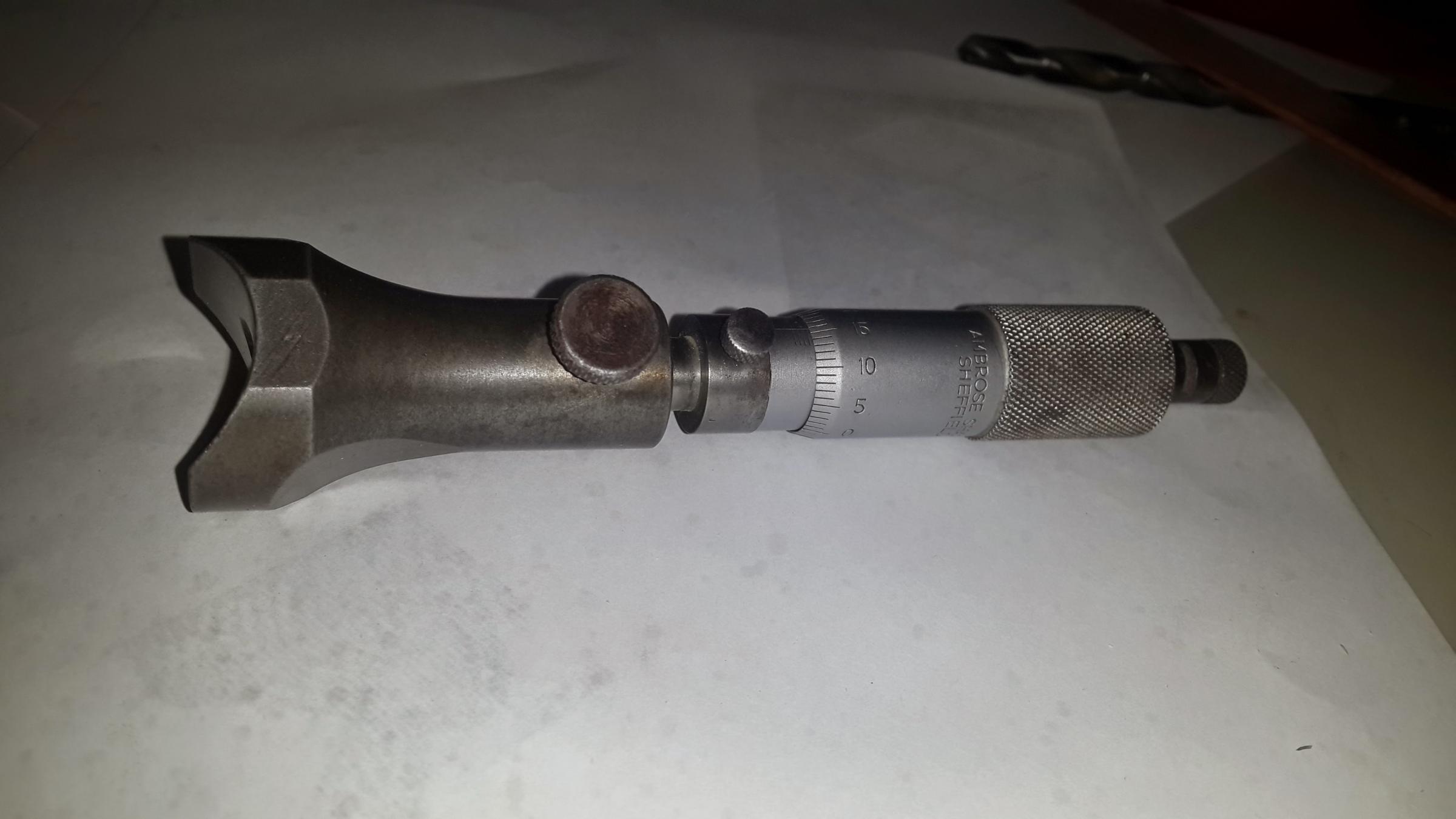

    Attached Thumbnails Attached Thumbnails Unknown micrometer-20150321_184537.jpg

    I can offer two guesses...
    Used to measure projection of some feature from the curved surface of a structure
    or
    The radius of curvature can be calculated from the height (sagitta) of an arc above a known chord; see...
    How to solve circular segments
    Purely guesses. I've never seen or used one as shown in the photo.

    Thanks Marv, I had similar guesses and wondered if it was more of an in-house unit to Ambrose Shardlow for measurement on crankshaft journals.

    I have never seen one like that either, but I would second the thought that is was some custom measuring tool used for a some task very specific to the place that your dad worked.
    There was an old gent around here that had a small used tool shop as his sort of semi-retirement job. He previously had been an instrument maker that sold and repaired measuring tools. He told me that at one time a pretty significant part of his business was making custom measuring tools for the GE jet engine plant in Lynn Massachusetts when they were in their heyday. He had some pictures of various fixtures and jigs he had made for them, some of them quite complex and interesting. Most of that business went away when CMM's and the like came into play. Great old guy, full of stories. I miss him.

    A key-way or recess depth measuring tool for a specific diameter shaft? Looking at the size of knurled knob on the attachment it would appear to have been made interchangeable, rather than a single purpose made tool.
    A late thought! A specific boring bar tool setter. I knew I had seen one before! :-)

    If you zero the micrometer, where does the anvil sit on the hole? Is the knurled screw (large one) to adjust the height of that adapter piece that is of the working end? How about that small knurled screw, does that allow the reading line to move? I probably am using the wrong nomenclature to describe the parts of a micrometer.

    Marv and metric_taper have good justifications, especially what position the spindle tip is from the radius at zero. My question is the tip itself, is it flat (conventional), reduced diameter, or pointed?
    Another detail about the clamp-screws; appear to allow zero anywhere. That makes possibility recording difference (instead direct measurement), compared to a standard; or vice-versa of course.
    No doubt micrometer head is Shardlow, but foot was generated as specific tooling, in manner described post 4 by clavius. If was commercial, high likelihood to be finished satin chrome as the thimble and body.
    Next page post 13 Tonyg reports
    "Hi ,
    The tip is flat and it does allow it to zero anywhere."
    Quite conclusive factor there; it's a comparative instrument, not absolute. Could set any kind of plunger etc, if maintaining linear axis to it.

    As a guess I would say it was used to measure the depth of key ways or splines on a given production part as the shaft size would have to constant looking at the base of the mic,depending on the shape of the anvil tip. Interesting

    I recon your right on the money as a boring bar depth setting tool,the only trouble is you would have to read it from the back of the bar due to the constant radius
