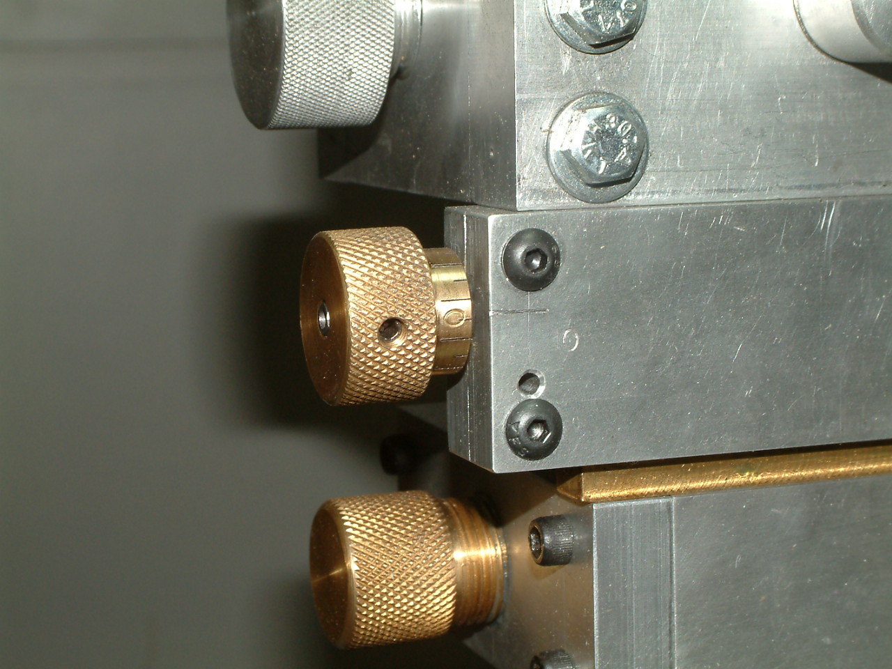

    Thanks PJ,
    The F4 is indeed RC. It sports a 90mm EDF and is powered by a 6S 5000mah battery. I built that one from scratch using parts made with my CNC Router. My son got me back into RC in about 2006. Funny thing is I am still flying them and he is a bit busy with life at this time but I am sure he will be back to the hobby.
    I added an engraved knob to my fine feed assembly. It worked out nice since 10 rotations moved the wedge exactly .100". The knob has .001 major graduations and .0005 sub divisions so it is plenty fine for the machine.
    Cheers, JR

    Fine Feed Graduated Knob for the Universal Grinder
    I added graduations for my fine feed adjuster knob. The long lines are .001" vertical movement and the short lines will move the grinder by .0005". Works good for what I need right now. I still need to work on overall accuracy and I would like to improve the finish of the grind.
    Cheers, JR

    Looks Real good JR...should be close enough for sure. Nice knurls too.
