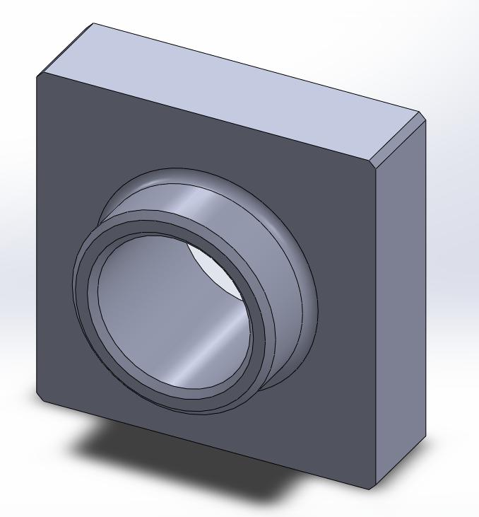

    So, I do have some machining experience so I thought they first order of buisiness is to make some T nuts once the milling part of my Unimat shows up. I have not decided if I am going to make them in billet AL or out of steel. The machine is rather small so there is not a whole lot of pressure on the the T nuts. I may have them type 1 hard ano'd if I do them in aluminum. Out of steel, do I really need them heat treated? Probably not and would probably just send them out for black oxiding to control rust. The through hole will actually be tapped 6mm x 1.0. I just chose not to model the threads but they are on the print at least. I'll know for certain how they work out once I make the first batch of them before putting up the print however. And just in case anyone asks, (because many do lol) I used Solidworks to model the part.

    Aluminum T-nuts don't sound like a good idea. Don't thread them all the way through. It's too easy to forget and they become jacks to break the T-slots.
    Actually alum. works well in this area, I have a set made from 6160? (been years) and if you run the bolt through it will jack the threads out before breaking the T-slots. Just ask my son how this was found out!
    I have been using them for years and have found them to be very serviceable.
    I'm with Marv on both counts, both material and not screwing all the way through, although it would take a heavy hand or weak bed to break the T-slots.

    Quote Originally Posted by Al8236 View Post
    I'm very sure that, in the event of a crash, I don't want the clamps holding the part to have the ability to rip themselves loose from the T-nuts.

    Hi
    For convenience, it is easier to thread all the way through. After threading "pinch" the last thread or two using a centre punch or similar. The commercial T-nuts are usually manufactured this way. T-nuts should always be used with a nut and stud not with a bolt into the t-nut. Also keep in mind the location of the T-nut. Wherever possible the T-nut should be under or as close as it can be to the item being clamped. Such positioning will minimise stress on the machine's T-slots.
