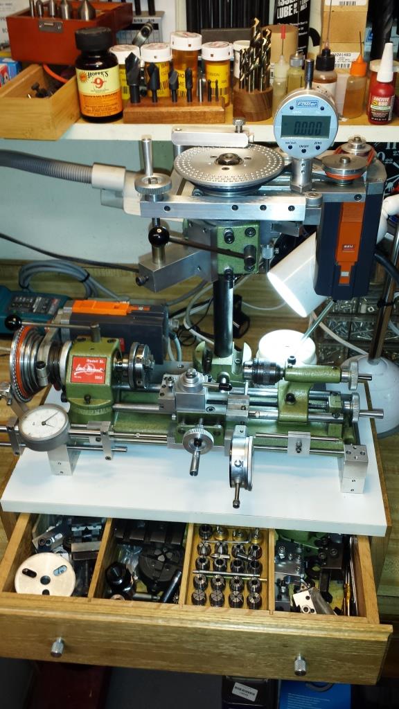

    Unimat Lathe Cabinet for Storing Tooling and Supporting the Lathe and Milling Machine
    A couple years ago I built a small cabinet for my old Unimat SL lathe and added a separate vertical column for the milling/drilling head. The cabinet has only one drawer with four separate compartments, and one of the compartments has two layers. The cabinet sides, drawer, and drawer front are made from ¾” red oak and finished with clear satin polyurethane. The top and bottom are made from ¾” Melamine particleboard laminated with a thermally fused resin coating to provide a durable and oil-proof hard surface. I made the knurled knobs from ½” aluminum rod.
    The cabinet sits on four rubber feet whereby the combined weight of the lathe and tooling stored in the drawer provides enough weight to keep the lathe from moving on the workbench. The cabinet top has threaded brass inserts for holding the milling column base to a 1”x3”x12” aluminum bar using cap head screws. The lathe sits on two 1”x1”x6” aluminum riser blocks that are held in place with flathead machine screws inserted from underside of the top sheet of melamine and secured with washers and brass nuts. The two sides and back of the cabinet contain 10-32 threaded inserts I made for cap screws to hold optional Lexan splash shields when fly cutting with the milling head.

    Saw this on a Homemade Tools e-mail today and it is really neat.
    I also have a Unimat DB-200, the original CI model which I am presently restoring with a new paint job. I have a full steel bench dedicated to it. But I may copy some of your other ideas that I see in the photos. I long planned to add a caliper and DI for DRO capability so I am studying your photos carefully. I also would like to add a permanent vertical column but I think I would use a metal base plate, probably aluminum, to tie it to the Unimat. I don't see why you have to use an actual Unimat column as any 25mm diameter rod would work.

    For the benefit of future readers...
    The only improvement I might suggest is a piece of 1/8" steel plate under the Unimat. That would allow one to use all sorts of magnetic bases to hold measuring tools, lubrication feeds, lights, microscopes etc.. DAMHIKT. I have a Unimat too and had to add the steel plate as an afterthought.
