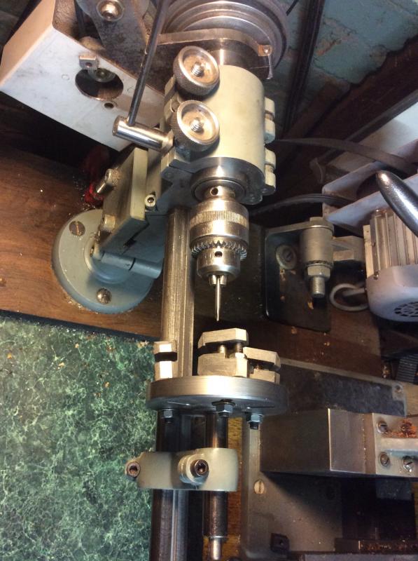

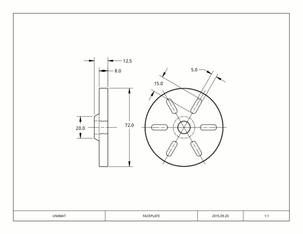

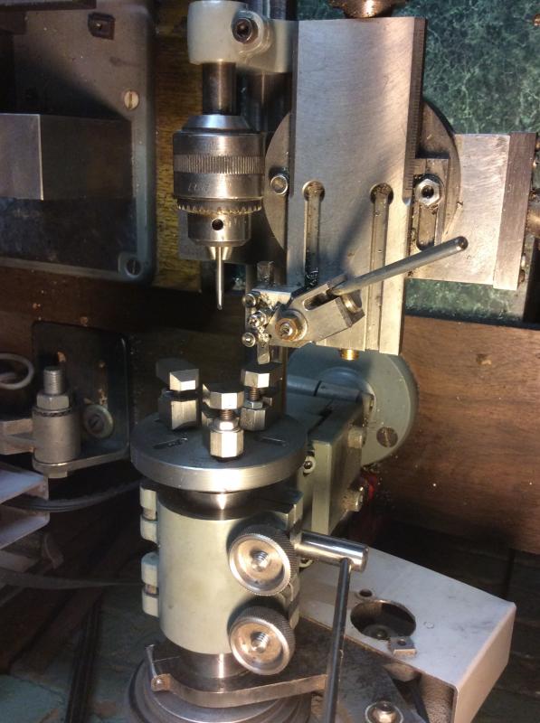

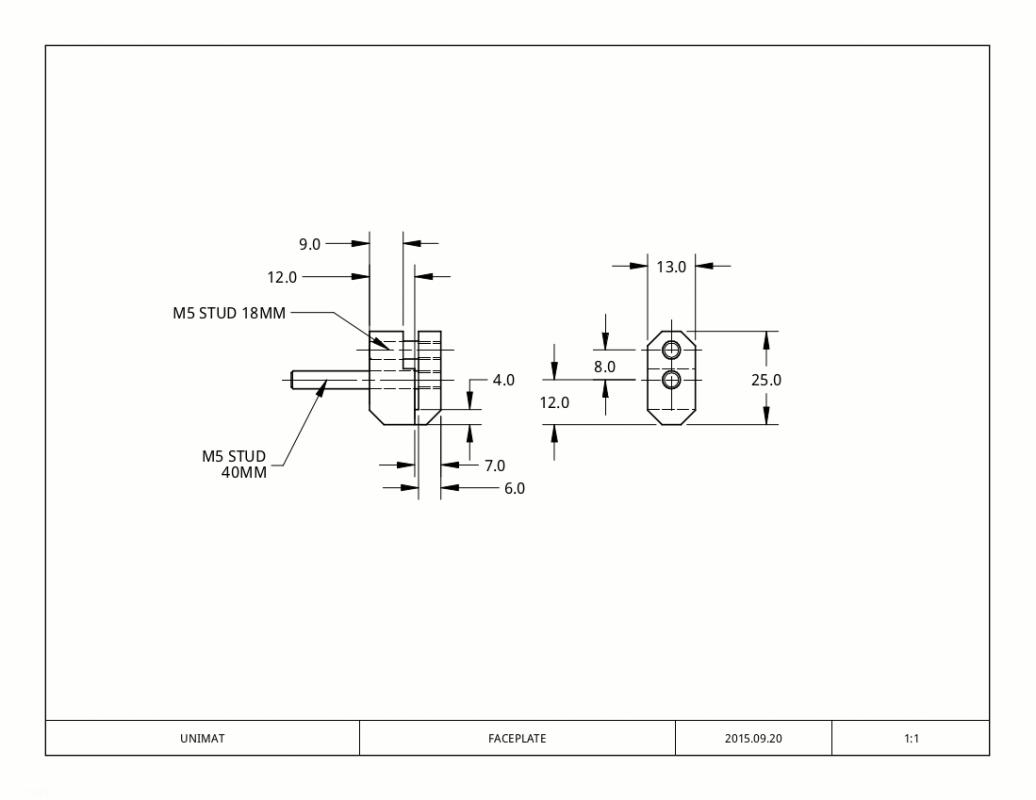

    Here is a faceplate I made from scrap steel a few years ago.
    It’s about 3” diameter and is threaded M12-1.0 so it can screw onto either the headstock or tailstock of an old Unimat, or anything else with the same thread.
    The clamps hold relatively thin work off the faceplate surface. They’re a little fiddly to use.
    Unimat faceplate-7691af19-c74f-4b5b-ae47-59382ec5bc4f.jpgUnimat faceplate-7595cd70-eaa4-423b-9f2e-56f00eedab3a.jpg

    A little fiddly is not so bad, if they are secure. Small machines x small parts = higher RPMS.

    Lokks nice, very well executed

    You’re right, and those unused slots could be used for more clamps for extra holding power, or screw dogs for finer fiddling.
    A traditional one would probably be run at more reasonable speeds than my Unimat:

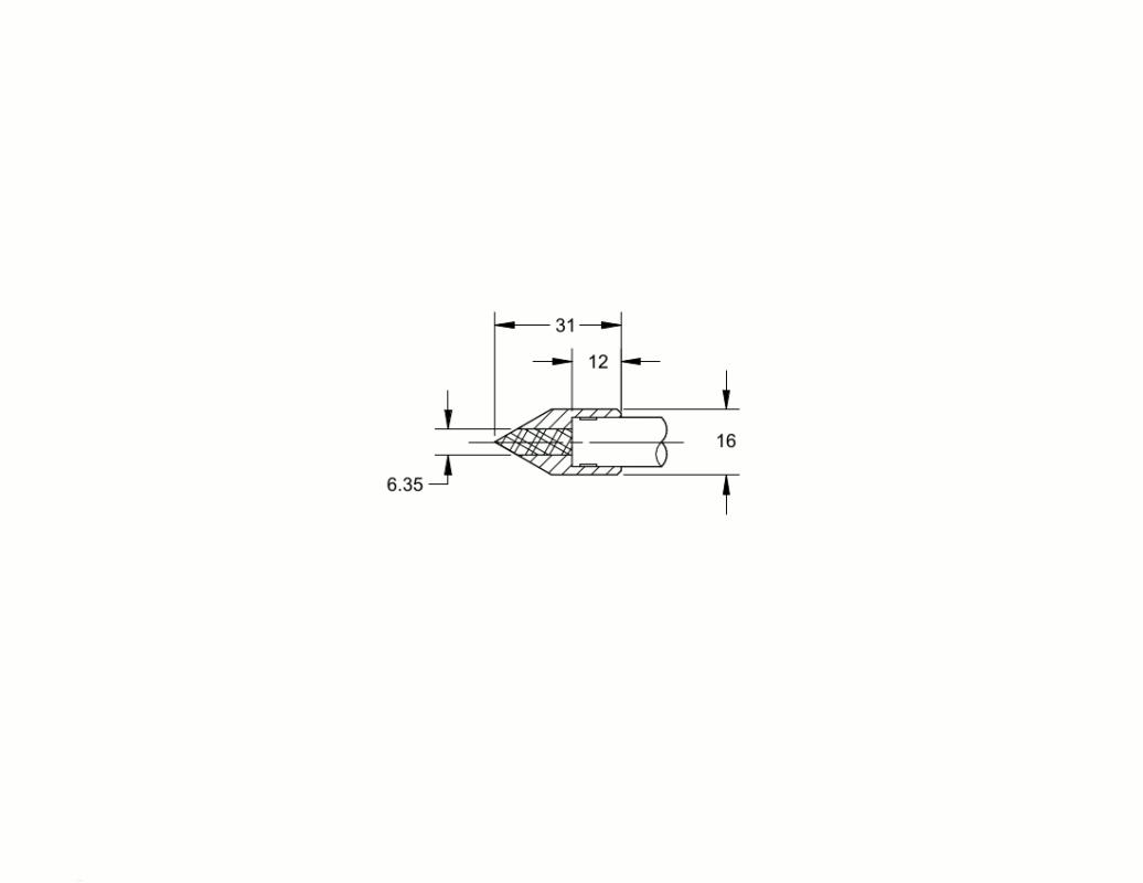

    That is a useful faceplate. I like you lathe adaptation using an old Unimat spindle. What is the distance between lathe centers?
    Thanks, Paul - Your faceplate looks more versatile!
    I think that lathe can fit five or six inches depending on what centers so maybe a bit less than the Unimat.

    Thanks for faceplate comment. Unfortunately, my faceplate is also a little fiddly to use. For many of my setups, it is easier to start with the faceplate sitting horizontally on the workbench, lightly snug the clamps down and then mount the faceplate back on the lathe and then make the final small adjustments using a soft-faced or brass hammer to tap into final position.
    The 3" swing Unimat lathe has the homemade faceplate weighing only a few ounces and so it is much easier to do the removing the faceplate to the workbench and then remounting the faceplate on the lathe. My heavier cam-lock faceplate for my my 12" swing lathe is harder to do with this technique but it works on the bigger lathe.

    Loading it horizontally is a much better strategy than what I’ve been doing and the slots and off center clamps only make it worse.
    Coil springs around the main screw between the top and bottom part my clamps would help a lot but I don’t think I left enough room. They’re so light maybe hot melt glue or putty would hold them long enough to get the work in place.
