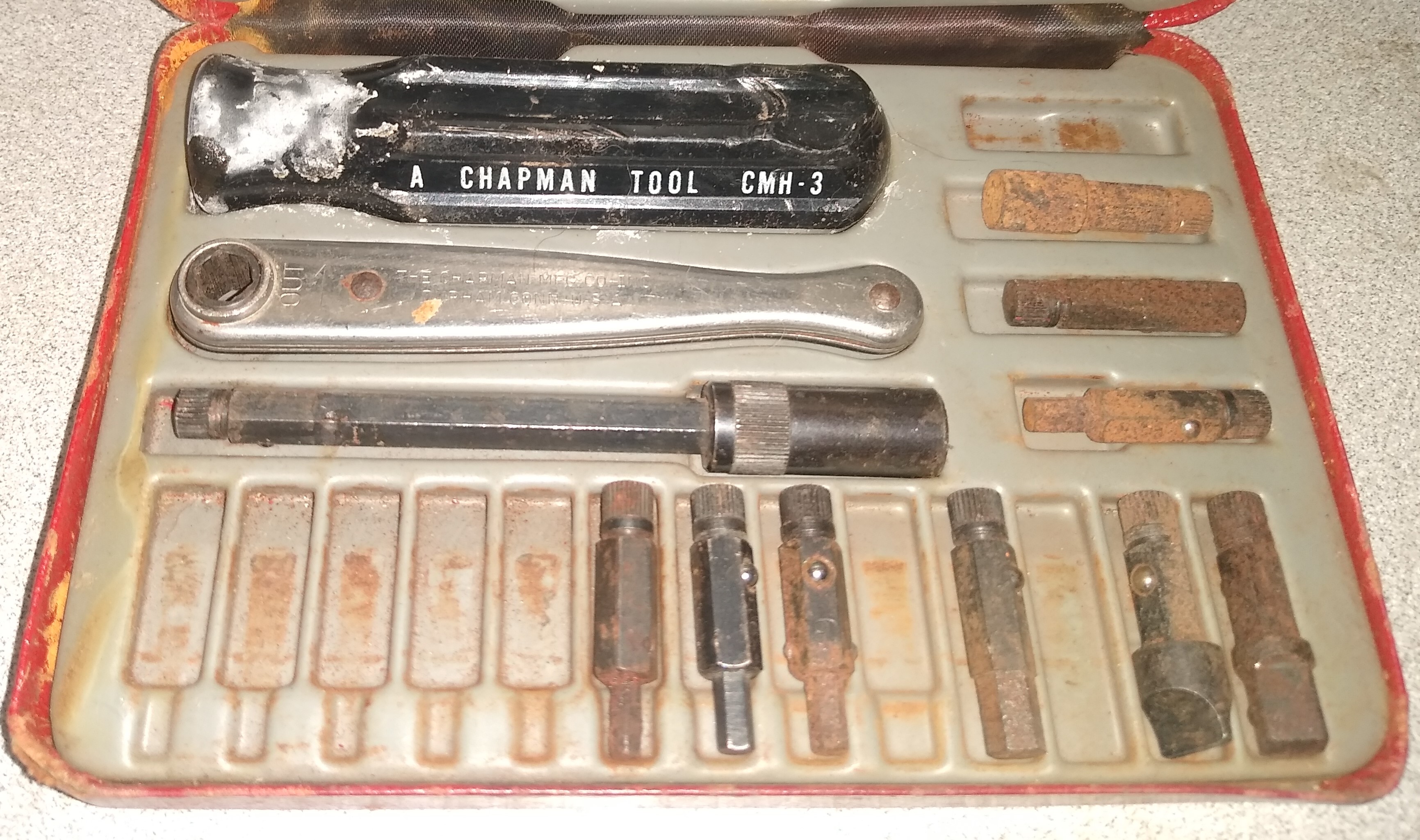

    Have you ever run into Chapman Tools? https://chapmanmfg.com/ They're not quite as low-profile as those you show, but they have a great variety of points, ratcheting handles, and they have a ball stop to keep them from popping out of the toolholder. My dad gave me my first set about 50 years ago. Some time in the past 30 years it spent some time in a box full of water, and they're damaged, but still usable. Sometime this year I hope to buy a new full Master Set, since I now have a safe place to keep them. They are not cheap, but worth every dime!

    The Chapman sets are beloved of gunsmiths since they contain a generous selection of properly ground slotted screw bits of width to fill the slot and prevent cam outs. Although not a gunsmith I've had a set for decades and they deliver that perfect soupçon of satisfaction every time I use them.
    That said, there are times when the length of the bits makes it difficult to get into tight spaces. That's why I was delighted to stumble upon this set...
    https://www.amazon.com/gp/product/B0...e?ie=UTF8&th=1
    The individual bits are about half as long as the Chapman bits. The bit+wrench thickness is about 0.6" as versus the 1.16" of the Chapman bit+wrench. Also, the wrench ratchet can be reversed via a toggle as opposed to the Chapman where the bit must be removed and installed the other way round.
    Overall, a bargain at $18; highly recommended.
