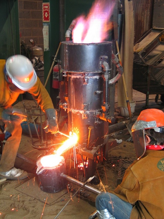

    Alot of colleges do offer Foundry Technology coarse's, alot more Stateside than up here. Here's a picture of a foundry set-up at a Stateside college, can't remember which. Thats a mini cupola melting iron. Someone did a nice job of building that, thats preheated blast air they are using (the piping going down the side). I have played with some ideas to build one but have never had the time or need to follow through with them.

    Carlos

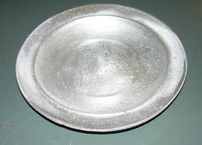

    I tried casting aluminum and the casting seems to have a crunchie like finish dont have a pyrometer checked the heat like Dave Gingery did with a metal rod, pattern is good and sand is fine grain like sugar, using a fire extinguisher as a crucible thinking that I might need a different crucible might be getting steel transferred to aluminum melt anythoughts

    Sugar can come in different grain sizes, I use play box sand, it is at least as fine as most sugar types but I still find it a bit to grainy and will be changing it out this summer if I do any casting. Your mix may also need adjusting, more clay, Dave does a nice test, squeeze a handful and it should show good definition and be strong enough not to crumble when you hold it with two fingers.
    Dave recommends 1350*F to 1400*F, I have never poured below 1400*F better a little higher than lower. I have a digital temp. meter that goes to 2200*F.
    Here is the kind of finish that I am achieving with play sand, the saucer was just trimmed of the gate and wire brushed. Not great, I would like to improve on that.
    If the extinguisher was cleaned well before use and not showing scale rust that would contaminate the melt it should be ok. I have read of others using former extinguishers.
