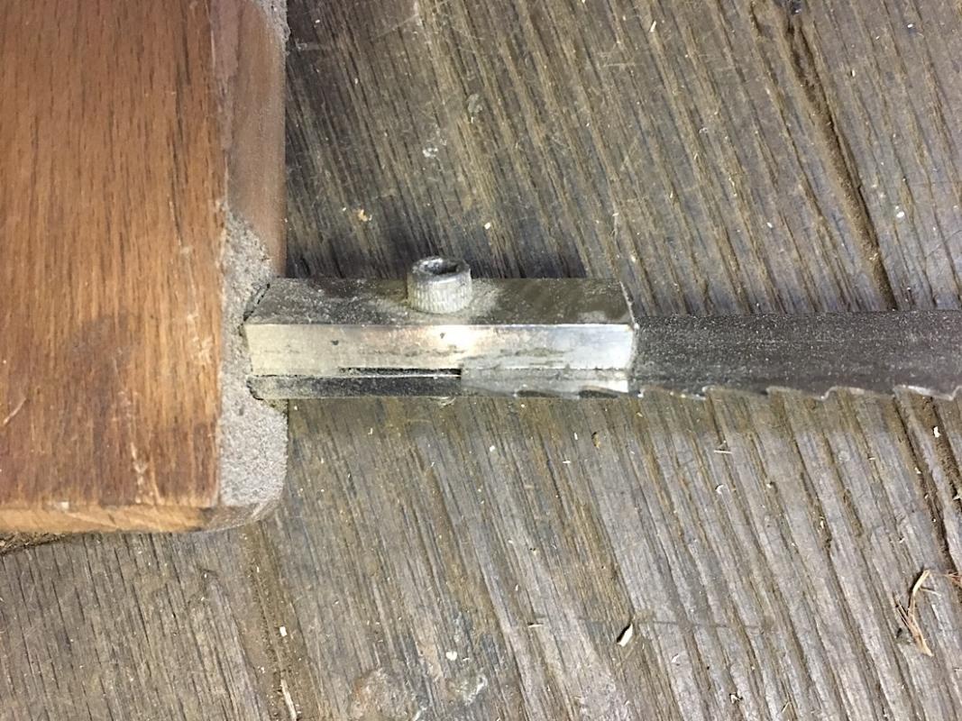

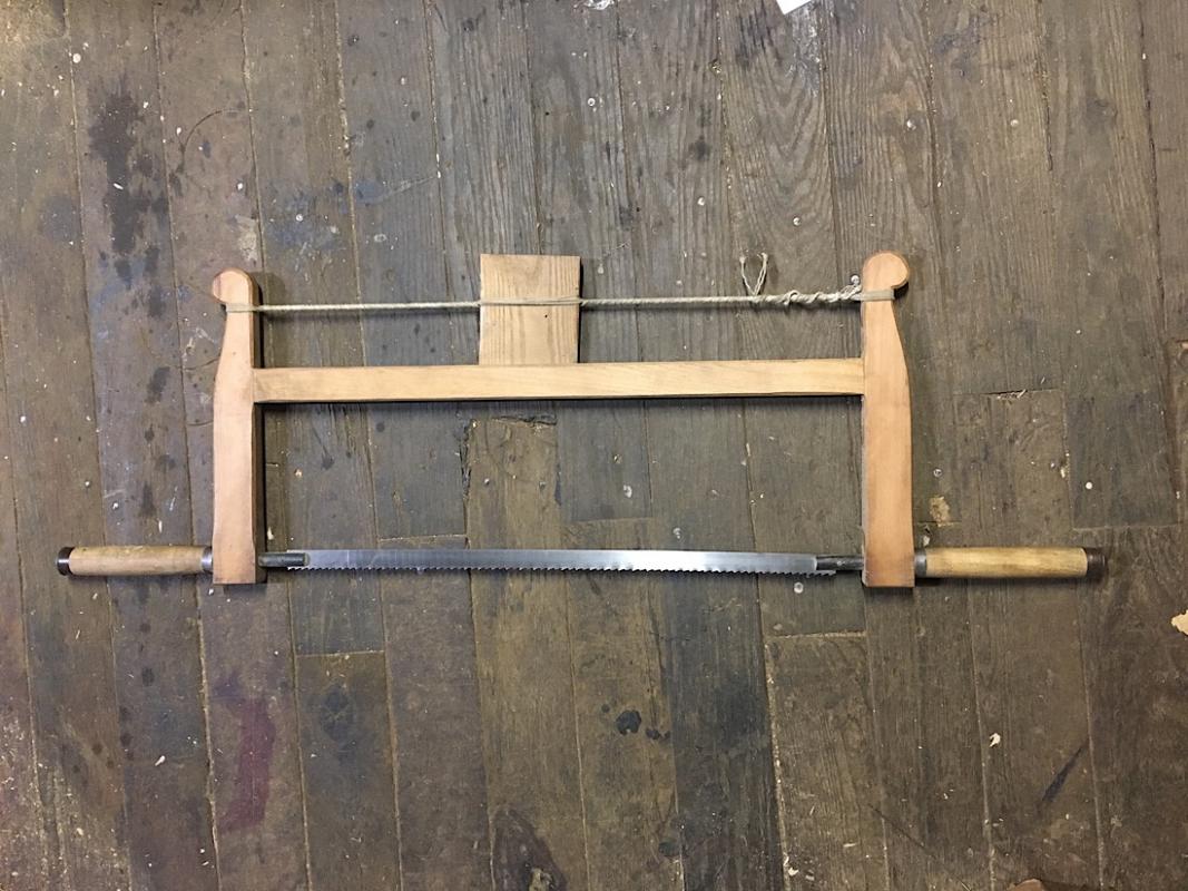

    This is a saw frame I made in order to take advantage of broken bandsaw blades.
    The blade clamps copy from small jewelers saws, with flat seats milled about halfway through the ends of long 1/2” carriage bolts that go through the handles. The 8-32 allen screws that tighten the clamps seem small but they hold great.
    Turning saw-87ce6b1e-0bcb-41aa-996a-acf7fbbfdbf8.jpg Turning saw-21e60c60-4f9f-472f-bb87-c9e1dcc26ecb.jpg

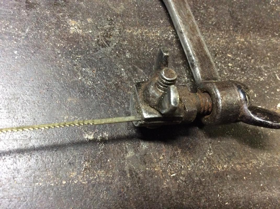

    Jewelers saw clamp:

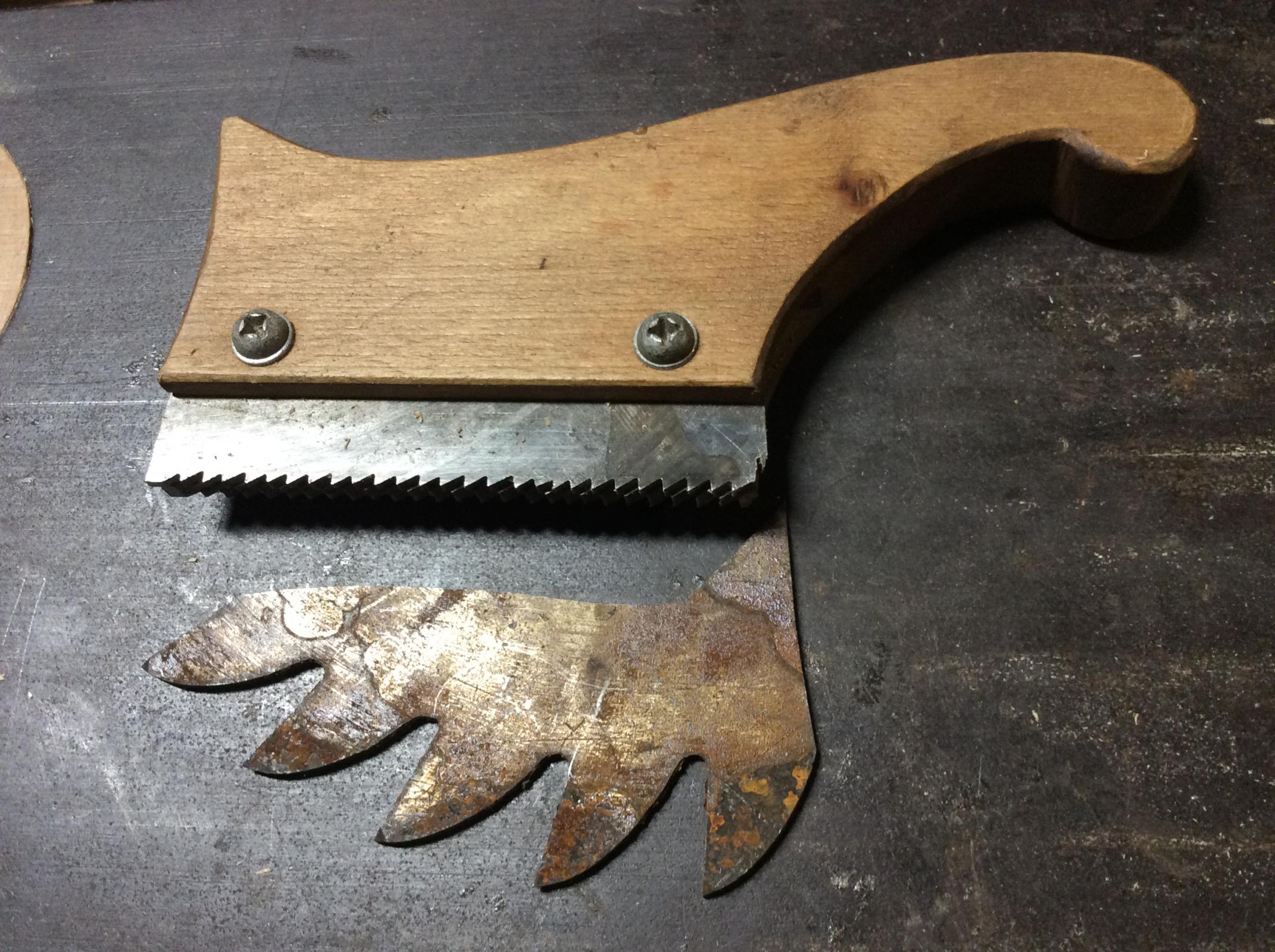

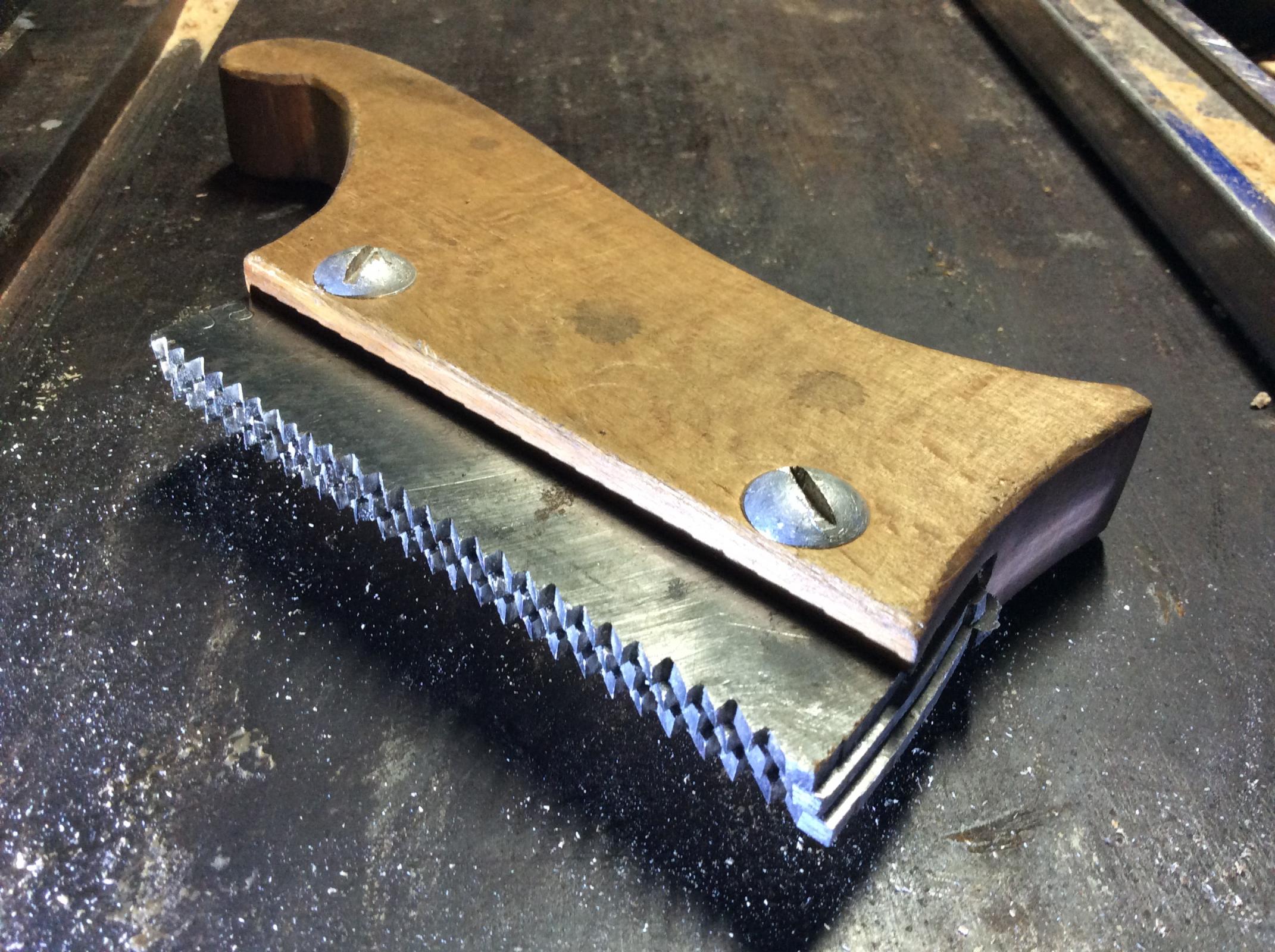

    This is kind of a cross between a rabbet plane, dovetail saw, sur-form and a “centipede plane”, using cut up discarded old carbon steel circular saw blades.
    Turning saw-4defb521-b5b5-45a4-b3d0-8ca46497e2e9.jpg Turning saw-924f6d41-5286-44ab-b505-80d05abd4c63.jpg

    That's a neat design. Looks like it might be difficult to get it started in a straight line though...how well does it work in practice?

    Thanks, bruce.desertrat,
    I couldn’t think of a very accurate name to call it here, 0.330” is a kind of odd width, but it works pretty well for making dados just using a straight edge since there’s no set on the teeth.
    I use it a lot for roughing things to reference depths, like for hand planing or carving. It’s more aggressive and controllable than a rasp or plane. The land at the front end helps to prevent over feeding, and staggering the teeth helps control chattering and tearing out.

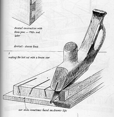

    I couldn’t find this yesterday, it’s from Aldren Watson’s “Country Furniture” - I shaped my handle like a carriagemakers plane mostly to use a smaller piece of wood.
