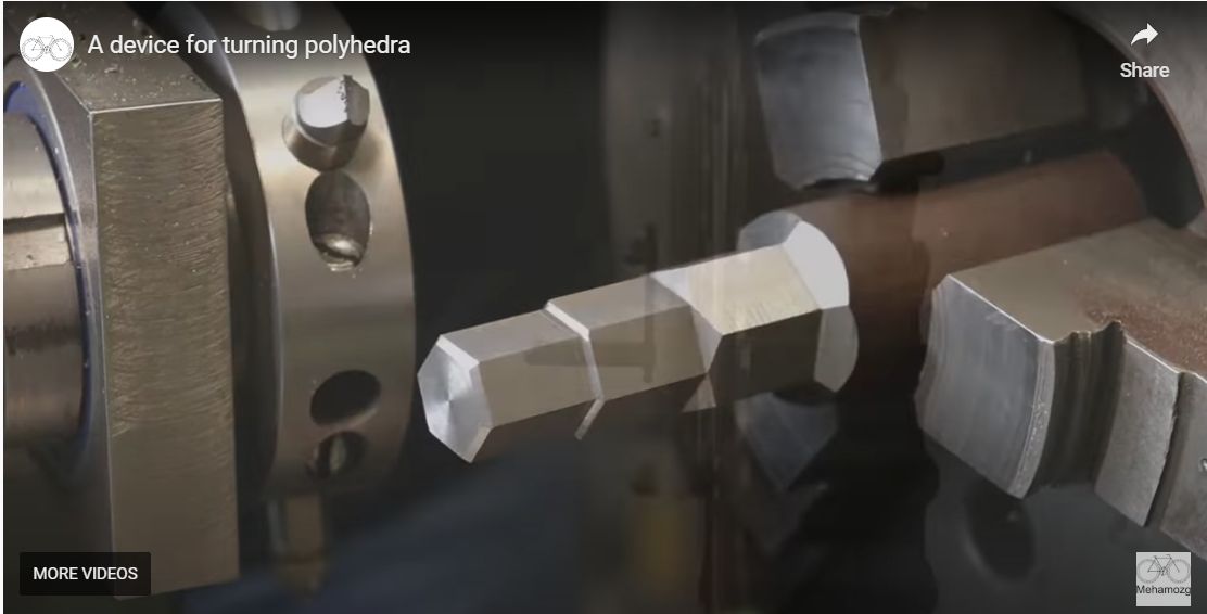

    Jon recently posted a video ( Polygonal turning tool - video ) showing the method of turning polygons, multi-sided shapes, on a lathe using a rotating cutter. This was new to me but a quick internet search showed that it was a well known technique applicable for home hobbyists with limited facilities, as the video shows, as well as commercial users and is even used on CNC lathes. Even with CNC it is faster than some other methods such as indexed milling. metric-taper added to Jon's post with another homemade effort, albeit more complex. Here is a sample image of that

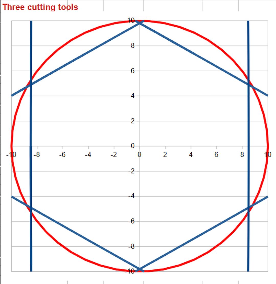

    On the left is a hexagon formed with a gear ratio of 2 and 3 cutters on the cutting shaft. Workpiece and cutters rotating in the same direction.

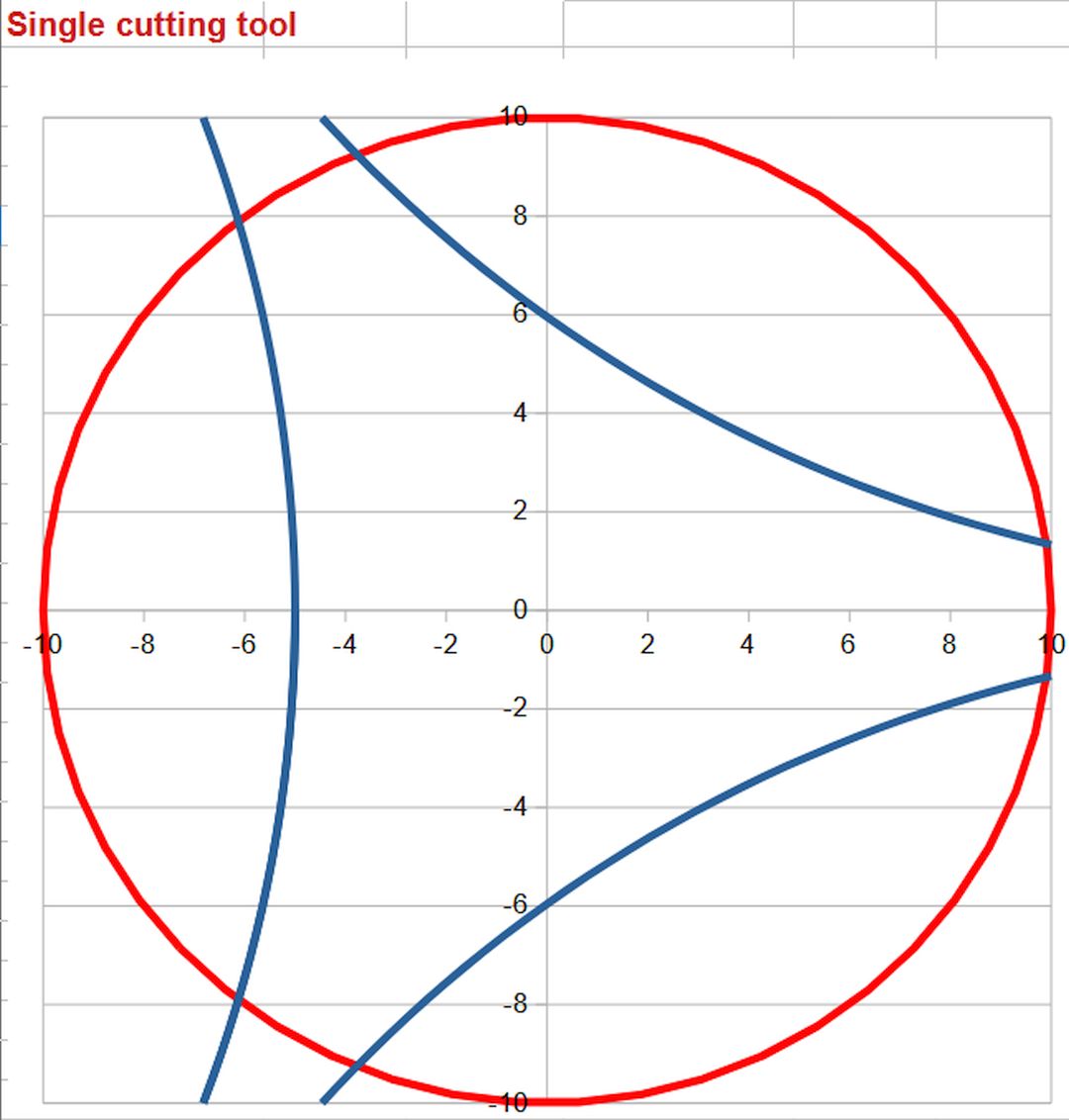

    On the right we see a gear ratio of 3, 1 cutter and opposite sense rotation.

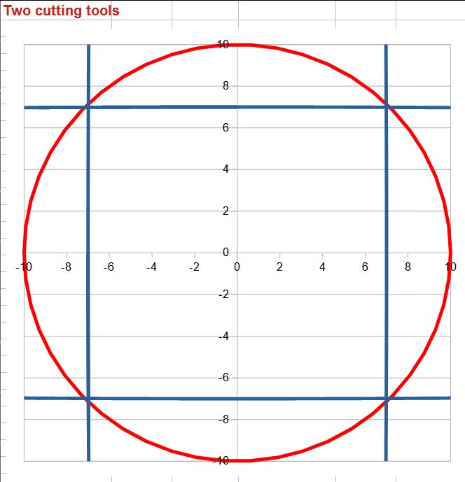

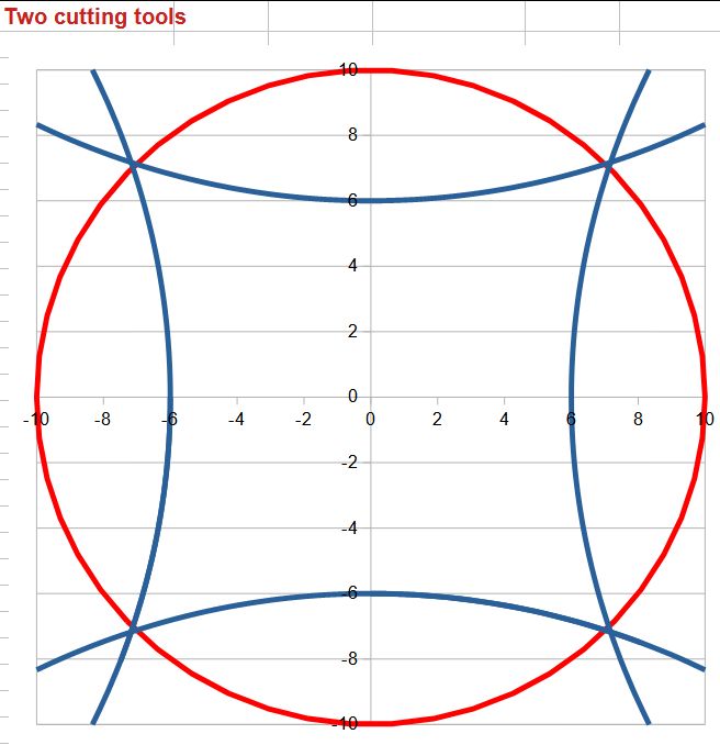

    Both of these 4 sided shapes are cut with a 2:1 gear ratio with 2 cutters, the only difference is the sense of the rotation, same sense on the left and opposite sense on the right.

    Of course we need the obligatory video, just 50 seconds of Youtube shorts, this shows a slow animated simulation which clearly demonstrates the interactions between the cutting edges and the workpiece, resulting in a near straight surface. The parameters of the simulation were a gear ratio of 2:1, the cutter radius was double the workpiece radius, rotation was same sense and one cutting edge. In reality this would cut a two sided figure but the simulation is limited to one.
