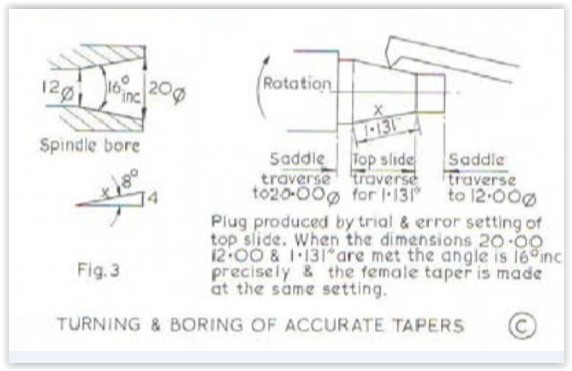

    Hi Rick, now I know what you are aiming for I only know two ways of doing that, One of the most difficult things to measure is the large end of an internal taper. I either make a gauge like this.
    Turning Matching External/Internal Tapers-tapers.jpg
    Or turn a short register on the front of the bore which can then be removed. I would be interested in an updated method from Joe Pie, maybe he would respond to a request.
