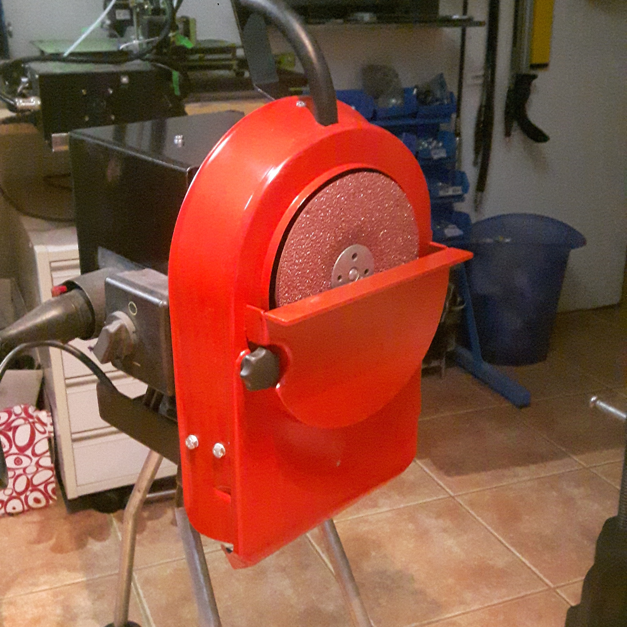

    Turning crappy wood shredder to powerfull grinder / sander
    Bought used wood shredder couple years ago.
    Paid 30€ from it... after little use, i noticed
    That this kind of cutting shredder ain't very usefull, specially with fresh wood, that i wanted to shred.
    It was too slow in use, and got stucked too easily.
    Stored it, and now i found better use for it.
    It has 2000w motor and it runs 4000rpm.
    That makes it pretty good grinder.
    Turning crappy wood shredder to powerfull grinder / sander-img_20181009_084720_324.jpg
    Axle was originally with M22 thread.
    Shaped it to M14. So that i could use it with angle grinder wheels.
    More info can be found from this "work in progress thread"
    http://www.homemadetools.net/forum/w...c-sander-69724

    Thanks buddy. I made this without rush.. so i hope i don't need to update this one afterwards. Still, i got couple things that i could add it..
    One is. I made four mounting screws to the bottom of the stand / cord tray... those allows me to mount it to another stand.
    Then i could use it as a lathe..
