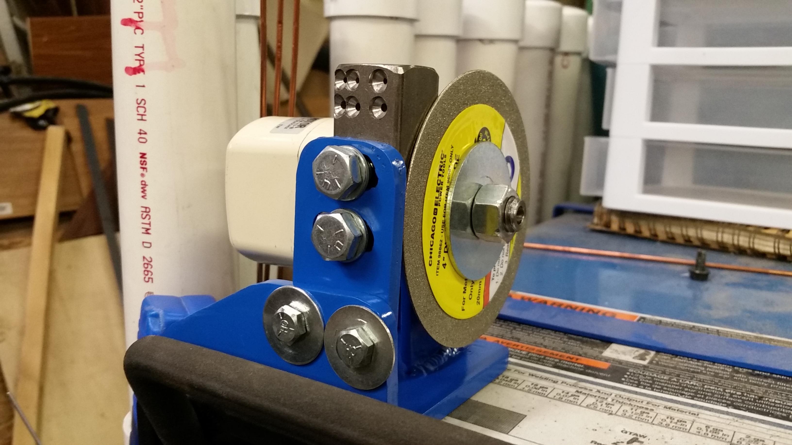

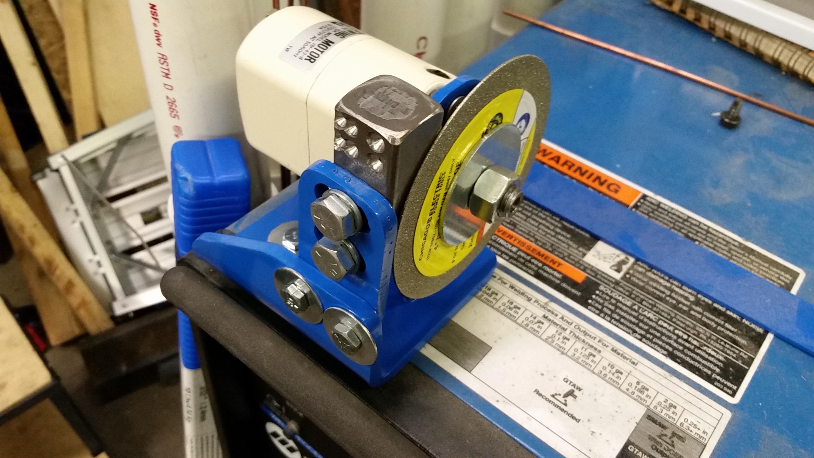

    Made from a re-purposed Sewing machine motor. Machined a 1" thick block with the correct angle for Tungsten tapered point, for both 1/16" and 3/32" Tungsten. Using a HF Diamond wheel.
    Works Awesome!Tungsten Grinder-20151125_135451.jpgTungsten Grinder-20151125_135518.jpg

    May we see it in action and maybe how it was made?

    @pennswoodsed, I'll see what I can do.
