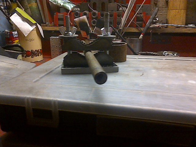

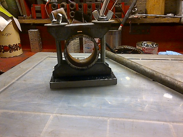

    below is a tube holding jig i made for bandsaw.
    its made from offcut of 10mm plate left over from another project 2 antenna clamps, and some m8 studding.
    first off i marked position of mounting holes in brackets onto the plate.
    then i drilled and tapped plate m8.
    then i bolted lower bracket down to plate.
    for smaller tubing i use flat side of upper bracket for bigger sizes i flip it over.
    can do 10mm to 40mm tubing on it only limited by length of studs i used.
