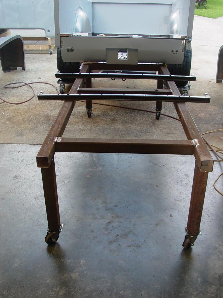

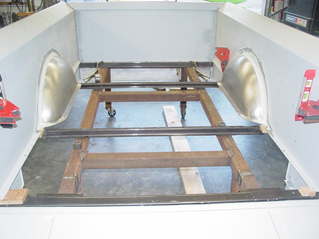

    need something to use to mock up bed on a '53 f-100 and lay out bedwood... built a rolling frame from 3x3 tubing with same dimensions as actual frame.... easy to work around and substantial enough to keep everything square and plumb
