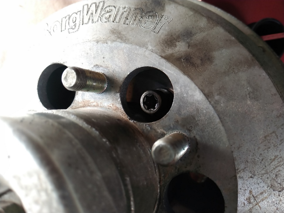

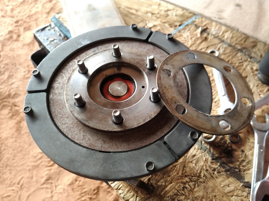

    This is more of a mechanics hack than anything else.
    A lot of times I find myself having to assemble parts with multiple bolts in awkward positions.
    This is particularly true when replacing the air operated fan clutch on a Mack engine and doubly so when you do not remove the radiator.
    The Borg Warner Air operated fan clutch has 6 recessed bolts that holds in on there is also a spacer shim between it and the water pump pulley making it all the more difficult to hold everything and start the bolts which also have split lock washers on them as well.
    It is all too easy to drop a bolt inside of the housing assembly or loose a lock washer off while trying to insert the bolt.
    loosing a washer or dropping a bolt inside especially after having successfully instilling the previous 5, only leaves you with a single course of action,
    Remove it vigorously shake the housing until you can get the bolt or washer in position to remove it with a slender probe magnet or needle nose pliers. You may get lucky though and it falls out.
    Here is a little trick I learned when dealing with an assembly and a handful of bolts to capture them in place.
    Sometimes a spot of grease will suffice but there are times when grease contamination is unacceptable.
    Other times a single rubber band stretched around all of the bolt shanks or a string tied tightly around them will work if you can cut loose the anchorage after the bolts are started.

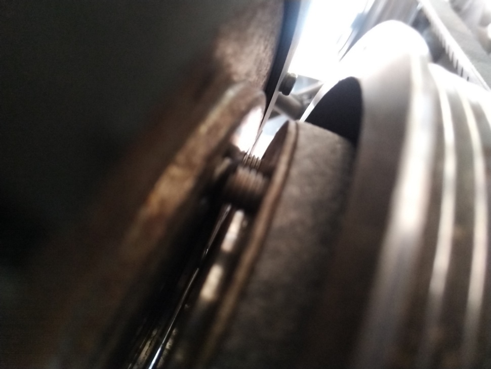

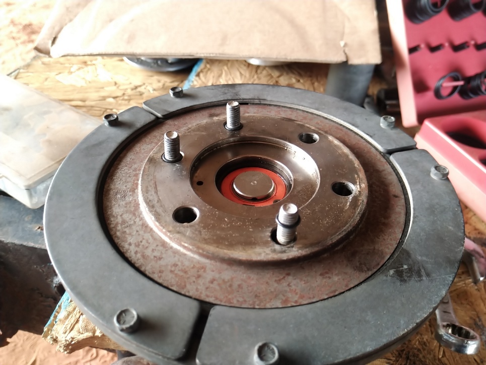

    Another way is to use O-rings, as I did in this case. I placed a bolt in position then rolled a small O-ring over it to hold it in place.
    As with the fan clutch many things have a small camphor on the holes allowing the O-ring to be left in place

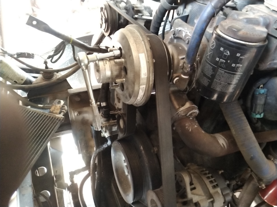

    This allows me to hold the assembly slightly away from the mating part and one by one start each bolt a few threads
    If you just jam in in place you will risk knocking most if not all of the bolts out of their holes.

    Not sure how the magnetic probes would work in this instance where there are several bolts to pass through a deeply recessed hole in an otherwise hollow housing into a blind threaded flange But I can see your solution on some things.
    I've lost count of how many of these things I've changed through out the years. They are not too bad with the radiator out of the truck but when having to change one on the side of the road for some guy who is running out of hours in his log book. trying to fiddle with 1 bolt at a time hoping the stupid spring washer doesn't fall off or you drop the bolt off the end of your 3/8 drive #45 torqux bit while trying to start it gets to be a pain.
    I've found the fastest way is to use either o rings on each bolt or a large rubber band around all of them, hold the clutch drive about 3/8' from the water pump flange use the driver like a real stubby screw driver and start each one 2 or 3 threads then if a rubber band was used just slice it with a knife. in the case of the o rings there is enough champer to allow them to remain in place.
    When removing the old unit you almost always have to air up the clutch after removing the fan so you can turn it to get the holes to align up with the recessed bolts.
    I have replaced some that had grenaded internally and would not release when that happens all thoughts of returning for core refund are swept from the table just take an air chisel and beat to apart enough to get at the bolts.
