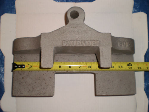

    I've made many of the normal tools for it already but thought I'd ask about this one for bending flat stock edgewise.
    It uses the 50B and 51B2-1 tools (and some smaller parts)
    I'm looking for any dimensions on these to help me build them. They are cast pieces from the factory but I'm making from steel.
    This is a pic I found of the 50B:
    and this is the 51B2-1:
    Also, would love to get any dimensions for other bits and bobs they have for this. I did make the basic stuff but lots I can still do.

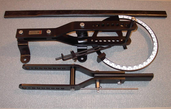

    Oh yeah, in case you don't know what a Hossfeld bender looks like, this is the basic tool. Hydraulics can be added and I'm actually doing that conversion but using an air operated bottle jack.

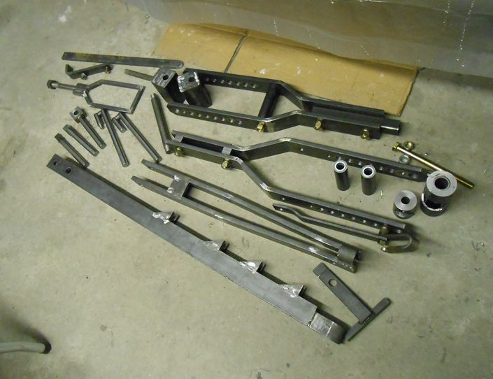

    Here is what I have made so far. A couple weeks of work for sure:

    Well after a few days of studying the pictures online and in the owners manual (the only thing I have that is made by Hossfeld) I think I have a fair idea of the measurements. Much bigger than I thought. 12-1/2 long as per the 1st pic above and I come up with about 5 inches tall plus the 2 lugs on the bottom and about 5-3/4 wide. That's the 50B piece. Considering it will be made from 1 inch steel and 3/8 inch plate, it's won't be something to drop on your foot! Then there is the top piece, shims and the curved die to make. Having fun though...
