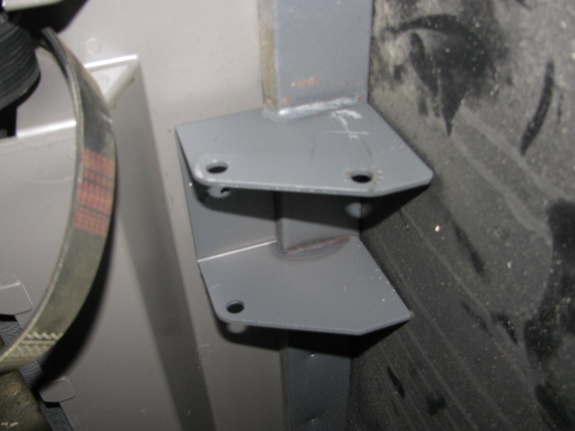

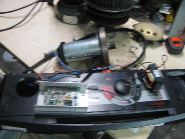

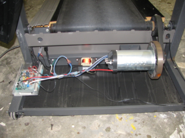

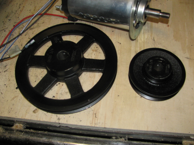

    OK, today I identified the components and removed them from the treadmill, took some closeups so that I know where the wiring connects. I bought two pulleys, cost about 90 at Miller bearings, they had me pick them up at the Martin gears warehouse and while I was there the boss asked me what I was doing and I told him and then I asked since the motor shafts did not have key ways he suggested that he have his machinist put another machine screw 90 degrees from the original in both pulleys for more stability and I was happy about that. He didn't even charge me, I thought that was very nice of him. Included in the following pics. are the components. I am running about a two to one ratio. I will explain later. I am going to have to cut out the original mounting bracket to use to mount the treadmill motor tomorrow. The shafts on the motors were real odd sizes, so tomorrow I will have to bore them out to fit the shafts, might have to pull out my 4 jaw chuck for accuracy. The real challenge is how to affix the motor mount on the original motor, but I will figure that out, I already have some ideas. In posting this project, I hope it is okay to post in bits and pieces along the way of the project so that I don't miss any information. Here are the pics. Also if you have any question, please feel free to ask. Robert Brown AKA machiningfoolTreadmill motor adaptation for Bridgeport type mill.-img_2133.jpg[/ATTACH]Treadmill motor adaptation for Bridgeport type mill.-img_2138.jpgTreadmill motor adaptation for Bridgeport type mill.-img_2140.jpgTreadmill motor adaptation for Bridgeport type mill.-img_2134.jpgTreadmill motor adaptation for Bridgeport type mill.-img_2141.jpg

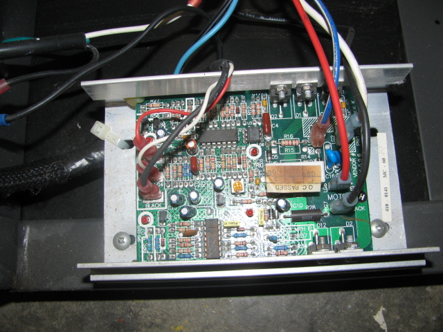

    I believe that I read from your other post that you have used treadmill motors a couple different time on other tools in the past. Are you using the control board and power supply from the treadmill for speed control?

    Yes, I use the same controller from the treadmill with the same motor so I am assured of a match. I have powered my SouthBend lathe and it sure turns it into a Cadillac of a lathe. In back gear it is amazing how slow and powerful it is. I have powered my 12 inch band saw and am able to slow the blade down for metal cutting. I also made a large sander out of a treadmill and someone asked what do I sand with it, and I said anything I want. I turned a Ryobi mitre saw into a metal cold cut saw by reducing the rpm from 5000 to 900. I have made 40 cuts of 3/16ths thick steel, 10 inches long with a carbide 10 inch wood blade. The trick is the slow rpm. Also there are no sparks. As far as rpm, it is adjusted for the job that I am doing and that is done with the pulley ratio. I also look for a treadmill that has either a knob type speed control or the slide type rather than the push-button type, I feel that I have more control.
