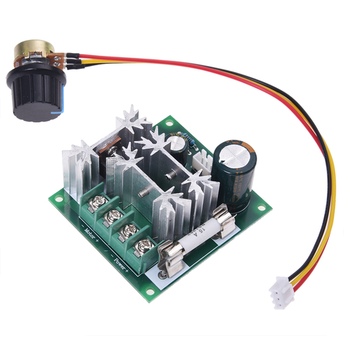

    i just want to point out an aspect that I have never seen mentioned and which depends on the use to which the motor will be put. Many applications do not require perfectly smooth velocity over a revolution, these include tools like a drill press and lathe for example. However, if you want to drive a grinding wheel and achieve great results then you need the motor to spin as close to constant speed during a revolution as possible. If you use an SCR or thyristor controller then at less than full speed you will have a very spikey supply which requires a lot of smoothing. On the other hand if you use a PWM controller then the higher carrier frequency will be much easier to filter and you will need a much smaller choke with minimum iron in it. Of course a PWM controller is also fine for a drill or lathe.
    So why are SCR controllers used at these power levels? It is simpler older technology and until relatively recently was cheaper, but nowadays PWM controllers are cheap enough so I see no reason to not use one.
    This PMW baby eBay (90VDC output) is around $7. Do I still need a choke for a lathe drive?

    Is 1kW enough for your application? That type of controller will work fine on a lathe without a choke, you could use one but NOT the same type as you would use for an SCR control. The core in those would be too lossy for the 15kHz carrier frequency and would absorb power and heat up.
    In previous questions on this theme I have pointed out another potential problem with using variable speed motors on workshop machinery. it is a question of simple physics.
    If you run at reduced speed with some form of mechanical gearing then the available spindle torque will increase in proportion to the motor:spindle speed ratio. On most machine tools you generally need more torque at slower speeds because you are dealing with larger or harder material (why else would you be running slower). If you have a single gear ratio with a variable speed motor then the spindle torque will remain approximately constant over the speed range. In other words at slower motor and spindle speeds the torque will not be multiplied as it is with mechanical speed change methods.
    The answer to this is to use a well oversize motor. I replaced a 1 hp motor on my mill with a 5 hp, and a 2 hp on the lathe with a 5.5 hp. Even with that I could detect much lower torque at very low speeds on the lathe. That is no problem for me because the nature of my work does not require that characteristic. My advice before involving yourself in the effort of fitting up a motor and control system is to carefully review your working requirements regarding torque and speed. A 1 kW motor on a lathe does not give you much torque margin for low speeds. A motor rated 1 kW at say 3000 rpm will only be able to deliver around 100 W at 300 rpm. If your work does not require high torque at low speed then you should be OK, otherwise you may be disappointed. A lathe is probably the hardest of all common workshop machines to get working well with these motors, unless it is a very small lathe.

    If you use a 2.5 hp motor you will need at least a 2 kW controller. the one that you previously linked to was a 1 kW unit.
    Thank you Tony!
