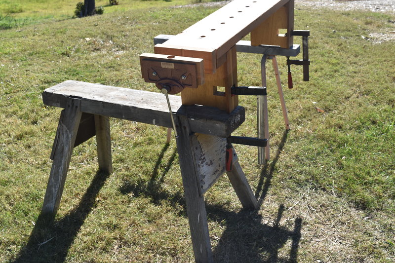

    This bench stores away in a corner or beside a wall. It can be cramped (clamped) to fold up saw horses od clamped to a picnic table or similar sturdy item.

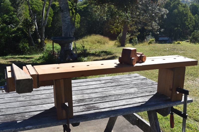

    I made this bench based on a Fine Woodworking article some years back. In my travels I have seen guys wood turning from the boot of their mobile home or caravan. Many of my local Woodworking Club (Cooroora Woodworkers Inc) members dont have enough room for a bench so it was shown to them in "Show & Tell" in which I do not usually partivipate. (Meetings are on Saturdays which is usually not convenient for me).
    The main bench section is made of Oregon pine that was salvaged from a contraversal Historic demolition site called "Her Magesty's Theatre".
    Originally it was part of a 12" by 3" beam that supported the roof. The youngest beams in that building were from renovations around 1901.
    The legs are mostly Meranti house steps cut down and faced with Austn hardwood, as are the vice jaws and end cap. There is
    a series of standard 3/4" dog holes along the length.

    I purchased quite a big lot with a brickie friend. He insisted in storing at another mates place but I stood my ground and wanted my 12 ft 12" by 3 " Oregon beams at my dads place where I covered it with viscreen and had on blocks with stickers . All the 30ft beams at his mate's place were eaten out by white ants.From the small bits not affected that i was able to salvage from the crumbs , I made items like toy trains & the pull along boot seen on the bench in one pic. I made them during the late 70's & 80's & the venetian blind chord had a loop in the end. Once the toddler was competant at towing the boot along he/she could use other skills to thread the chord through the holes in the boot like a bootlace expanding the skills. I must admit a 2" boot was much easier ,even for an adult, to thread so later models of the 3" ones had bigger boot lace holes.
