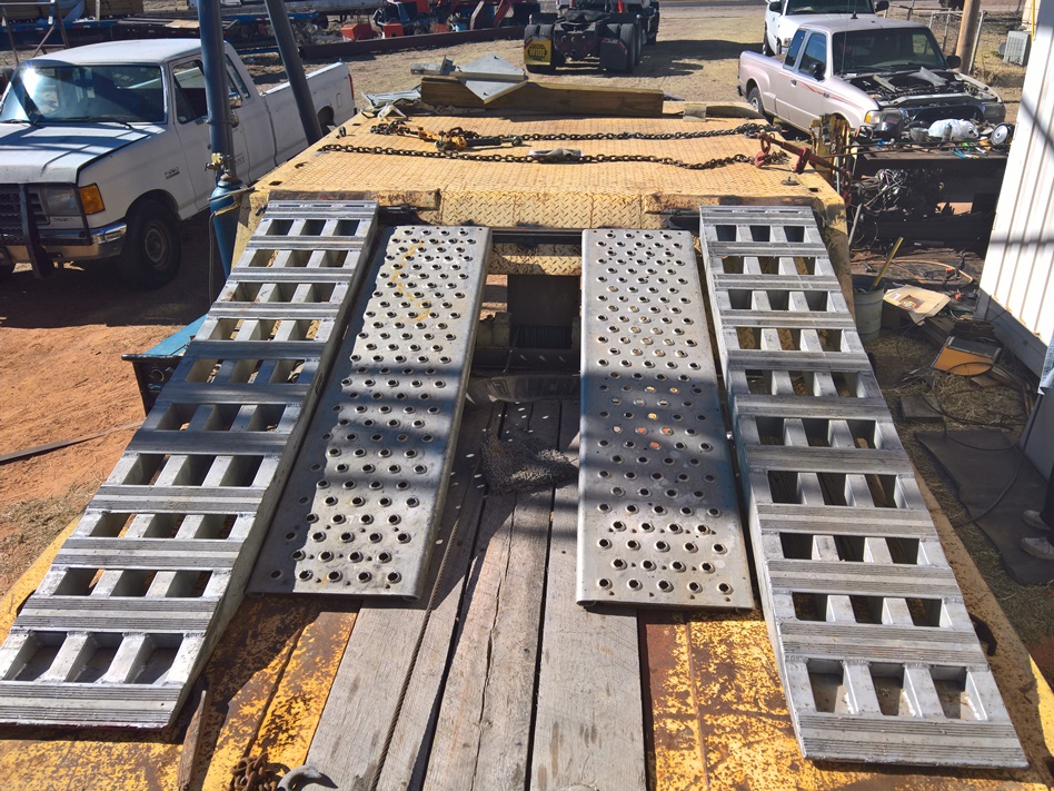

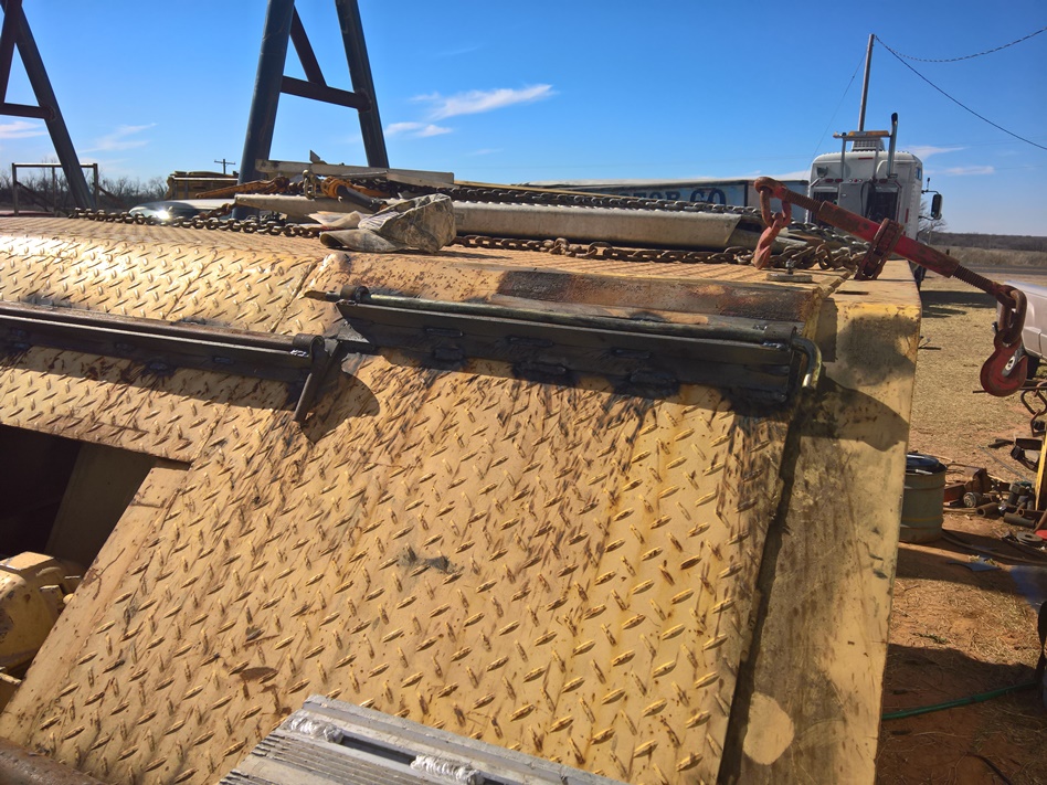

    We've been needing to change the ramp mounts to be able to drive equipment to the upper deck of the landoll sliding axle trailer
    So while Bob's truck and trailer was here for me to do some work on it I decided now was a great time to make these new mounts this way we could use the longer ramps or the shorter ones or have ramps close together for loading some of the equipment that was too narrow for the way the old ramps mounted or had 3 wheels
    First I removed the old mounts then made new ones and mounted them lower down the slope now the ramps do not extend higher that the deck like they did before and MY aluminum ramps that Bob carries will fit as well.
