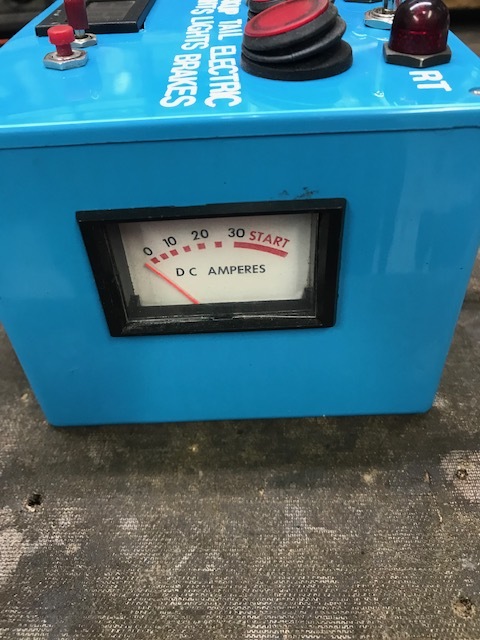

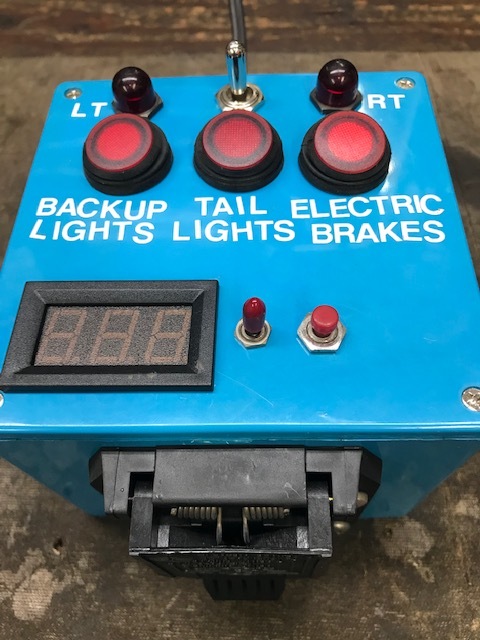

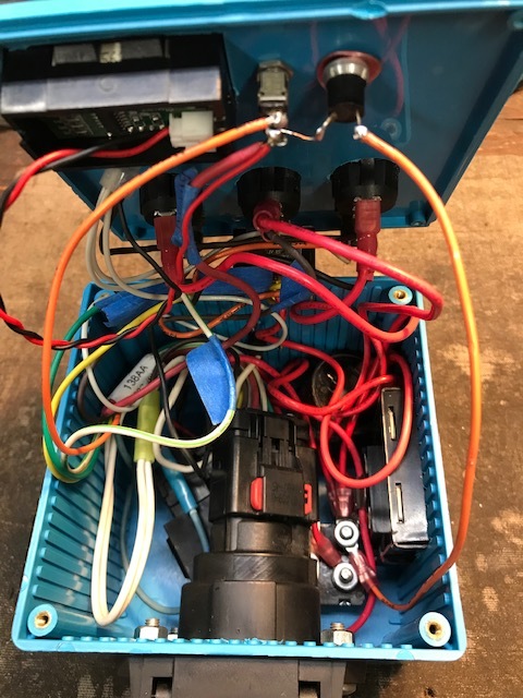

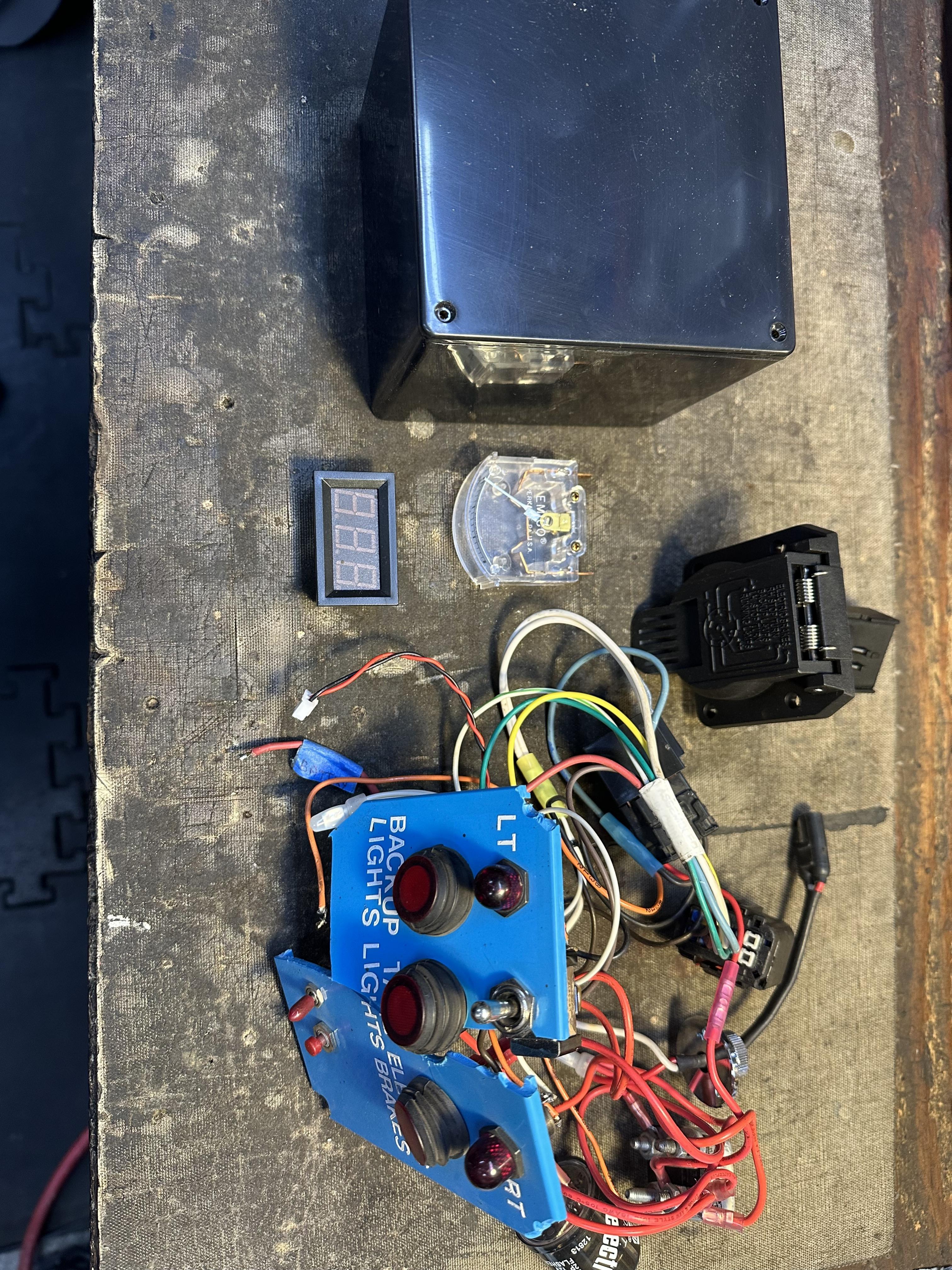

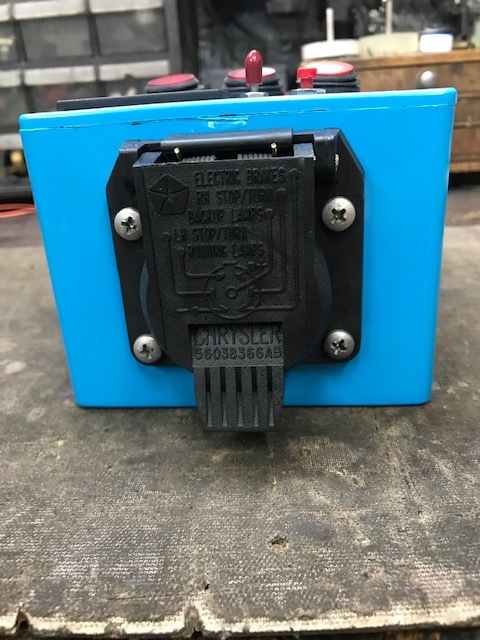

    I needed a tester for working on electric parts on trailers. I didn't care for the commercially available units so I made one with parts I had on hand. Inside the box are two automatic-reset circuit breakers, one for the lights and one for the brakes. A 30 amp relay for the brakes. A solid state flasher. I mounted a voltmeter and a amp meter. The voltmeter will check the test battery or the battery on the trailer. The amp meter is for checking the brake coils.
    Trailer Electrical Tester-img_1723.jpg Trailer Electrical Tester-img_1725.jpg Trailer Electrical Tester-img_1724.jpg
    It will test all electric functions of a trailer, Lights, Brakes and Battery

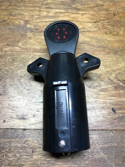

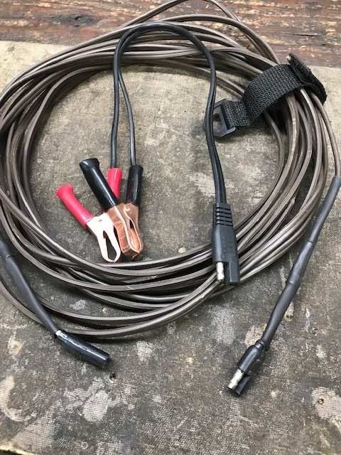

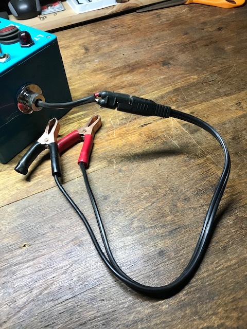

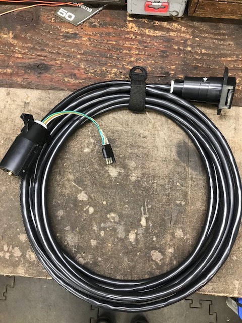

    I made a 25 foot extension for the trailer that can also be used on the tow vehicle with the plug-in tester so I can test from the driver's seat or under the hood where the fuses and relays generally are.
    Trailer Electrical Tester-img_1915.jpg Trailer Electrical Tester-img_1722.jpg
    Most trailers don't have backup lights put some trailers with surge brakes use a solenoid in reverse to stop the brakes from engaging, also will power-up backup cameras.
    Trailer Electrical Tester-img_1728.jpg Trailer Electrical Tester-img_1726.jpg Trailer Electrical Tester-img_1916.jpg

    Would you share the schematic?
  7. #5
    May 2019
    Lake Tahoe
    2,093
    195
    Thanked 944 Times in 573 Posts
    IntheGroove's Tools
    I'll try to draw a schematic but it might take longer to do than it did to build the thing...
