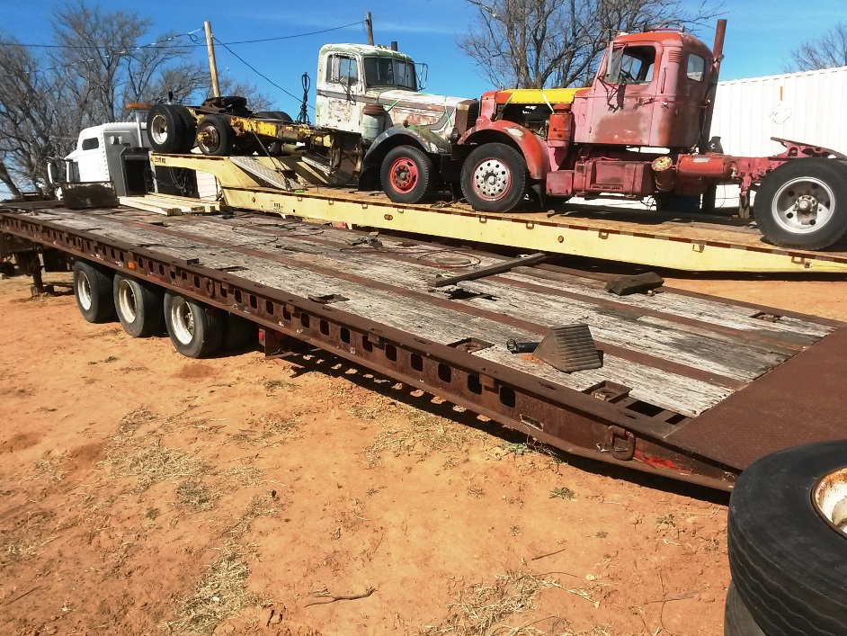

    The rear of low bed traveling axle trailers has long been a subject of safety concern for me and my Bud.
    We own several semi trailers ranging from flat bed to a couple with axles that move forward to allow the bed of the trailer to be a low angle ramp

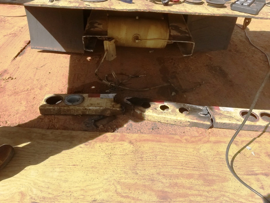

    Recently the Landol 317 was involved in an accident where a woman drove into the rear corner of it and damaged the flimsy bumper light bar.
    So I made a new one that is no longer "A" flimsy and "B" has so many lights that can do more than just be stop tail and turn. By activating a couple separate switches part of the lights become warning strobes for over dimensional loads
    And "C" I think it looks soooo much better.
    Off with the old
    2 trailers side by side the one nearest is the one I am getting ready to rebuild what ever is needed

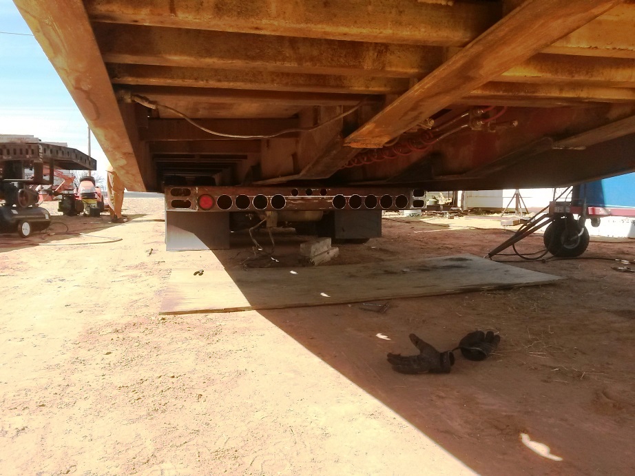

    Checking for fit axles fully retracted

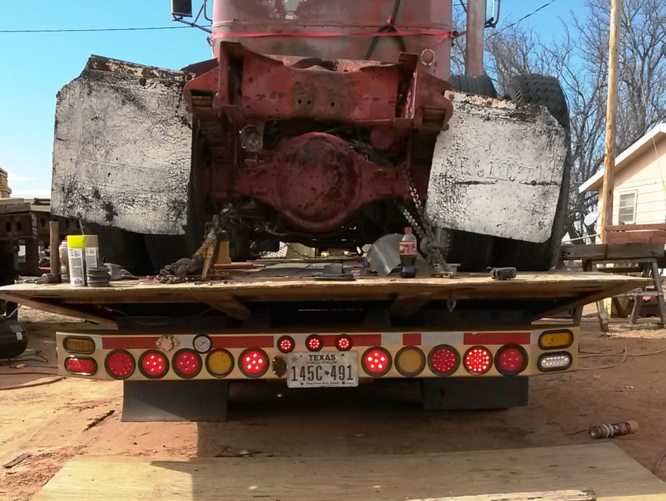

    Ready to roll

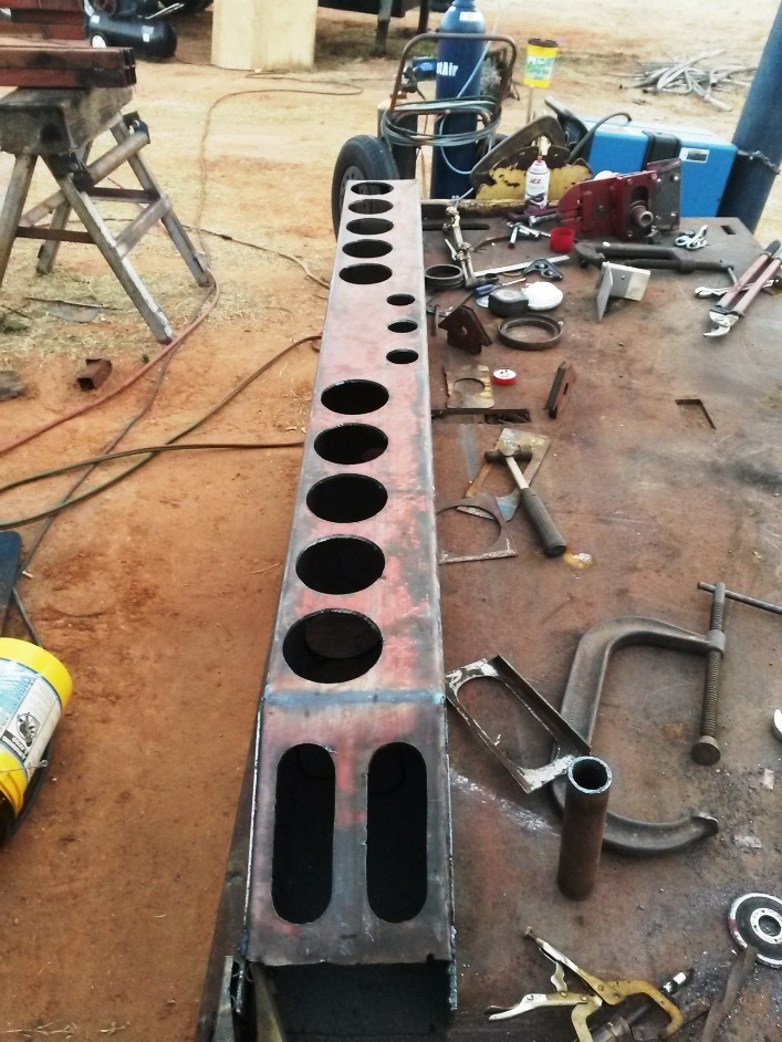

    Building the light-bar bumper out of a piece of 8" sq tubing

    How did you cut the holes? They look so perfect they must by CNC? If not you have a very steady hand with a torch.

    About half the time I do free hand holes of lights sometimes I center-punch the centers then use
    this
    http://www.homemadetools.net/homemad...g-attachment-3
    Other times I use my plasma and a template
    On this one the oblong the 4 1/2 and the 2 1/4" holes were done with a template and my plasma the 2 1/4" holes in the very ends were done free hand.
    Then after the bumper was mounted we decided to add a 1 1/2" hole for a 7 way trailer connector socket and a 2 1/2" hole for the air suspension Gage these were done free hand as well. About 10 seconds with a cob stone on a rt angle grinder cleans away any slag left behind by the plasma or the torch.
    Back in the days when I was running a yellow iron rebuild shop I used to regularly torch holes through 1/2" plate then thread them to 1/2 13 tpi I have cut holes nearly as clean and precise with a torch as can be done with a drill bit
