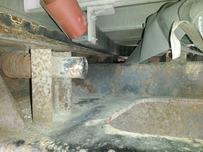

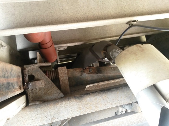

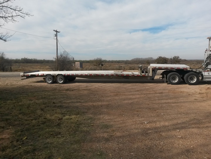

    My bud traded off one of the trailers I had rebuilt a few years ago for a 2009 Aluminum stepdeck.
    He stopped by today to show me what we now had, upon crawling under it I told him there were a couple issues that needed tending before he leaves

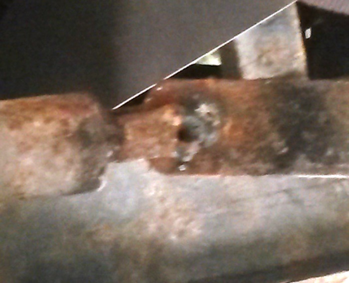

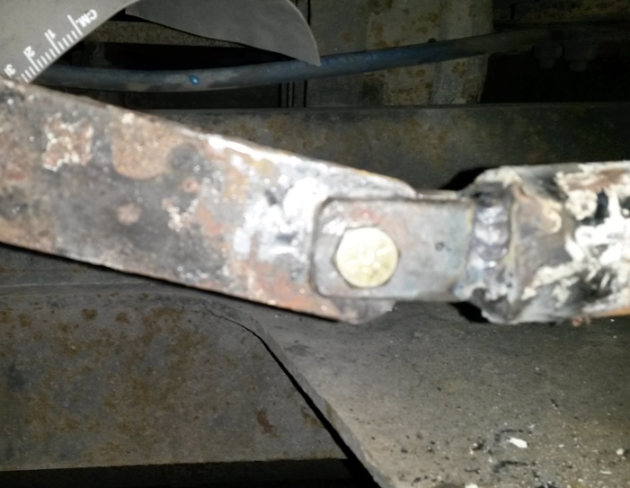

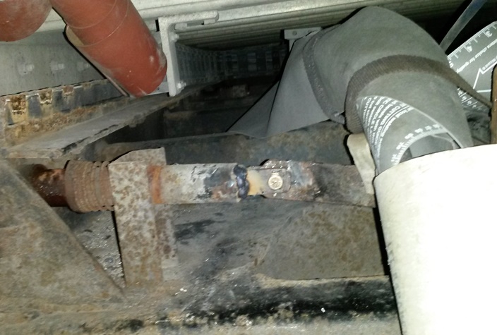

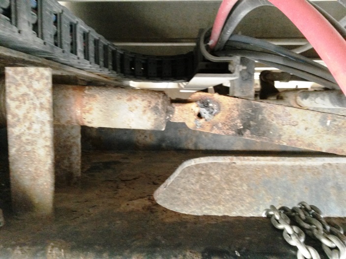

    2 of the lock pins were in bad shape and someone had actually tried dirt dauber welding them to make them work.
    I first wrapped all of the air lines with a few of my pipe marker wraps to protect them from sparks. THe thing about the nylon DOT airbrake lines is if under pressure the least little spark will damage them without pressure in them they are a little less prone to getting a hole melted in them.
    close up of the clevice

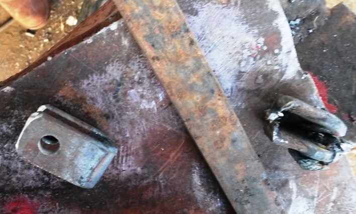

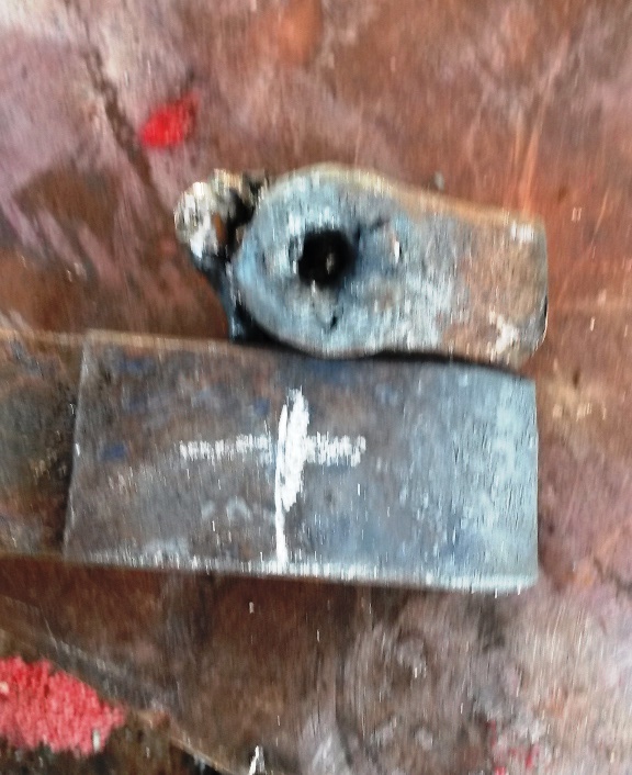

    I ground off the bad parts

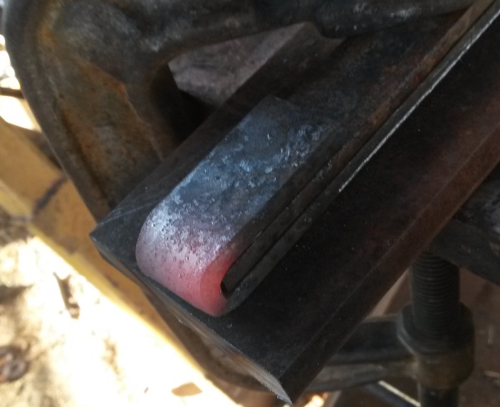

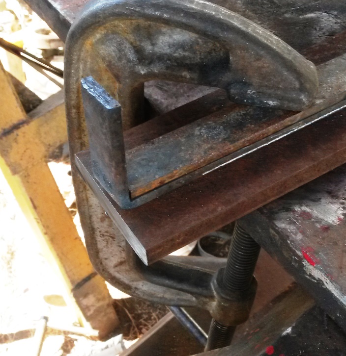

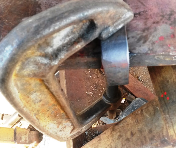

    Then I made new clevises from 1/4 by 1" flat bar clamped to my 1" thick steel table
    First bend

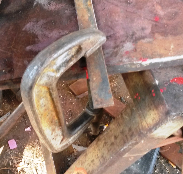

    After making the first bend I turned the bar over placed it on top o fa strip of 1/2" thick bar so it would have support for the second bend
    I placed a 1/4" thick strip on top to serve as the clevis separation spacer
    then made the final fold

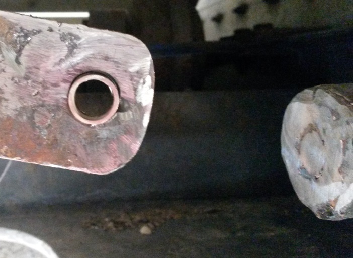

    The holes in the link bars were in bad shape from being welded on so I slightly reamed the oversize then cut bushings out of 1/2" 304 SS .035" wall
    Then welded the clevises to the lock pins and used 2" grade 8 bolts with long enough shoulders to reach through the clevis
    the bushings are .270" long and the link bars are .250" thick this allowed me to tighten the bolts using gr( nylock nuts as well
    Should last longer than the garbage the factory used I would have liked to have reamed the link bars out enough to press fit a bronze bushing in for the SS bushing to pivot on but sine they will probably only be used one every few weeks the cost could not be justified

    Pretty much. The thing that got me was not so much the welding but the fact that someone would actually think to do it. I mean if all they were trying to accomplish was to get the locks to release so they could slide the axle the "S" hook of a tarp strap would have sufficed or how hard would it have been to just put in a 3/8" bolt and nut since the pin was missing, but to tack weld 2 parts together when one of them must articulate through about 30° of motion at the pivot REALLY?
    Let's forget that at the factory when the trailer was made they used cheap galvanized rod ends welded to the pins in the first place was ludicrous enough. the clevis pins in those things have the hardness and durability lower than a bubble pack grade 2 bolt you might buy at a convenience store and held in place with a 1/16" cotter pin
