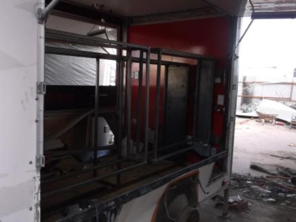

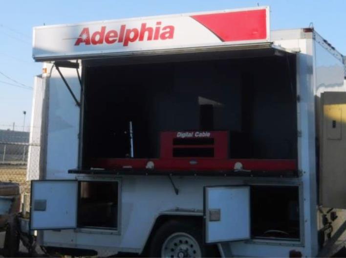

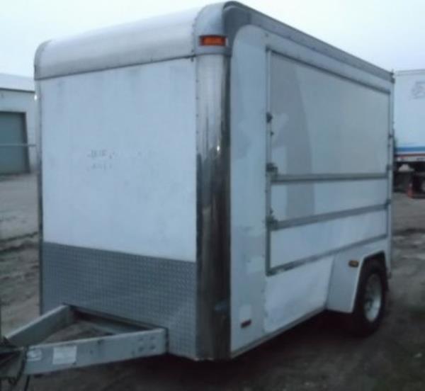

    A couple years ago I converted this box trailer for a friend of mine
    It started out as a digital cable display trailer

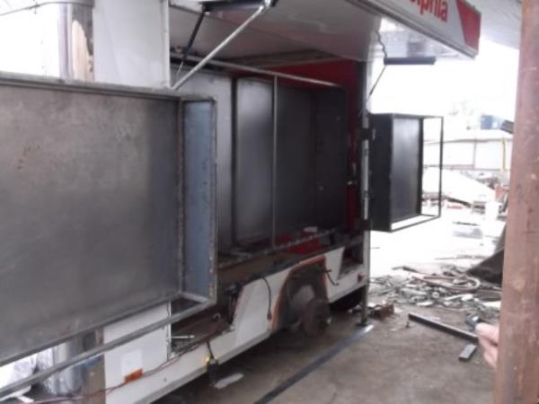

    I started by removing all of the interior shelvs

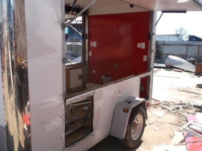

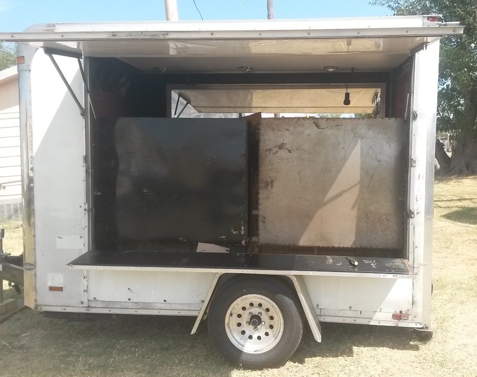

    Then I cut the side down to the fender

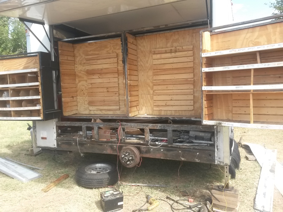

    Then I made a large steel shelf unit and 2 smaller ones the large one is mounted on a 4 link system and raised with a winch this brings the shelf from its at rest position near the middle of the trailer up and out against the side the small shelves are on hinges which allows them to fold to the inside against the large shelf keeping any product from being able to fall off during movement
    Later the frames were covered with wood

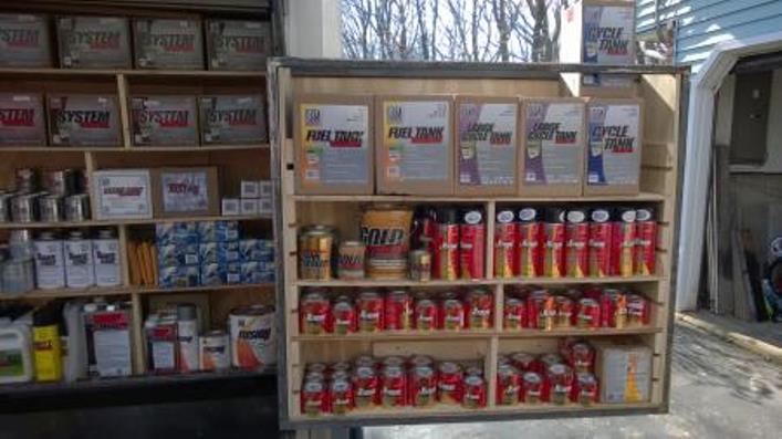

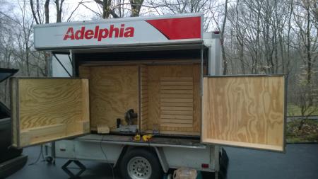

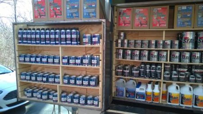

    the finished trailer looks like this going down the road

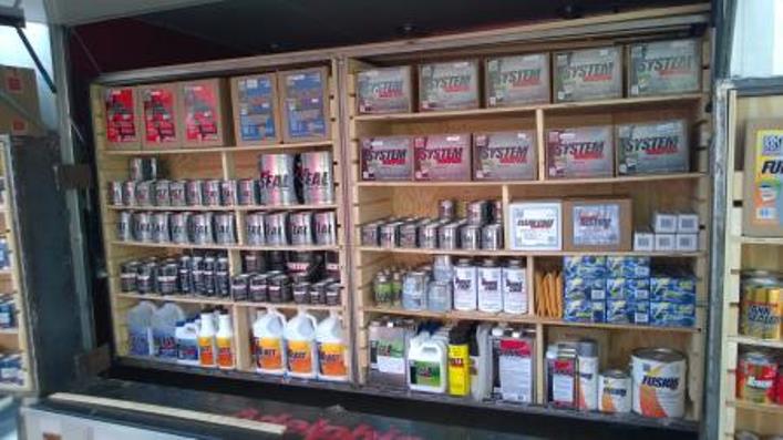

    but in as little as 5 minutes it looks like this

    Well the guy who owns the trailer was from Mo. but lives in Ct. since its completion in early 2015 the trailer has ben to no less then 200 car / truck and swap meets he has gone from selling a few $100.00 a show to being 1 of only 2 factory authorized reps. and almost outsells the factory itself one month his Fed-ex bill alone wass close to 5k
    We have plans for me to build him a larger tandem axle trailer or convert a motor home into half product and half living quarters.

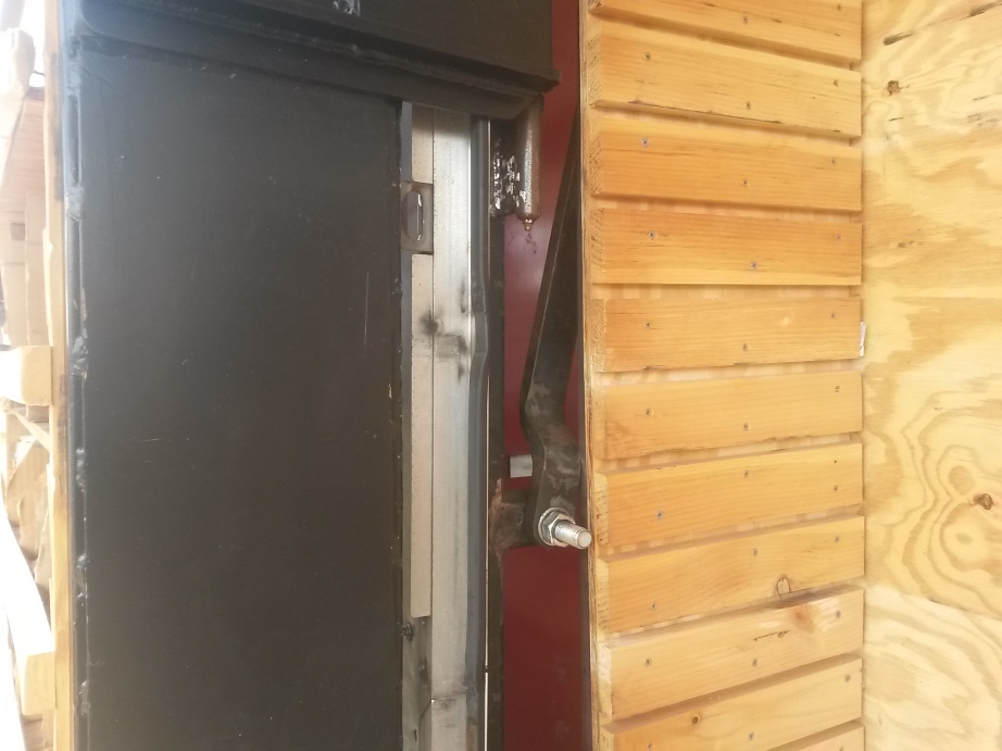

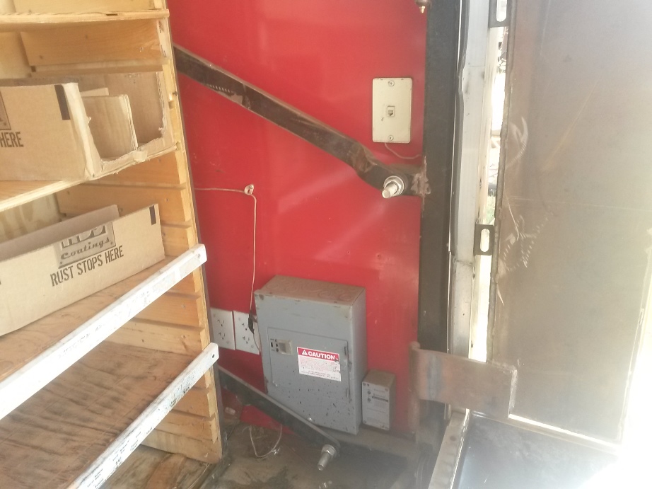

    the following pictures show a little better view of how the trailer works. with the elevating main shelf and the winged shelves.
    Some things are self explanatory but one note as to why the long bolts on the link bars. they are there to serve as a stop for the shelf going up
    As it was with the fold down shelf

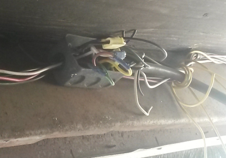

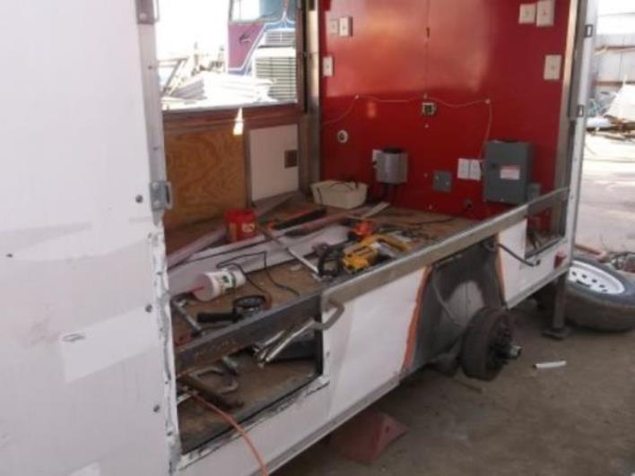

    his wiring after he had drug all of the wires off of it

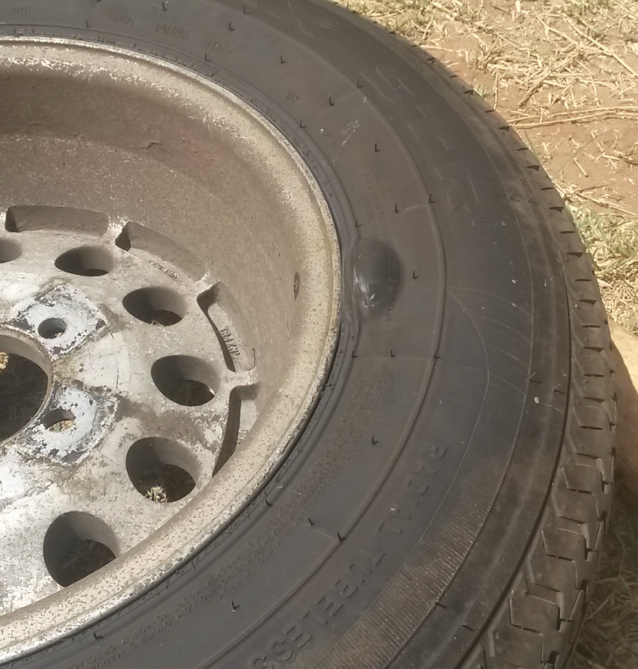

    found this on a 1 year old tire when getting ready to work on the brakes

    side sheet removed

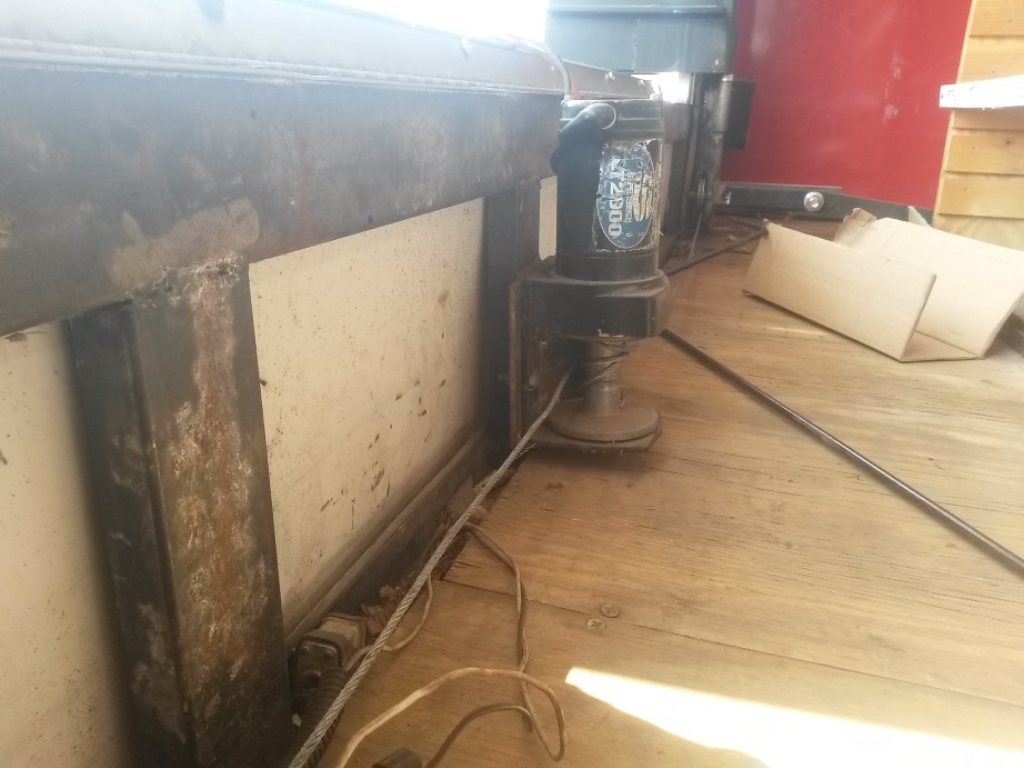

    This is the winch for raising the big shelf unit

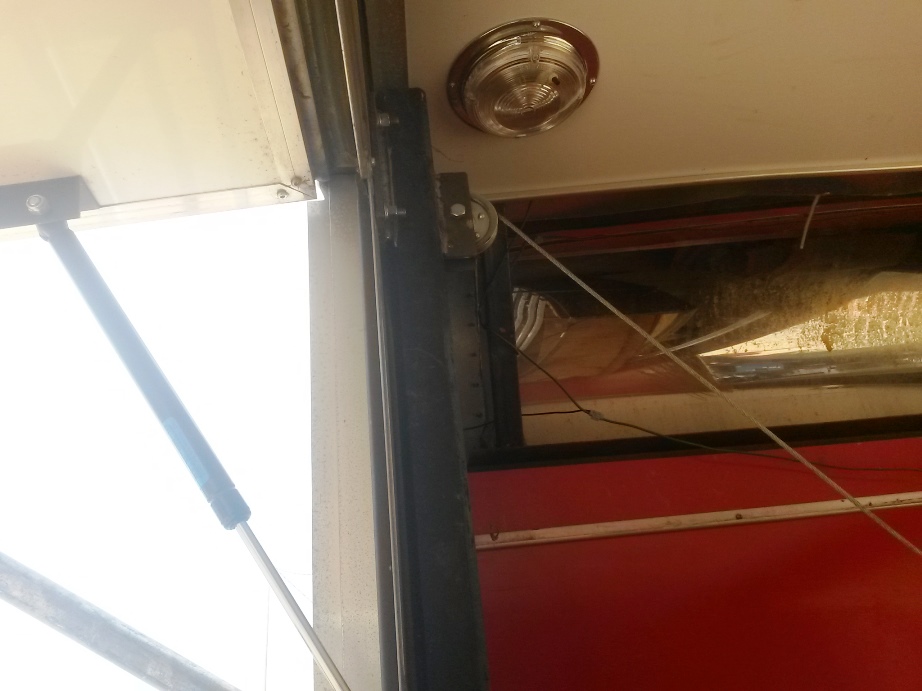

    routing of the cables mirror to this on the other end
    link bars mirror on other end
    long pivot bolt stops shelf also no threads are in the bronze bearing

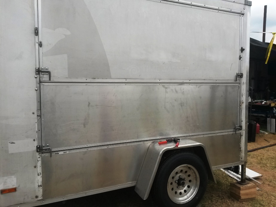

    New side new longer door to eliminate the folding shelf

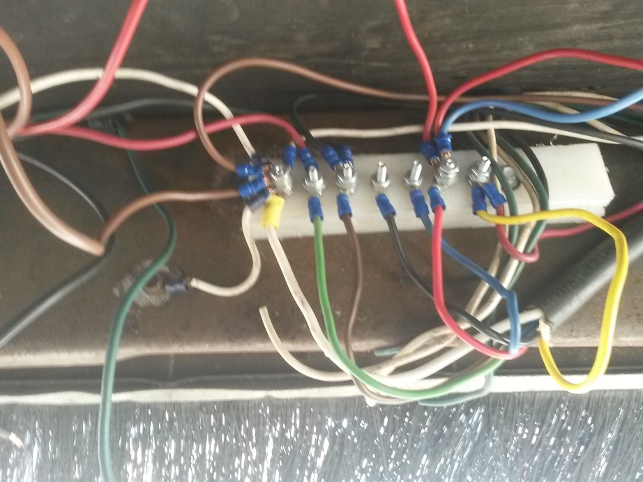

    Wiring still now how I wanted to do it but 100 times better than before
