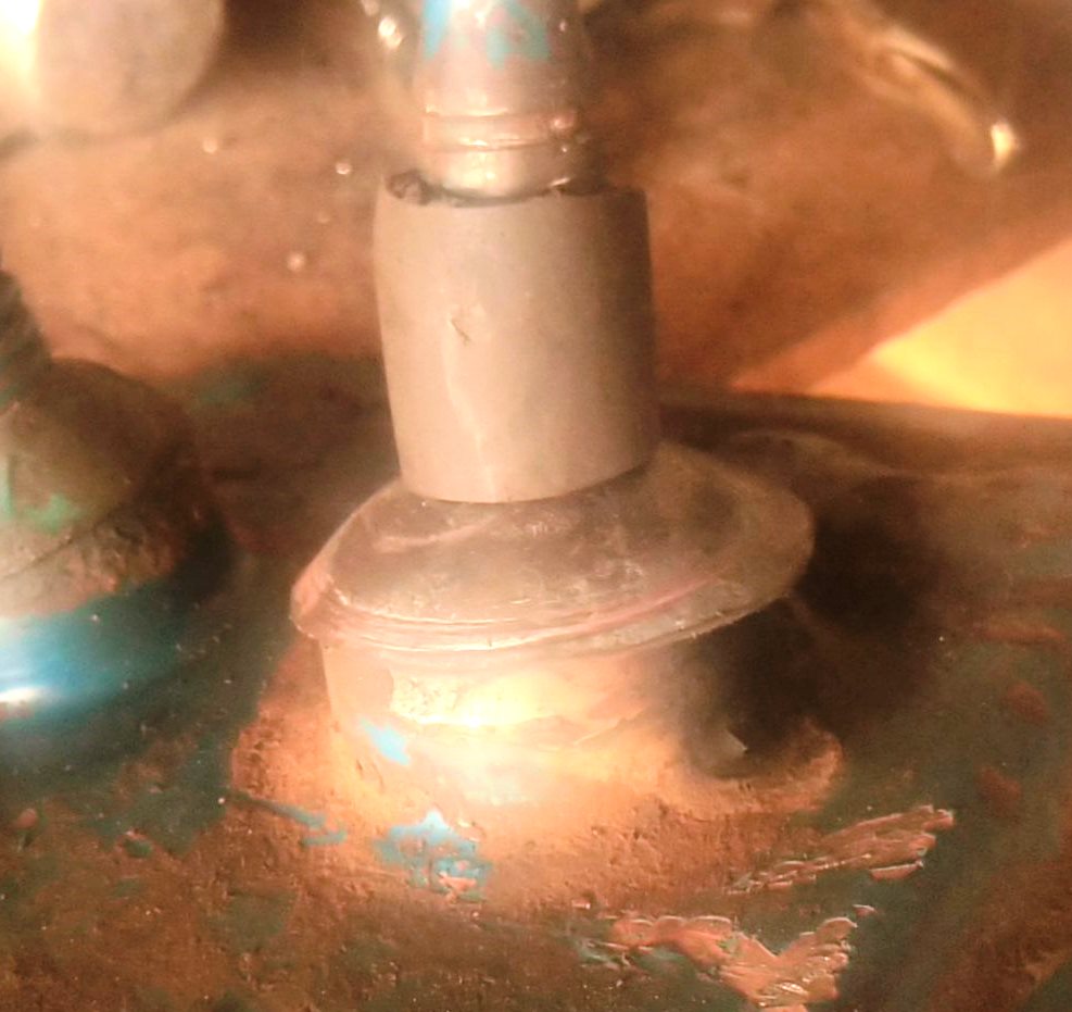

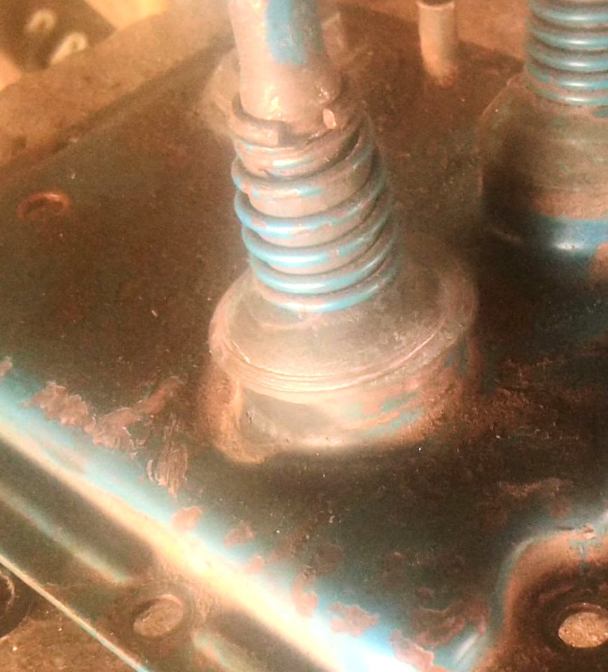

    However the ford had a gear shift problem we noticed while unloading it and there was water contamination in the transmission oil.

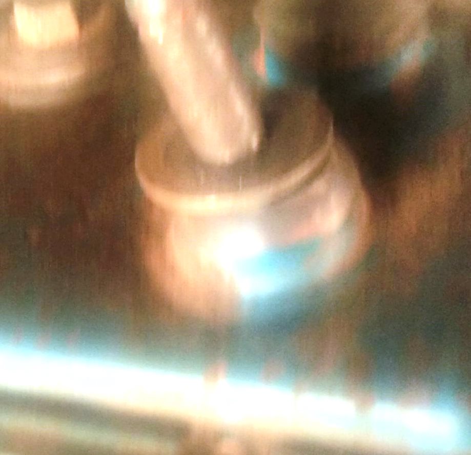

    the gear shift lever just needed a bit of weld build up to fix that problem, And while I had it apart I decided to cure the water getting in the transmission problem by making a new cupped cover to replace the missing one on the gear shift lever.
    I started with a fat of about 1/8" thick heated it up and bet it to about 1/16" thick then heated it up and shaped it into a cupped shape with the punch and die I made for that purpose

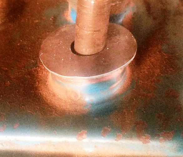

    I pushed a rubber sleeve down onto the shaft
    the factory spring keeper forces the shift lever to stay in place but the added rubber sleeve will further prevent water contamination
