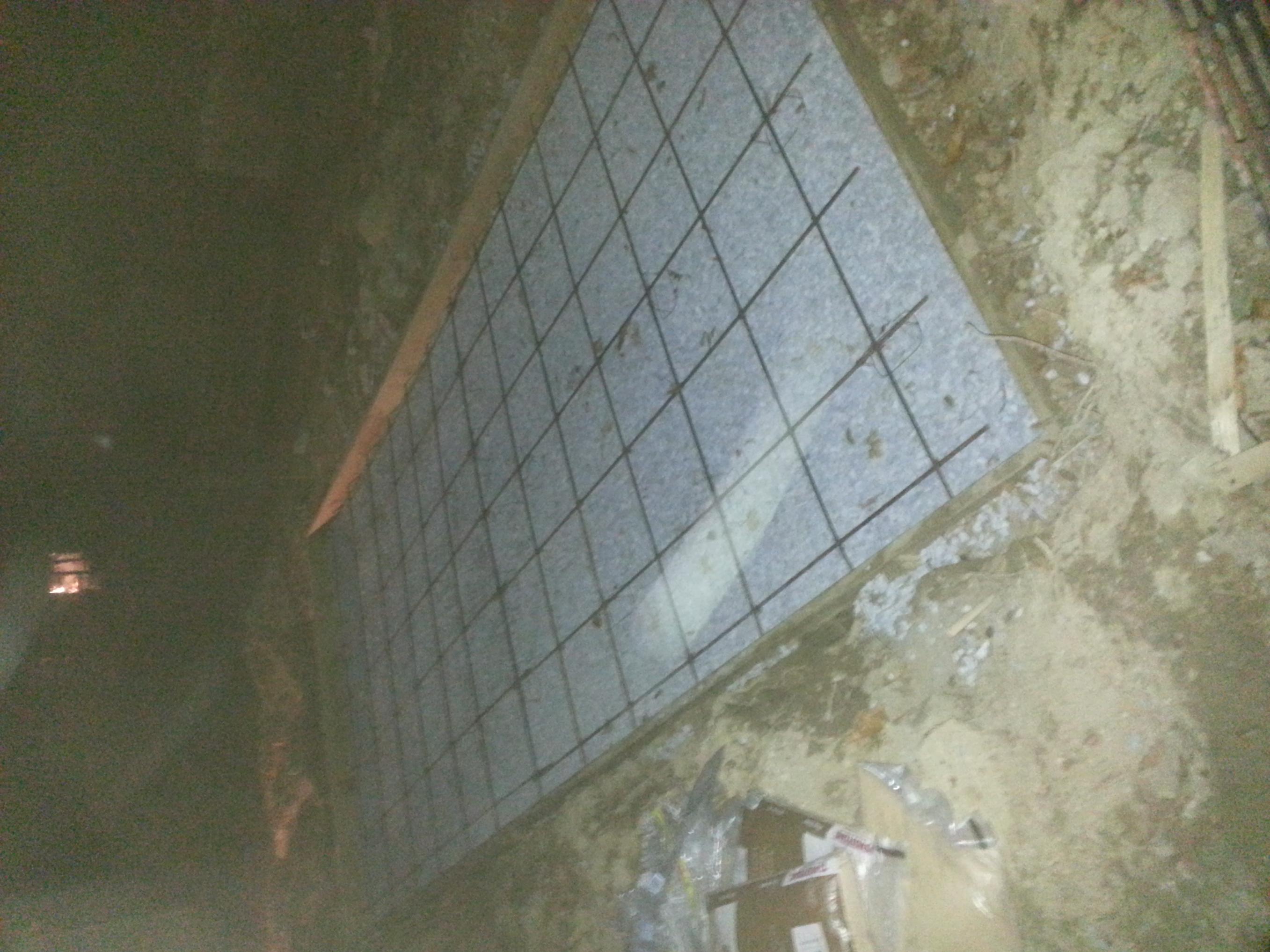

    This concrete pad will have top to bottom: 6" of 3500 PSI Winter Mix Concrete, a Gridwork of Metal-Tied #4 Steel Rebar on 18" Centers, includes a 5" level of 3/4" stone, and Tamped Virgin Ground for the base. This will more than suffice the required 1000 PSI load requirements from the manufacturer specifications for a liquid container weighing 1400 pounds empty and 14,500 pounds full of liquid. Form removal to meet ACQ requirements and backfilling after the pad cures. The tools to make this were many along with my own homemade-metal bender. The sweat equity is also a major investment, but the enjoyment using the device afterwards will be unmentionable.
    Attached Thumbnails Attached Thumbnails TOWNSHIP OVERKILL 20 X 10-20151127_184053.jpg

    Spa pad?
    Ken
    martialfollower2004's Avatar
    Nov 2015
    Thanked 5 Times in 2 Posts
    martialfollower2004's Tools
    Exactly... !
    795
    Haha. That was a nice description. Thought it was for some industrial container or something.

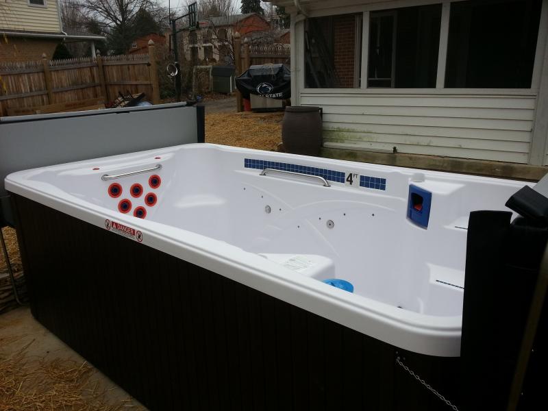

    We want to make sure it is up to specifications and the township made sure of that! I think the pad is more than adequate, our area probably is not zoned industrial though:0). ..
    Everyone Needs a Place To Blow Off Some Energy When Your Ideas Don't Work Exactly Right...;0)
    Last edited by martialfollower2004; Dec 21, 2015 at 07:12 PM. Reason: Finished Product Minus Entry Point
