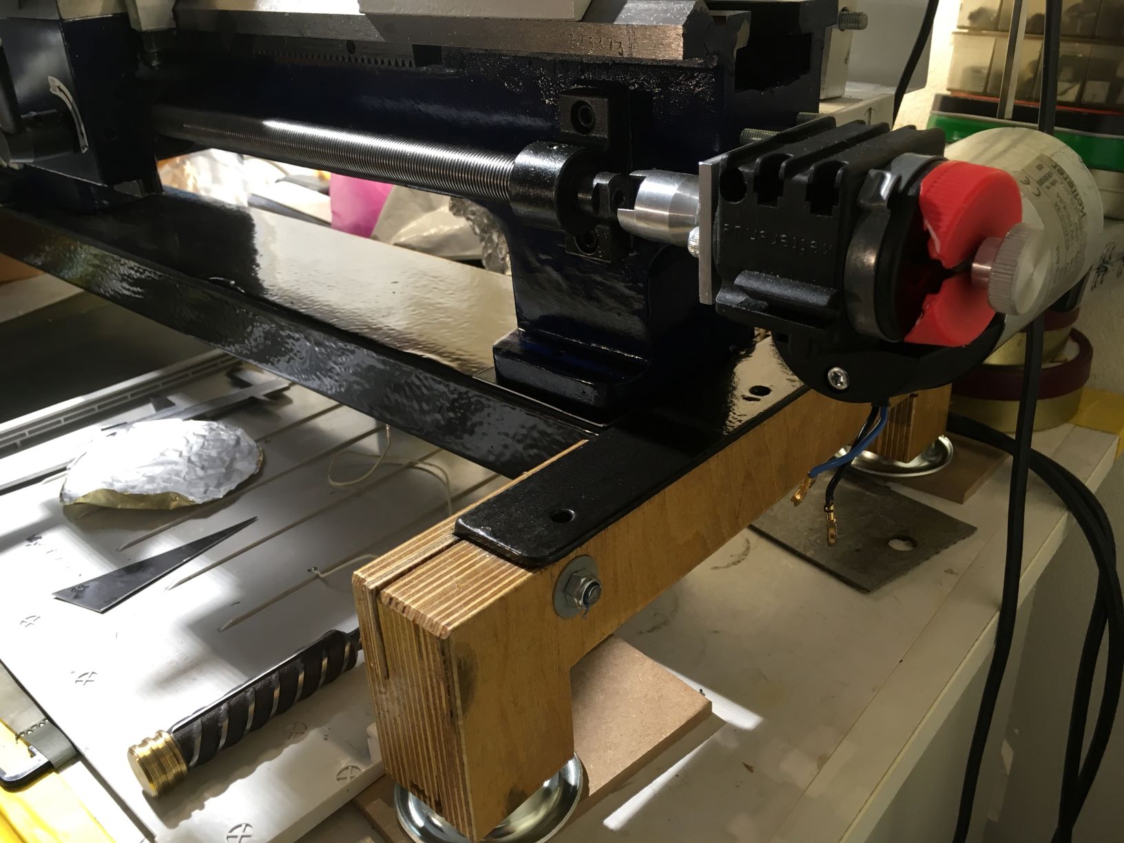

    Sorry for the black Hammerite finish, and the barely completed 45 mm square plywood feet.
    Reason for the wide footprint plywood stand is to provide for a wide, long and roomy chip tray,
    that can be removed to any side, front or back.
    I also chose to have two feet (rather than a monopost) at the tailstock,
    as my "domestic workshop" is a wheeled workbench, and I don't particularly need the lathe to topple off it.
    Here you also can glimpse my worm drive lead screw motor add-on:
    http://www.homemadetools.net/forum/y...ive-love-73211
    Also my "Idiot safe" red yoghurt lid for preventing the machinist ( i. e. me) from accidentally engaging the dog clutch,
    and the black grinding angle 20 & 8 deg for the hob cutter tool.

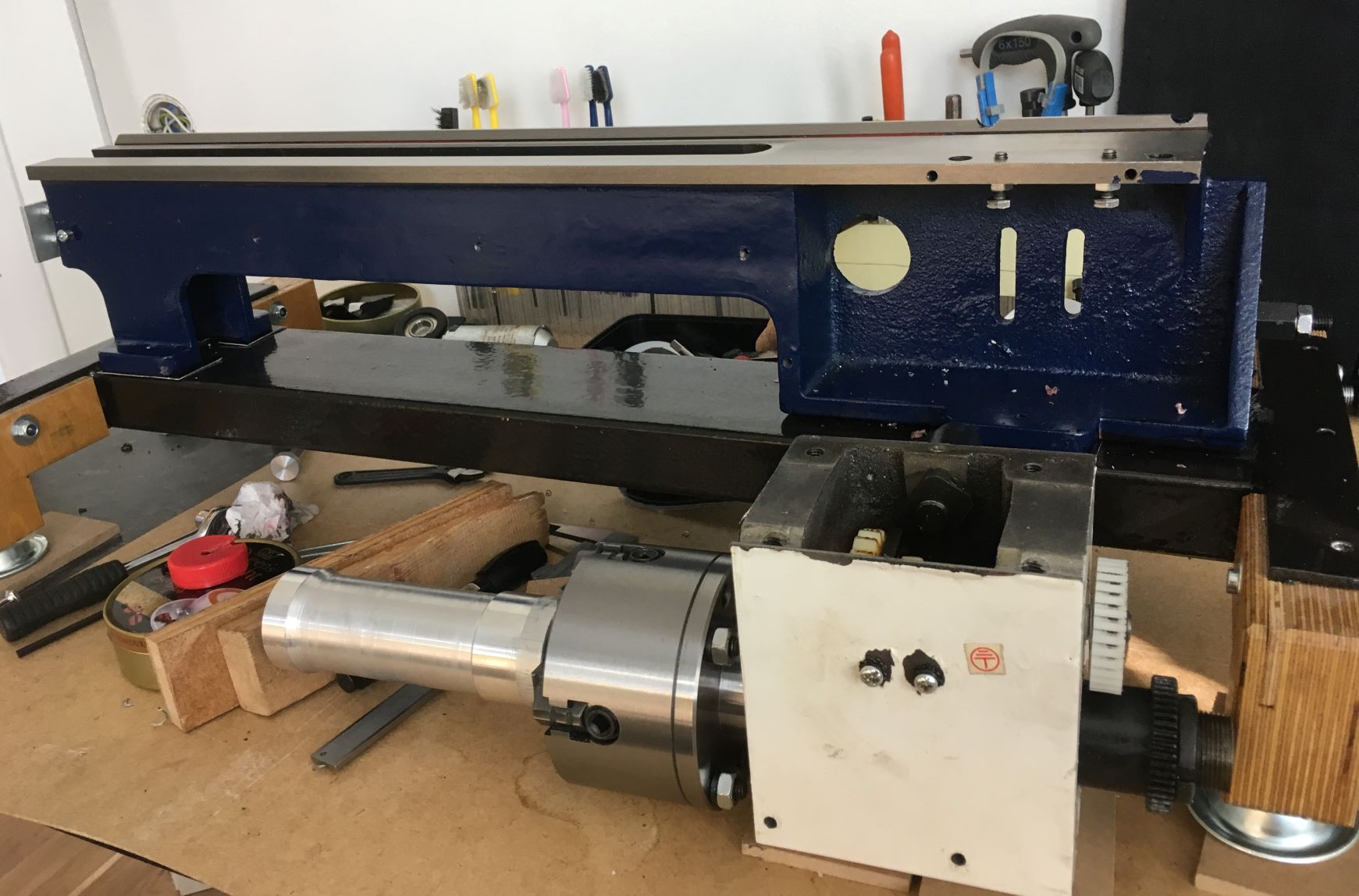

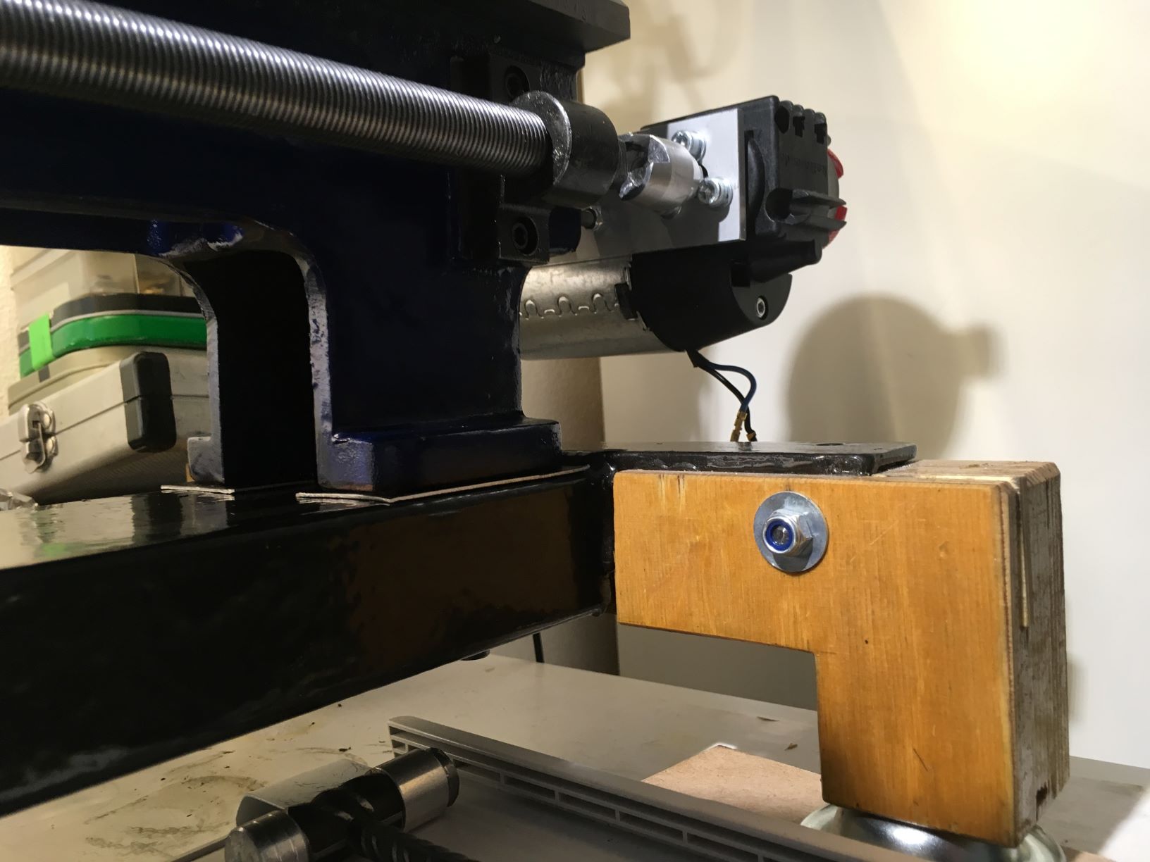

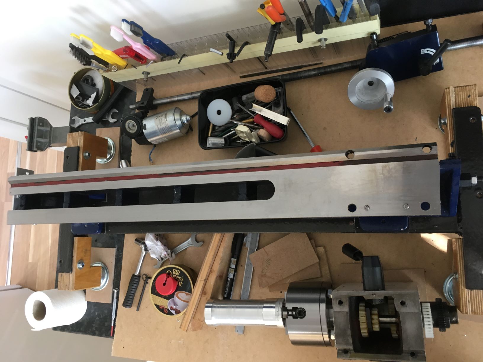

    Guess these pics better show than those previously posted:
    Yup - I'm amidst a complete teardown and upcoming headstock alignment, as I found it's out 0,147 mm in 113 mm run.
    (I.e. close to 6 thou in less than 4.5"!)
    Not just "cutting a taper" - a veritable cone manufacturing machine!
    "-As I was just checking the bed alignment on the RHS mount, I realized that..."
    Headstock bolts were loose, apart of a bad initial fitting and the spindle bearings aren't coaxial with the headstock centre line.
    The only thing I didn't check after my initial "delivery teardown & overhaul" 2 years ago.
    Didn't want to disturb the motor at the time, and as all the other milled & ground surfaces was tight, flat, nice and perpendicular...
    I just assumed... No more of that - Measuring is Knowing.
    Wow - really. The fun never ends. At least nothing is broken. Being a cheap guy - my time for this is free! -Whoopee!

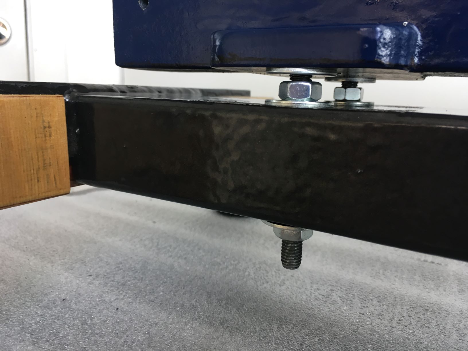

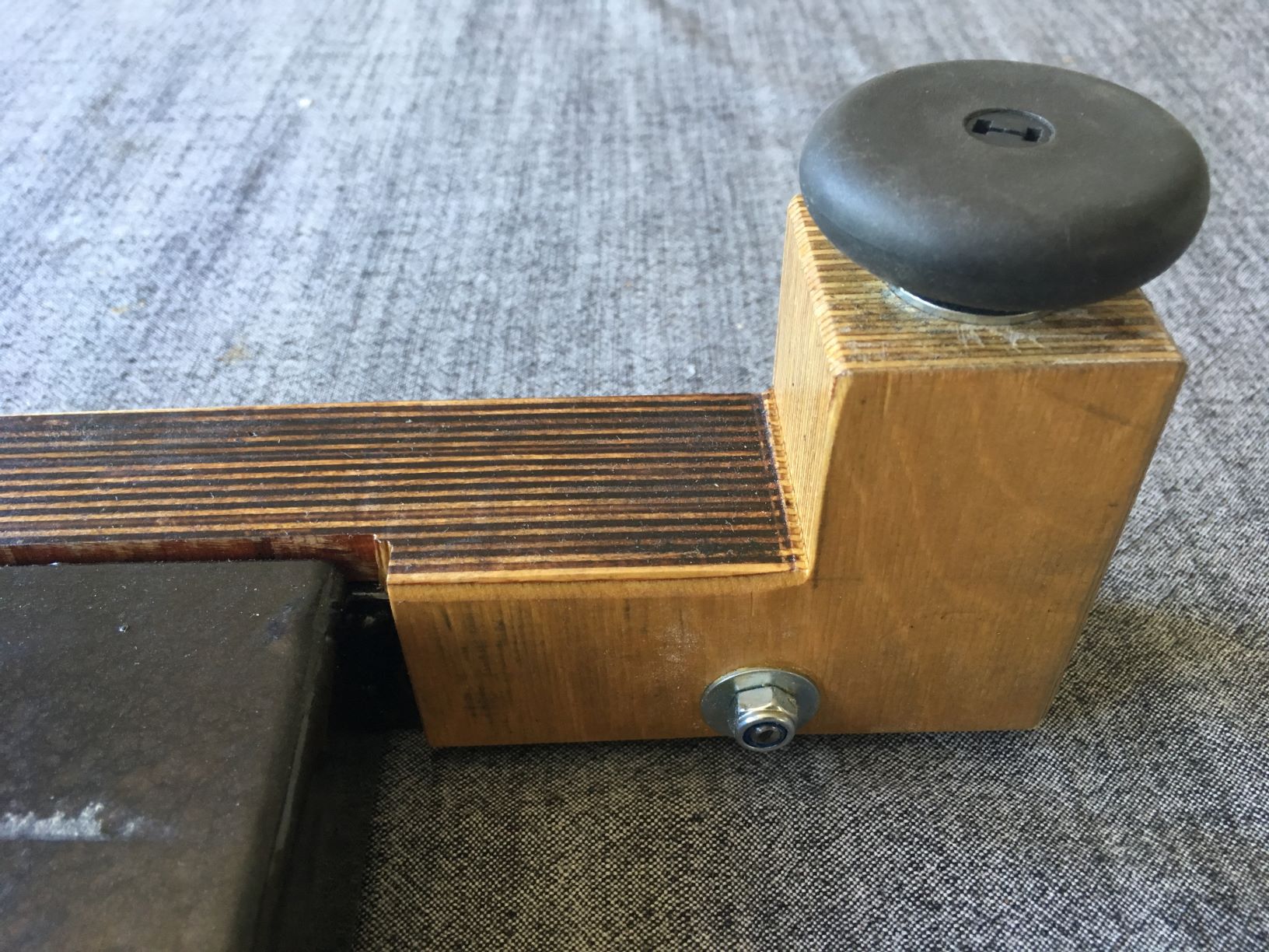

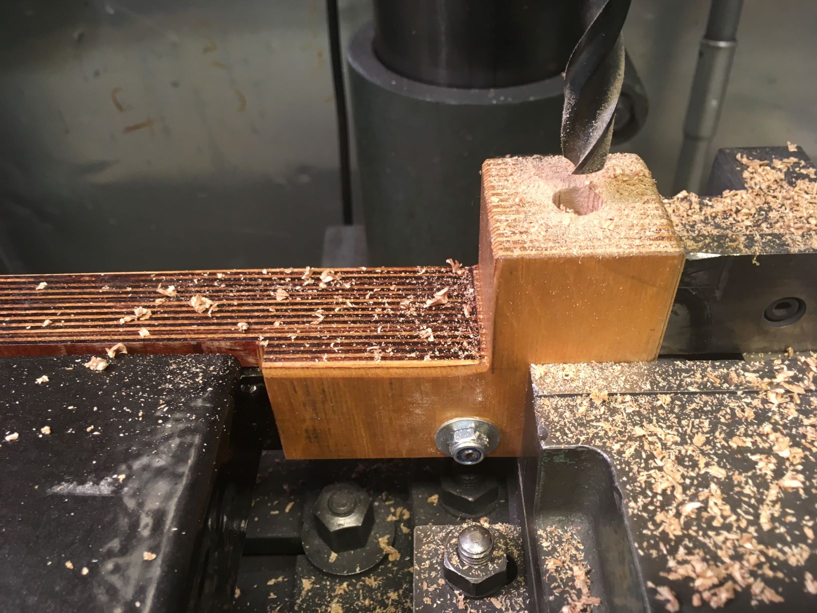

    Whilst rebuilding/ aligning the lathe, now's the time for fitting the adjustable feet for the entire stand.
    4 pieces of 48 mm dia, former office chair rubber knobs, 4 reused M8 threaded inserts and a 12 mm drill:
    Torsional beam mini lathe stand-12-mm-drill.jpg Torsional beam mini lathe stand-knob-foot.jpg
    These will admit adjusting the 4 legs of the entire lathe/stand on just about any surface,
    without disturbing the bed's flatness - as the RHS beam provides (almost) total rigidity.
    Thus the lathe's bed must be rigidly fastened to the beam, but also allow for relative and easy adjustments:
    4 pieces of M8 all-thread were cut, and 15 mm of one end of each were turned down and threaded M6,
    put into the bed, now resting upside down diagonally on my surface plate.
    Fitted the all-threads pointing upwards, adding washers and nuts, placing pieces of 10 mm HSS blanks as temporal spacers.
    Then the beam/ foot was lowered, the final washers and nuts put on, and adjustments started.
    My point in having it upside down would hopefully provide bed flatness & stress-free initial mounting,
    as the 6 kg beam "just floats" on the HSS pieces whilst I tighten the nuts equally, just releasing the spacers.
    If done the ordinary way, perhaps warp could be introduced by the lathe's own weight affecting the beam unevenly.

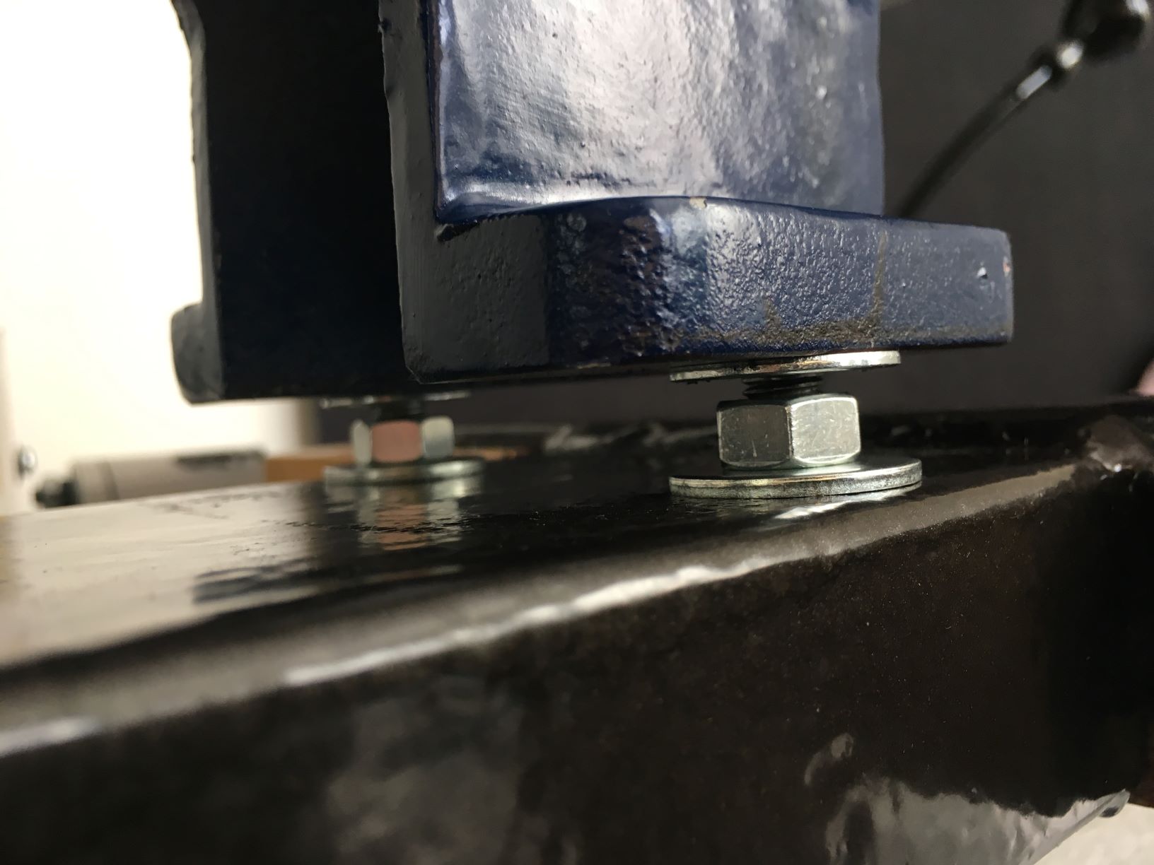

    Headstock (left) and tailstock (right)
    Torsional beam mini lathe stand-hs-m8-all-thread.jpg Torsional beam mini lathe stand-ts-adjust.jpg
    When turned over, bed now measures straight and unwarped to 0.05 deg (I'm waiting for a machinist's level in transit).
    The bed top is also parallel (i.e. equidistant) to the beam, both length- and crosswise.
    I'm considering helping the headstock bolts with a 4 x 4" 10 mm aluminum plate for weight distribution - undecided yet.
    Now alignments, measurements and tweaks will commence for the headstock, saddle, crosslide and tailstock in rotation.
