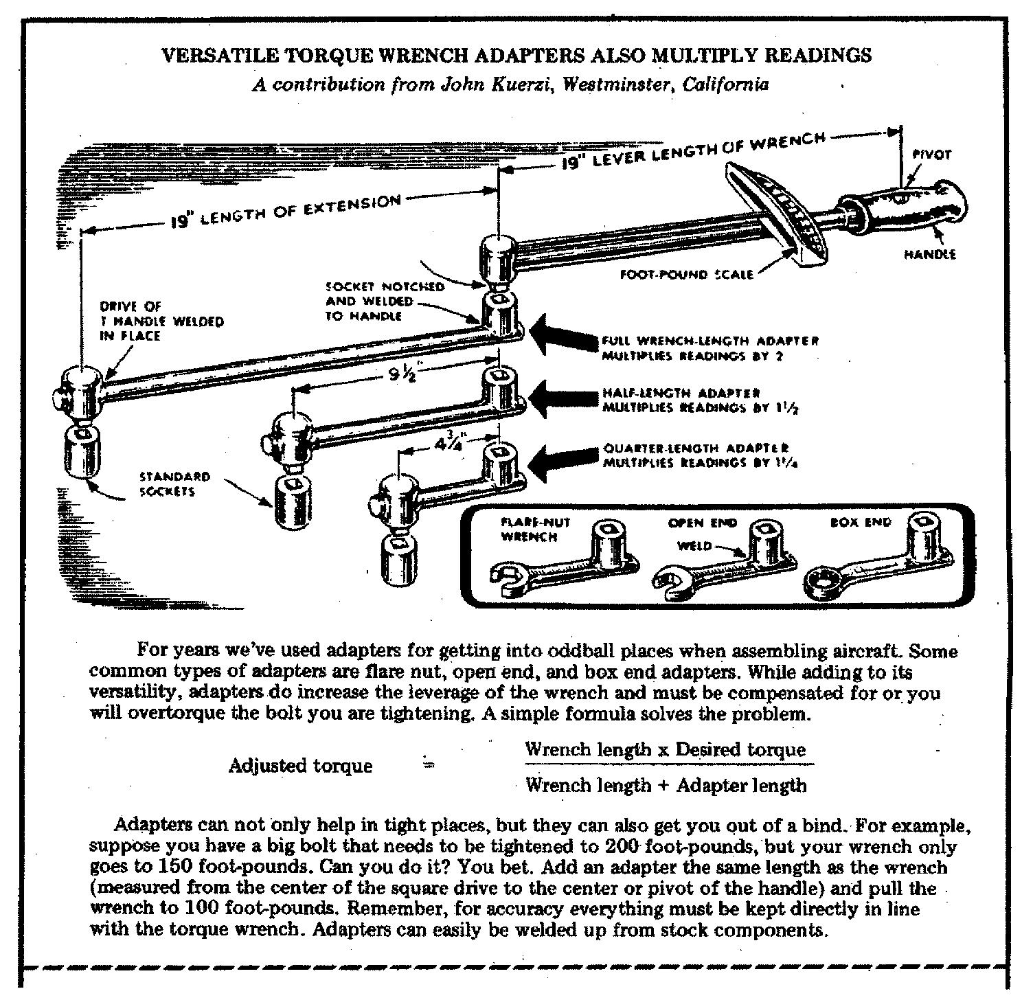

    katy's Tools
    Here ya go. IIRC this came from Busted Knuckles magazine.

    Quote Originally Posted by katy View Post
Name:	Torque wrench adapters.jpg
    Katy,
    I see a large offset between the fat bar on the torque wrench and the major axis of the extension wrench. This will cause a twisting force which I'm trying to avoid by lining them up. I have seen the equation on two web sites plus plugged in my own numbers and got consistent results.
