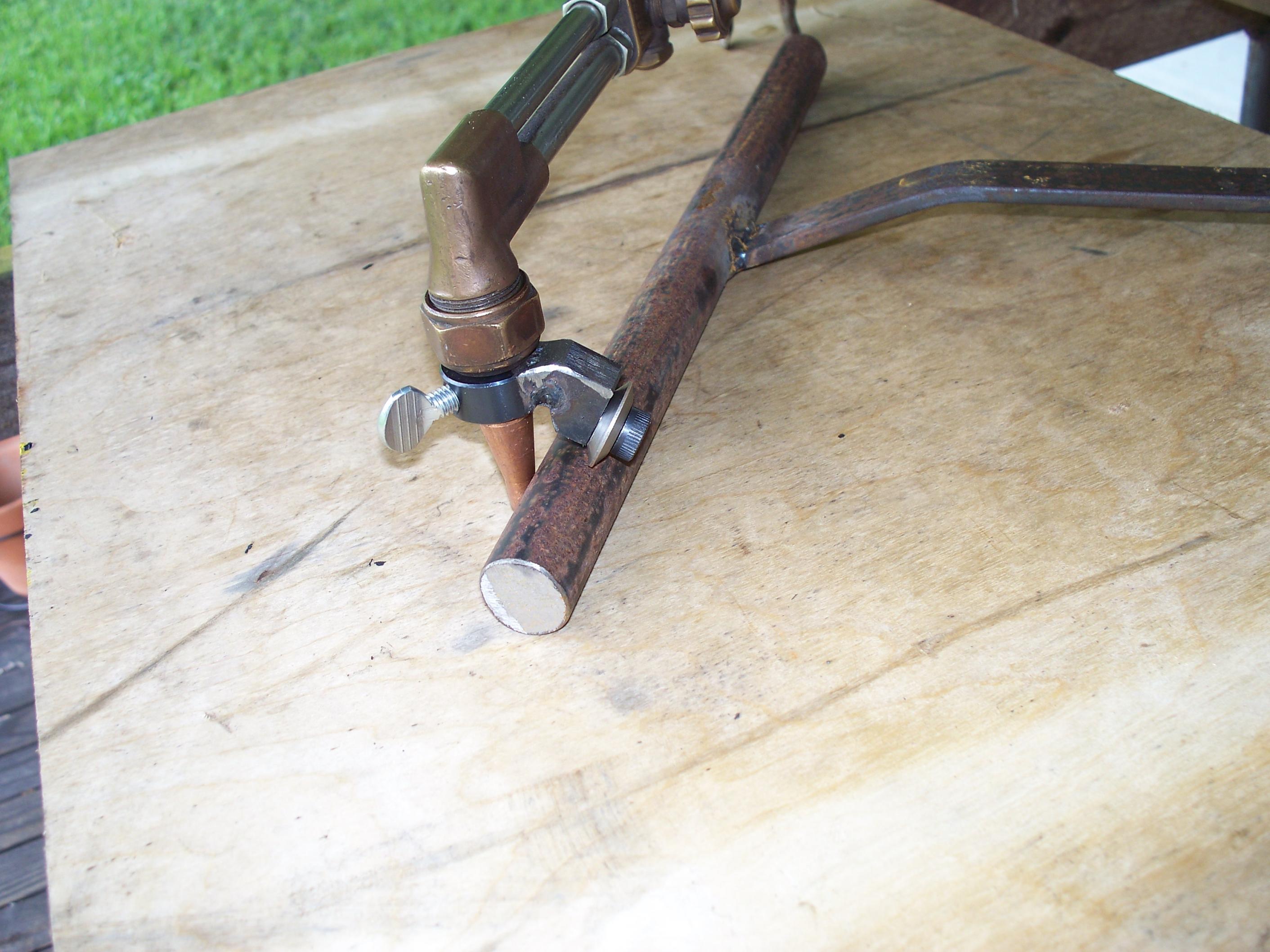

    torch cutter bar roller guide
    When making straight cuts ,I use a 1" round bar and use this roller guide. It holds the torch against the bar and at the right cutting height. The roller reduces drag.

    Very simple and useful, Thanks

    Nice! What are your thoughts about using a lighter tube? I was thinking of making it lighter but was wondering if the heavier bar weight is an advantage?

    Quote Originally Posted by Saltfever View Post
    I have had problems with lighter material getting warped from the heat.

    Good point.
