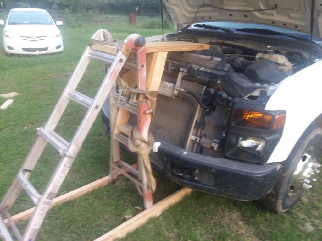

    I am in need of a topside creeper. It is amazing how much easier it was to reach the spark plugs on the back of the V10 engine with the topside creeper.

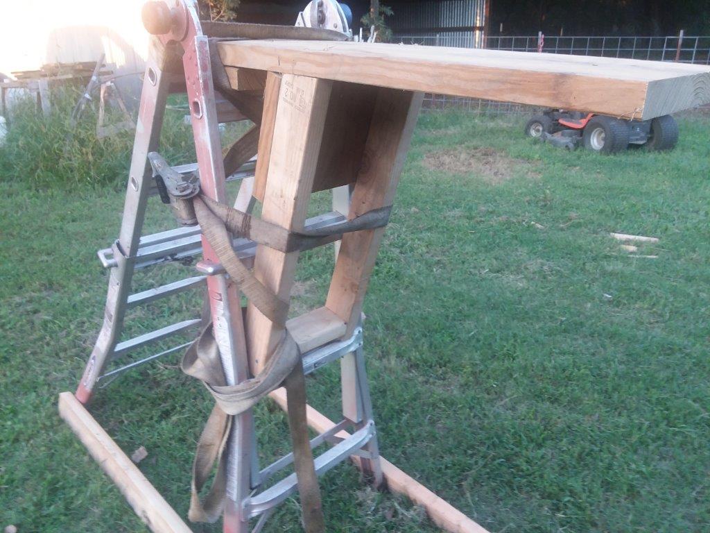

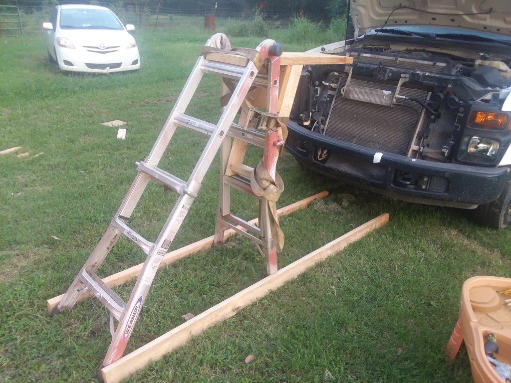

    I was thinking about building one that is just way over the top but I really needed to get some maintenance done. I came up with this idea with a few 2x4’s and about 5’ scrap 2x12 and a 13’ multiladder that I had.

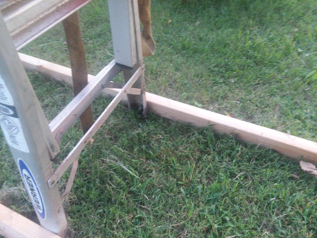

    I set the ladder to where the legs made a 90* angle to the floor. I drilled some holes in the bottom of the ladder legs to attach 2x4’s for stability. I set the 2x12 across the top steps and made a support that rests on a step. I also drilled some small holes in the top step to screw the 2x12 to the top step of the ladder. I then used a ratchet strap as a safety in case the screws were inadequate. This was quick and dirty and improvised in about 30 minutes.

    Cool Idea Imabass! Your device would be good for working on Tall 4x4's too! Perhaps adding some sort of lipped tool/parts tray would be handy?

    I plan to build one that is more substantial and user friendly but that takes time and I am in short supply of time. I was thinking about one with a 8 ton long ram jack to adjust the height. Something with substantial casters and adjustable arms forward and sideways for stability. Also a magnetic parts and tool trey would be nice.
    Since my time is in such short supply maybe I will have my wife buy me a commercial version for Christmas.
