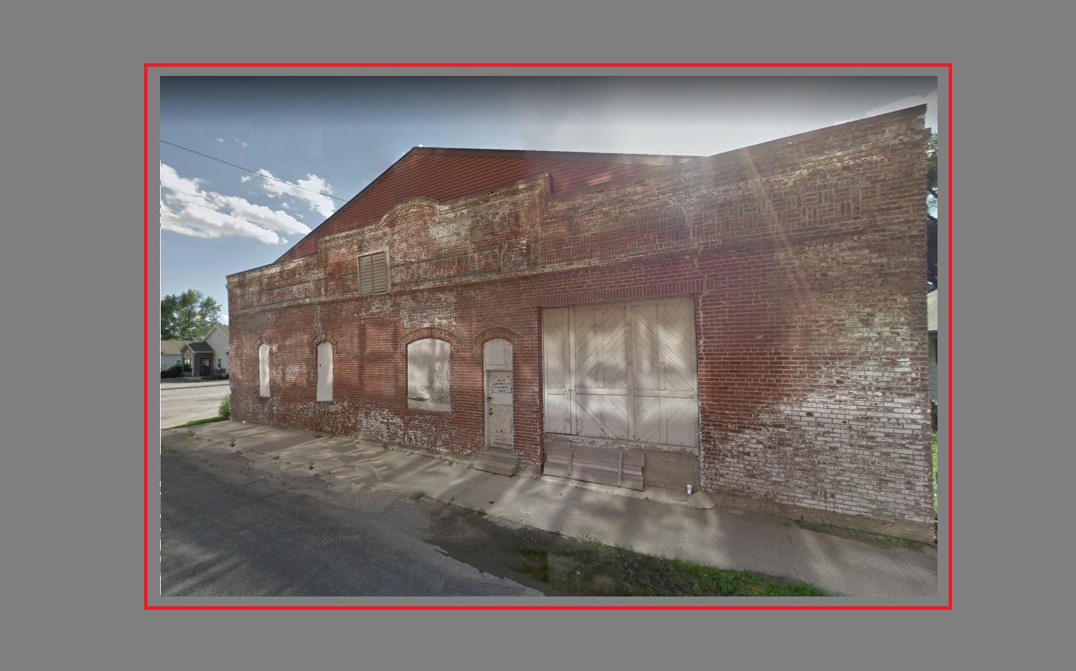

    My 1890's all brick building has two, neither operate. Both share same issue, deformed tubing track.
    One 8x11 faces south; being ideal open for worki at adjacent milling machine. Eastward, a 10x10 is a loaddock, too low for modern vehicles. There I'm considering cutting floor out, and ramp for flatbeds to enter building. That door is all oak, deserving preservation; once I solve the gap from existing floor height to grade level. The farm stores and gate hardware mfr's offer rolling door hardware. They are sized for various weight per roller, and corresponding track, which now are formed rectangular sections. Haven't found heavy-duty hardware for wood yet; estimate weight at 1200+ lbs. Creating my own is not beyond available equipment.

    Embarrassed to be unaware of Woodward's Hardware; even googled it see store front...having lived in the smackdab middle of Santa Ana for a time. All kinds of history there to be sure. Owned residence of early Postmaster Chilton 1883 [wouldn't if that name very slightly different!], and surrounded by all kinds historic residences.
    Frank's link to rolling door hardware will benefit many HMT'ers; sizes, capacity, mounting specs...you know, comparison shopping and all. lol.
    Funny thing, the internet. I'm sure Woodward's is a retailer, not manufacturer, judging by picture supplied. Usually a search limits itself with too specific wording. Apparently I kept clicking retail sources, as consumers we are accustomed to that. Most nicer looking than heavy duty; decorator vs serious use. Don't recall ANY with a 4400 lb rating! That approaches weights of good sized fire doors - inclined track, counterweights, fusible links and all.
    Depending on what is sought, many items sort faster from the bottom up "manufacturers of......" for example instead of "rolling door tracks". Also a good idea to dump cookies regularly. Make sites work for what you want - not what needs sold off.
    OK. Now how about gap that will result by cutting floor out and pouring a concrete ramp? Door now rides just above floor, around 30" above grade, inside foot thick wall directly next to sidewalk. Really want to preserve the oak door, but a 30" gap isn't very secure IYKWIM. Largest vehicle is 10 wheel 22' 54k flat bed.

    the 30" gap is the easy part just hinge a drop down with large cane bolt locks on each end the leaf could be hoisted up to lay against the door by a windless or spring system like that of a garage door mounted on the door itself so it moves with the door, make the drop leaf out of barn wood if you wanted
    I've done similar at a business in ST Louis many years ago the building was the old Carter carburetor factory the door may still be there

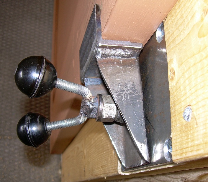

    Update: Completed the door lock this morning, serves two purposes, locks the door and clamps the door frame to the building frame to resist things like wind gusts. The door stop and retainer do a similar job on the other side of the frame. Very heavy duty and easy to apply and remove, just turn a screw.

    Neat do you have a way that you could add a grease cup above the nut and drill a small hole in it to lubricate the threads
    repeated use will wear the threads
  12. #10
    11,716
    2,228
    This would also be a good application for a cam over lock
