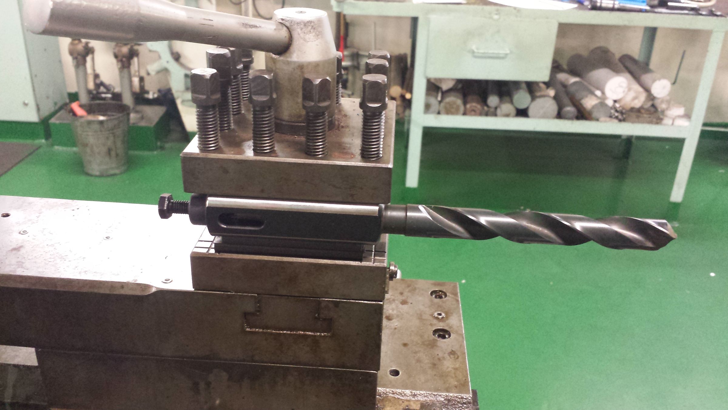

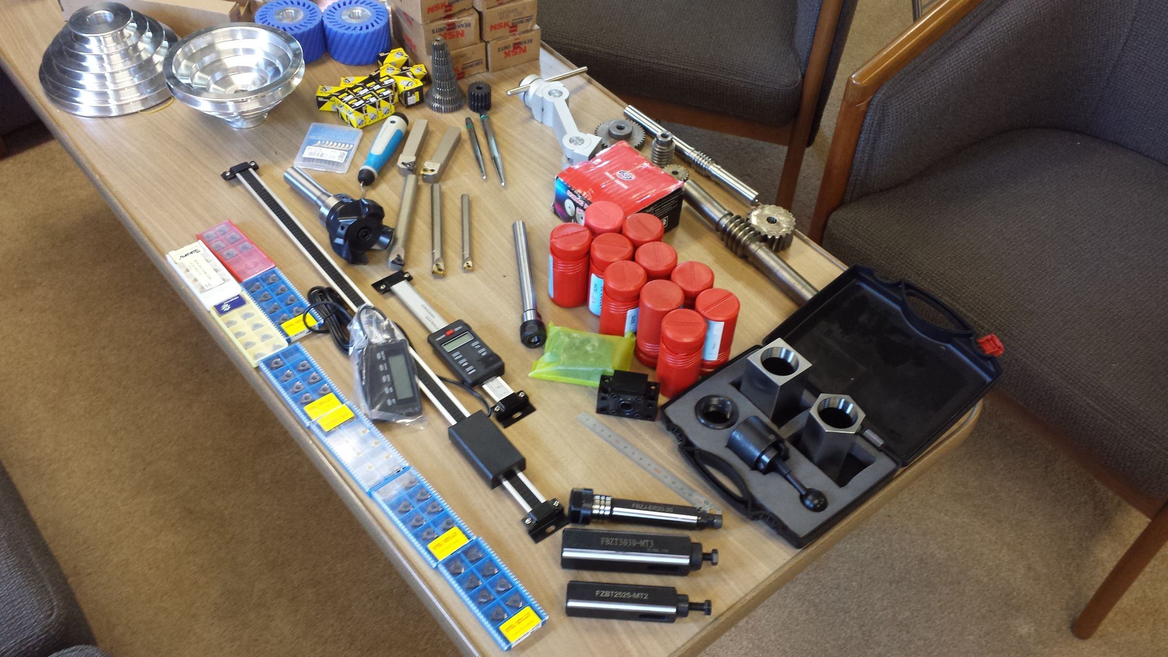

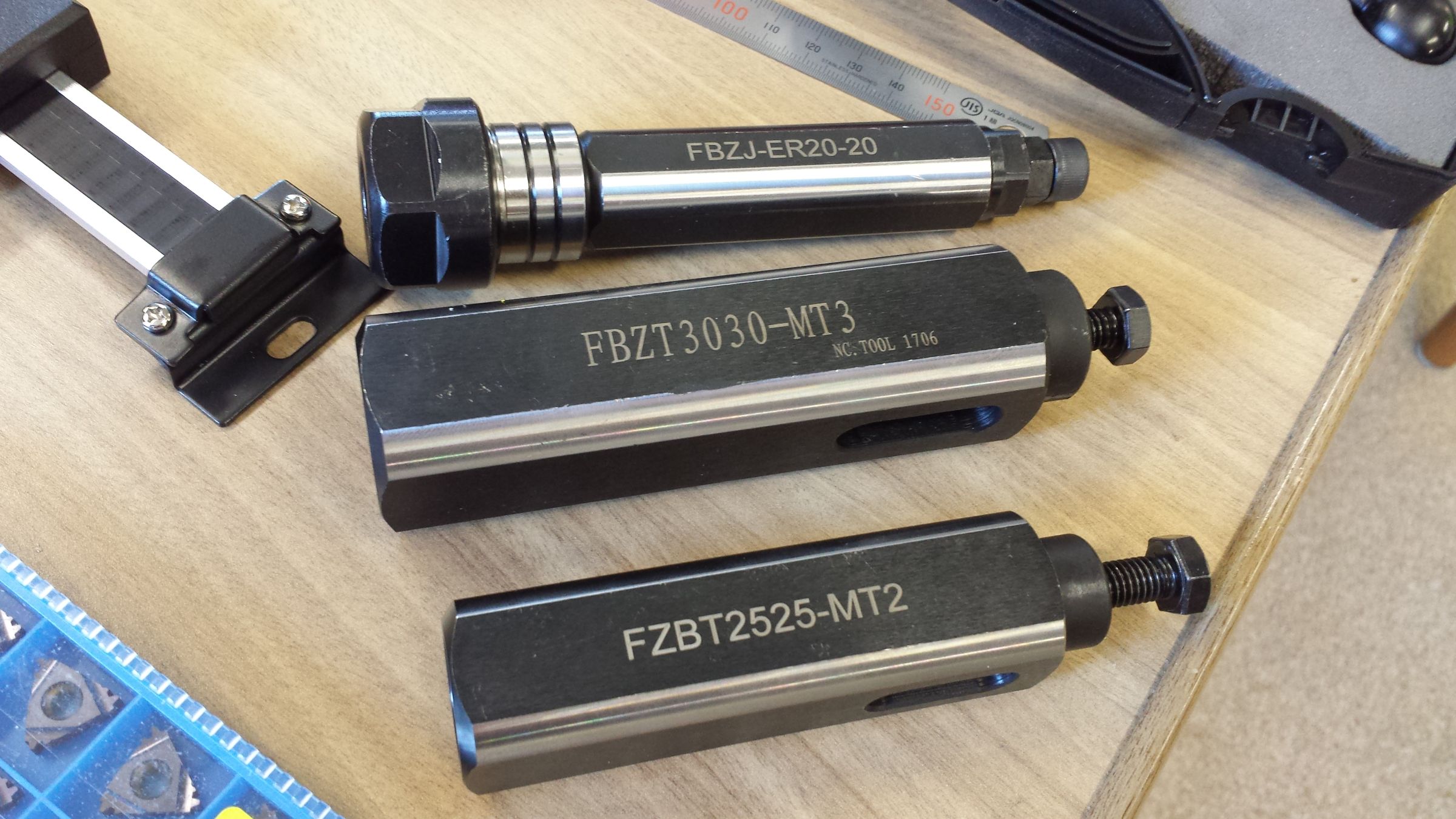

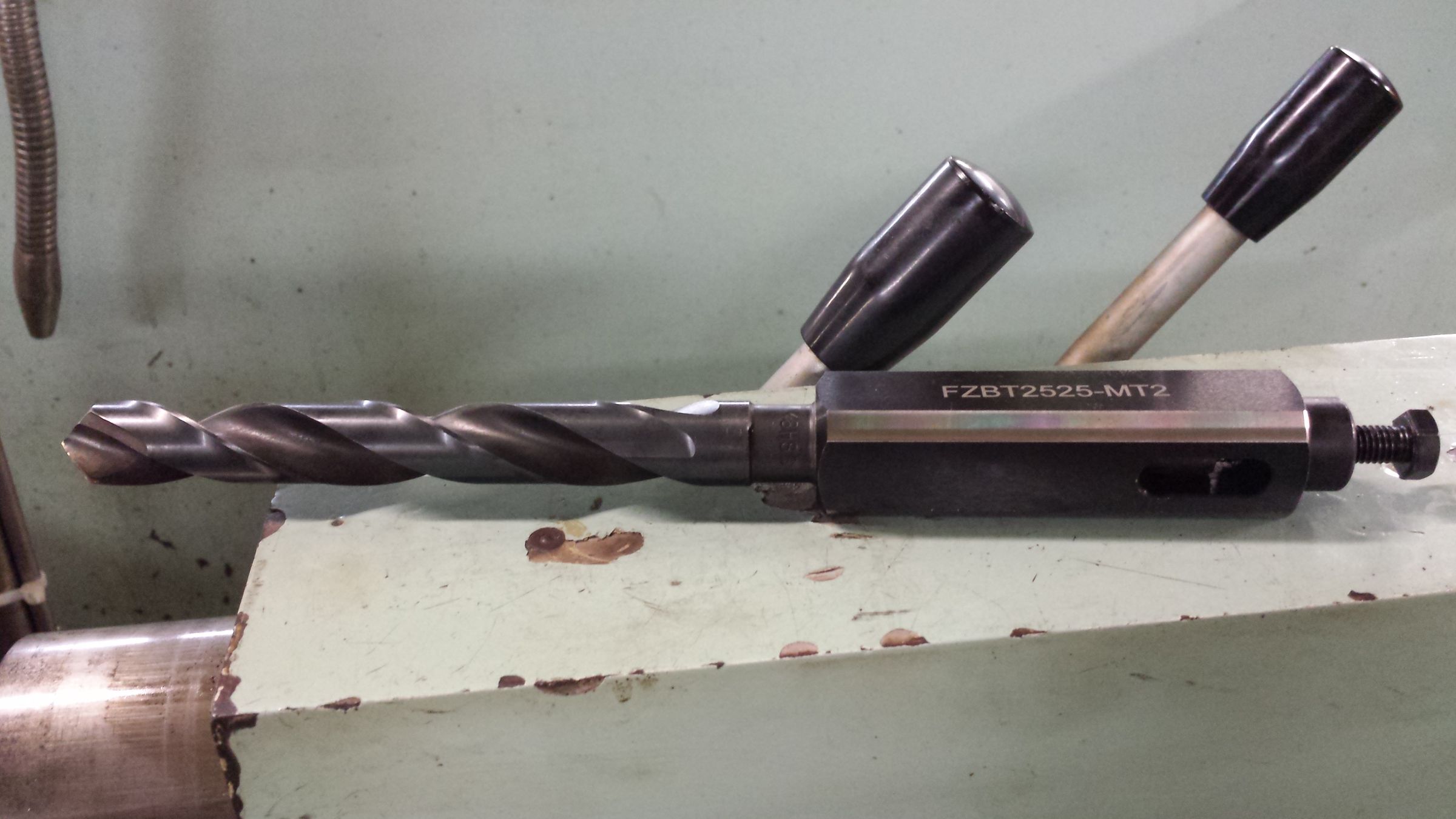

    Here are some tools which I recently bought and for which I didn't know they are even existing.
    Discovered them by pure luck when searching at www.taobao.com for something else related
    to lathe accessories. Of course I am cheap and I am buying tools in China, but some of these tools
    are decent quality tools. I still can't find these holders anywhere on the web except at taobao.
    Have no idea are they FBZT or FZBT morse shank tool holders, but have already tested them and can't complain.
    FBZT3030-MT3 for larger morse taper shank twist drills and also for my MT3 drill chuck
    FZBT2525-MT2 for smaller drills
    FBZJ-ER20-20 for small straight shank drills and end mills
    All these tools will be used in my 4-way tool post for deeper holes drilling as my tailstock quill
    travel is only 65 mm.
    This tools are very simple to build, but for the price of 10.52 + 12.03 + 1 USD shipping
    I decided to buy them. Also don't have time for that as I already started with my next project -
    external spindle gearbox for my lathe. (original idea was to make 16 speeds "beltbox").
    Hope that many machinists will find this post helpful.
    Best regards
    LMMasterMariner
    1. Holders on the table in my cabin (observe FZBT and FBZT - same manufacturer, unbelievable)
    2. Some of the tools received couple of days ago (some more received but not shown here)
    3. FZBT2525-MT2 in 4-way toolpost (observe some free of charge materials in the background. plenty
    more at other location.)
    4. FZBT2525-MT2 on top of tailstock
    Attached Thumbnails Attached Thumbnails Toolpost Morse Taper Shank Tool Holders-1.jpg   Toolpost Morse Taper Shank Tool Holders-2.jpg   Toolpost Morse Taper Shank Tool Holders-4.jpg   Toolpost Morse Taper Shank Tool Holders-5.jpg

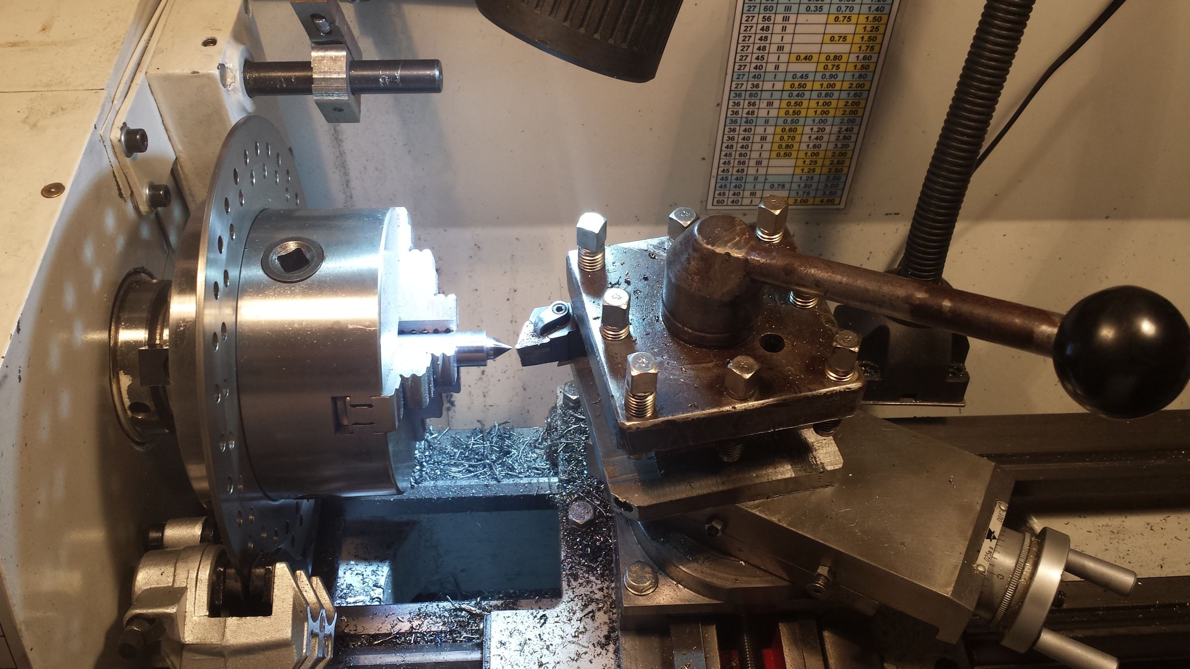

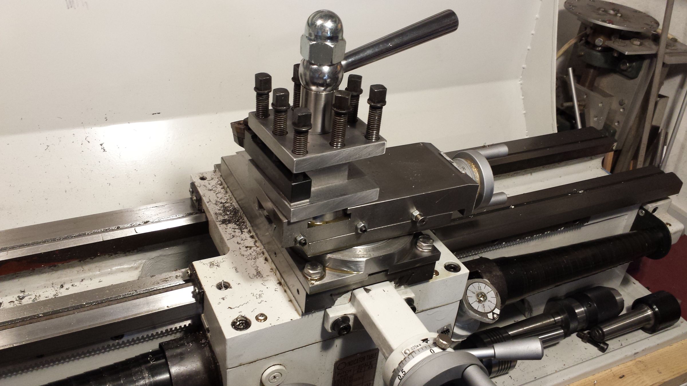

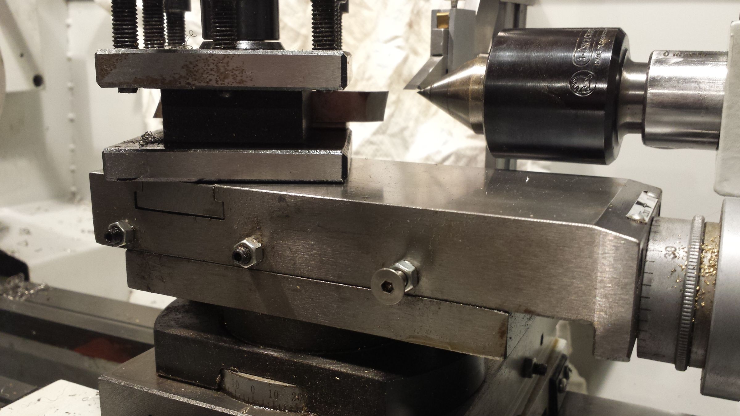

    I also wouldn't be able to use these holders in my original tool post, but I can do it now after couple of tool posts upgrades.
    No. 1 - Original tool post
    No. 2 - First upgrade
    No. 3 - Second (last upgrade)
    Didn't see R8 tool holder for tool post there.
    Best regards
    LMMasterMariner

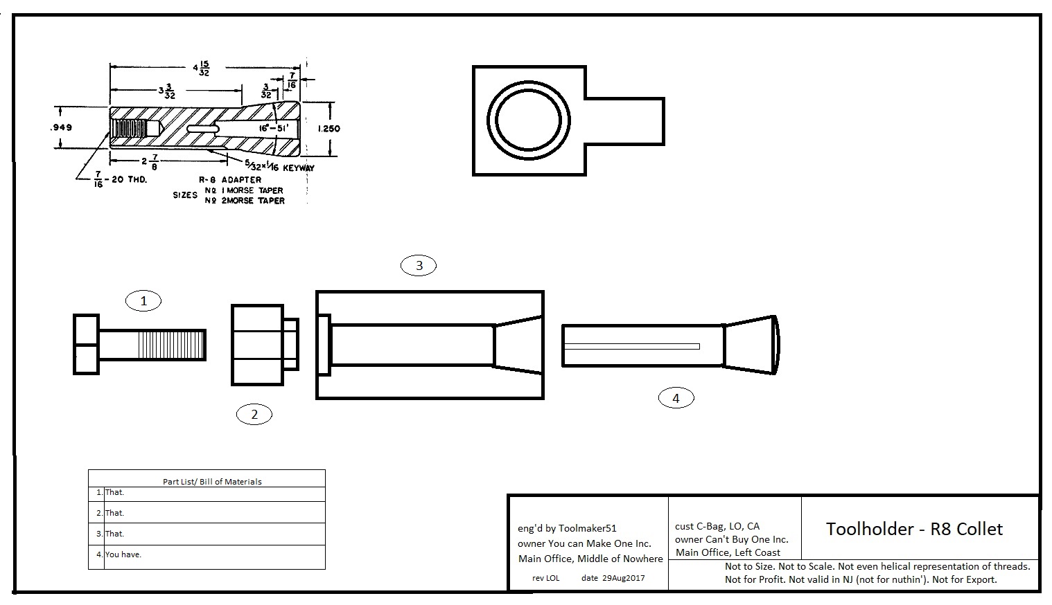

    QC R8 Toolholder
    Very interesting. Quite a haul of stuff on the table too! I also looked on the taobao link and not speaking Chinese would make it impossible to navigate. I would not be able to mount those adapters in my tool post, but it makes me wish they made index holders like that for R8 collets. Thanks for posting.
    You could reproduce the R8 contour in flat bar stock if your lathe has 4 jaw and compound for the 16' 51'' included angle.
    Best would probably be off-centered to allow milling a 'spline' that fits your toolholder.
    Bore through for a good fit on collet body, counterbore to receive washer.
    Make a drawbolt and thick washer with corresponding boss slip fit in toolholder. A square-head bolt offers better life span.
    I'd make 3. 1 w/ center drill. 1 w/ small drill chuck. 1 w/ R8 bore.
    Bingo.
    Unless you have a lantern toolpost.
    Last edited by Toolmaker51; Aug 29, 2017 at 08:27 PM. Reason: Part List - Bill Of Matl's

  11. #9
    11,716
    2,228
    Excelant drawing TM51 I have added it to my to do list not that it was getting any shorter LOL
  12. #10
    5,338
    7,048
    Thanks to Frank S and C-Bag, who responded offline. Until I purchase a decent PC, I've no access to a CAD program. I use MS Paint. It's easy to use, just takes a procedure, as it doesn't 'know' dimensions or scale per se. It does relay an equivalent to X Y coordinates that helps size or represent 'mating parts'. It also copy/ pastes nicely. For example the R8 print is direct from the web, just googled dimensions of R8 collet. I knew the included angle, used that to assure a more correct drawing was found. 100% or 1:1 is possible too (even larger to a limited degree), all depending on part and monitor size.
    For anyone interested, I'd prepare a drawing sequence with limited notes. I fully believe picture is worth a thousand words adage. The volume of text increases when your talking pixels, lol.
