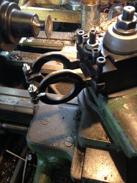

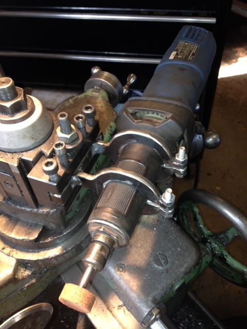

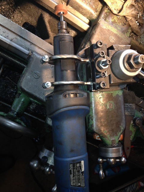

    I needed a tool post grinder to back-cut some valves so today I made a mount for an electric die grinder.
