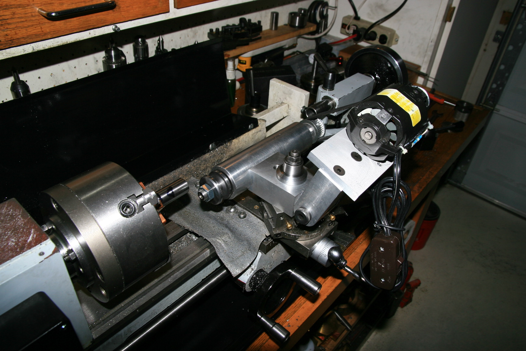

    Built one for the mini lathe
    Hi Doug, thought you would like to see my version of your excellent tool post grinder.
    I had to down size it a bit for my little lathe.
    Cheers, JR

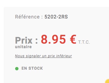

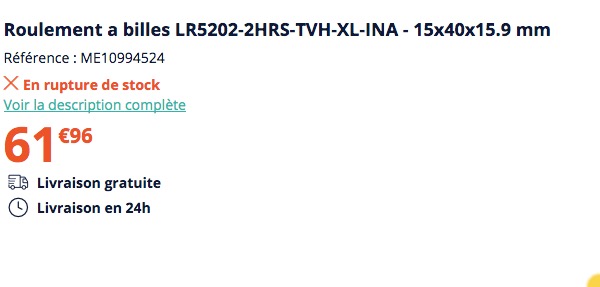

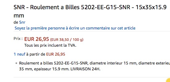

    Thanks for all this information about those important tool, what do you think from the difference of prices/quality between the stores with the bearings, have you tested why this is so important, personally I'm using those in the middle range but do the cheaper function in your opinion?
