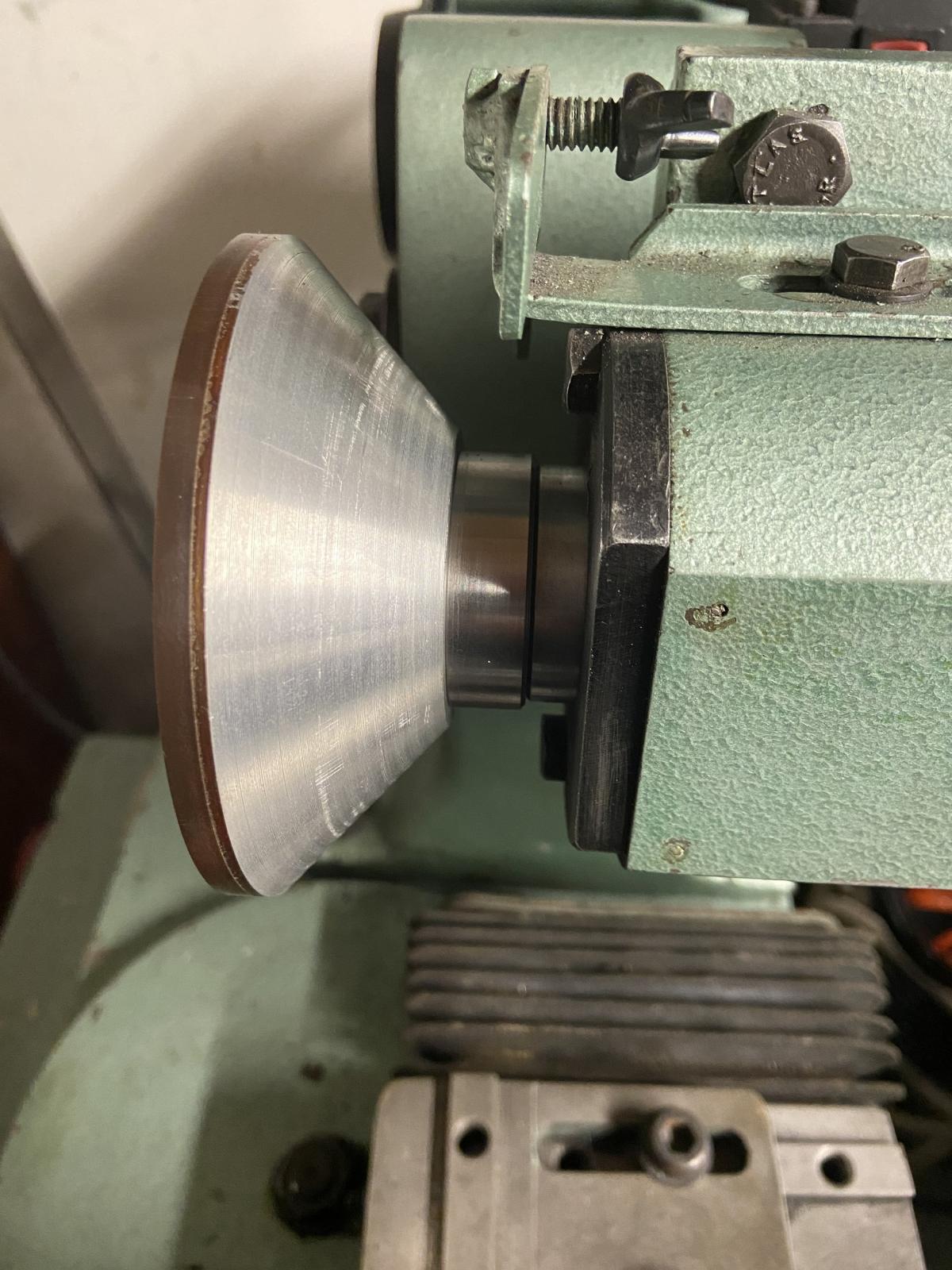

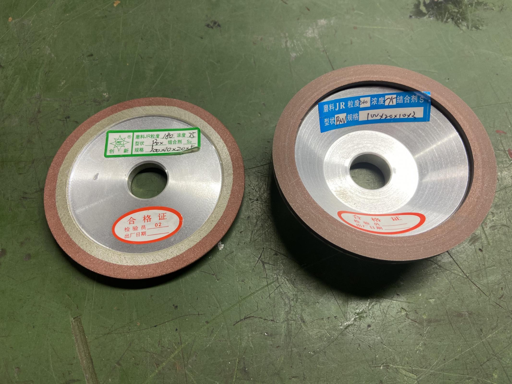

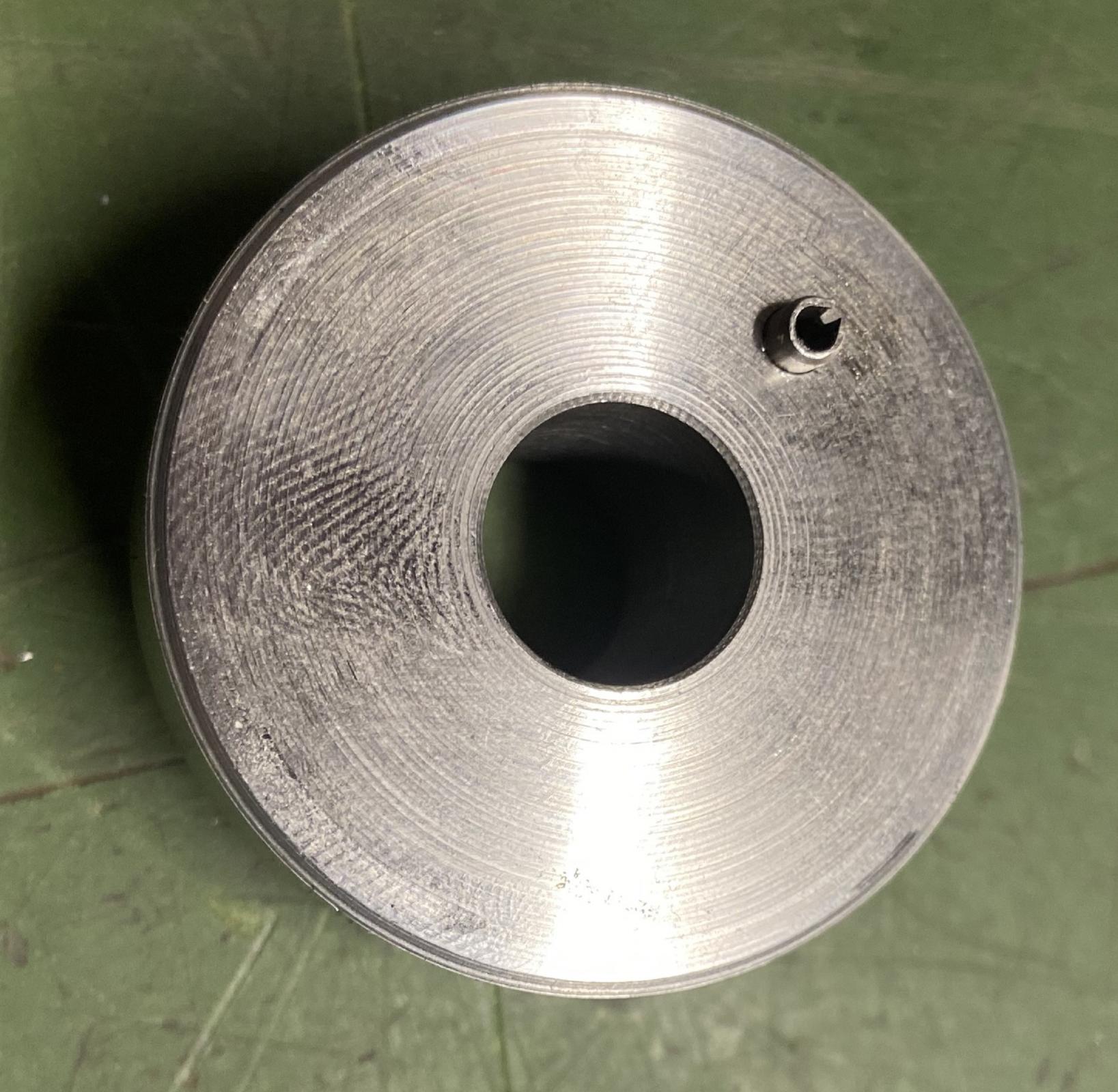

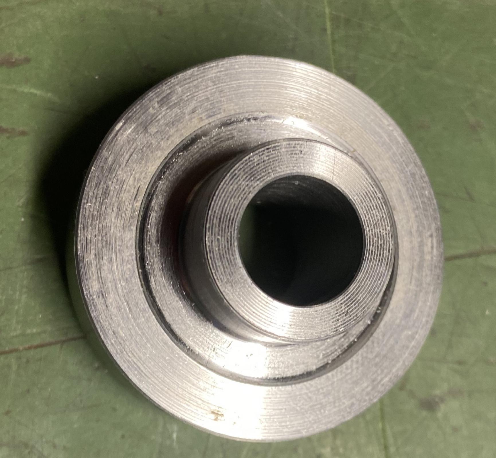

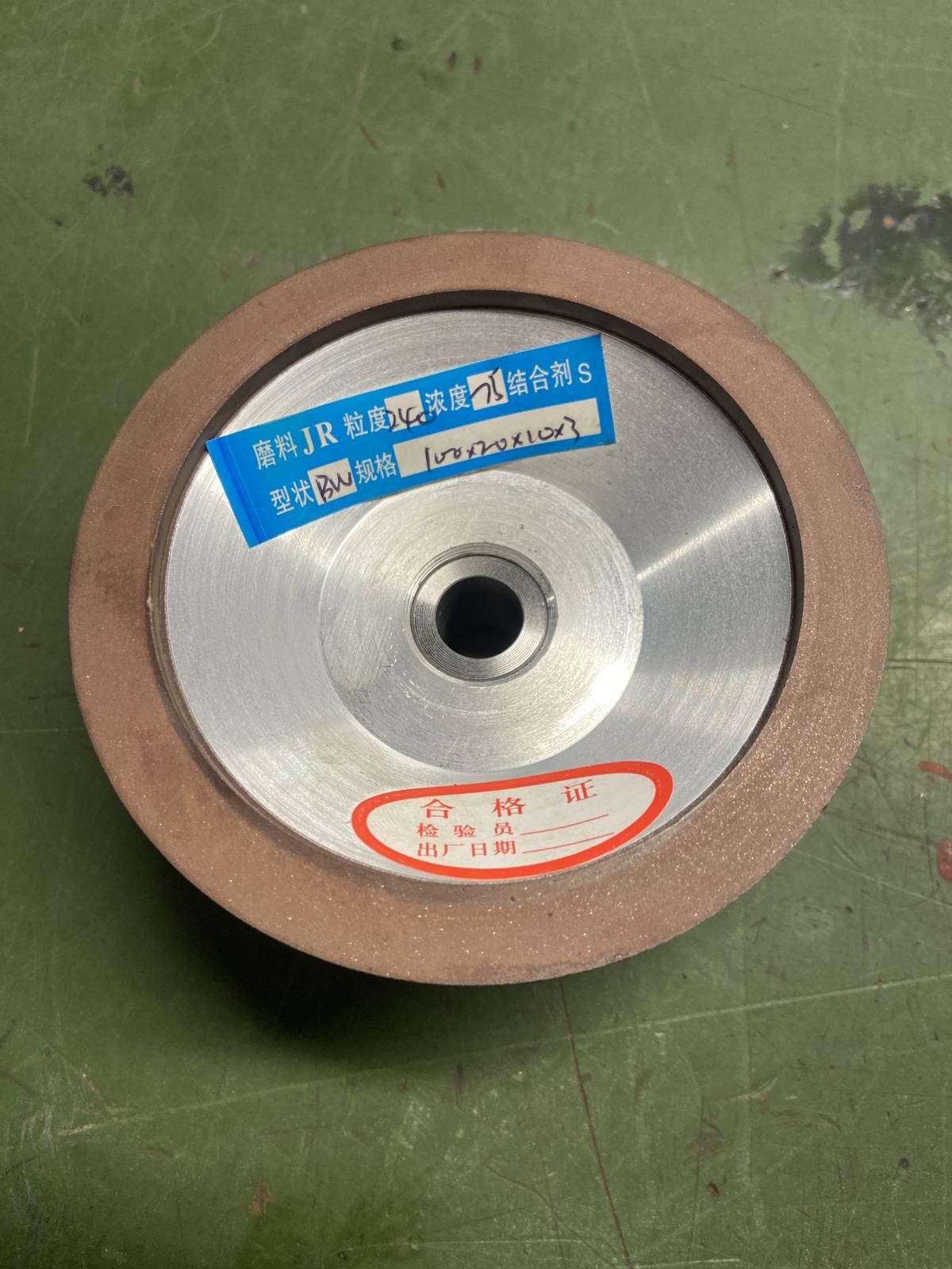

    Hi All
    I bought some cheap diamond stones from China for my tool and cutter grinder but they are supplied without plastic bushings. The wheels are 20 mm diameter and the grinder shaft is ½”. I have been working on a project which needs some special cutters making, so at last I have had to make a bushing so the wheels can be mounted on the grinder. I could have sourced and purchased some but a 20 minute job to make one from steel I couldn’t see the point.
    This is a very simple turning and drilling exercise and will last.

    Photos below show bush and grinding wheels
    Diamond wheels
    Tool and cutter grinder stone bushing-img_4552.jpg Tool and cutter grinder stone bushing-img_4553.jpg
    Front and back view of bushing

    Wheel mounted on bush
    In place ready to use

    Hi Ray
    Thank you for your interest. The wheels are standard wheels you can purchase from EBay. These are suitable for tungsten carbide. I paid £21 for 3 deep cup wheels and £12 for 3 cup wheels. So these are not dressing stones as I think you are after as in dressing a diamond wheel?
    I hope I have this correct
