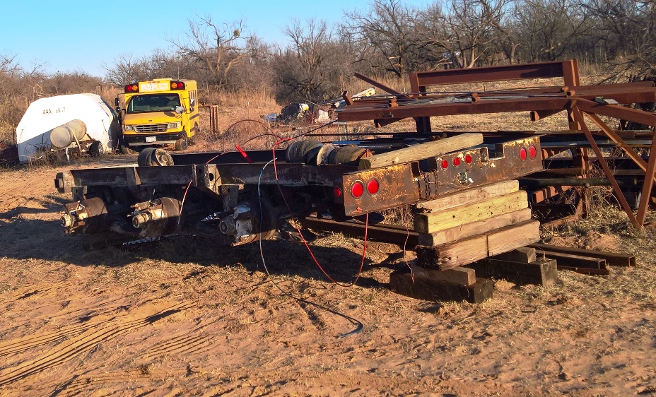

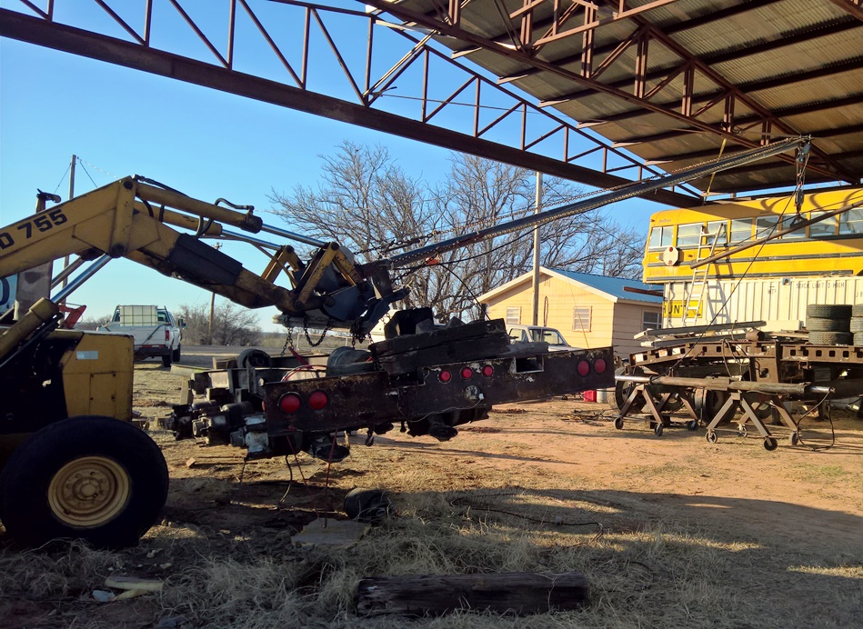

    Could chassis be moved better from front; a heavy [2 5/16"] trailer ball on forklift or frontloader, lifting front end so wheels aren't contacting ground? Maybe pull tires and weld up a landing gear?

    it could providing there was room between where the shop is and where I have my vehicle detention center that I call the dog pound because there are more Mack bull dogs than other critters Also that pencil sharpener is sitting smack in the way of things
    Right now it would be difficult to use the receiver on the fork carriage of the front end loader due to having the gin pole and hoist on it. My duel wheeled fork lift spends more time buried in the ground than rolling it is barely maneuverable around as long as I can remain on the area where I have hardened it up with the select fill clay drive of the edge of where that is and it sinks to the frame. hence the pushing and pulling from the rear
    one helper who could either drive the pickup or could steer the bus while it was moving would have been a big help.
    Jane won't drive the pickup because the size of it and having to push or pull the bus chassis scares her and she surely is not strong enough to steer the bus.

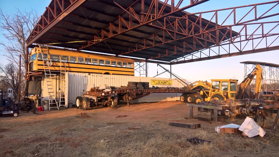

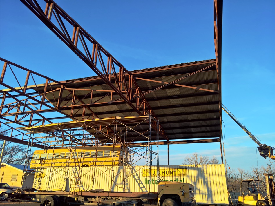

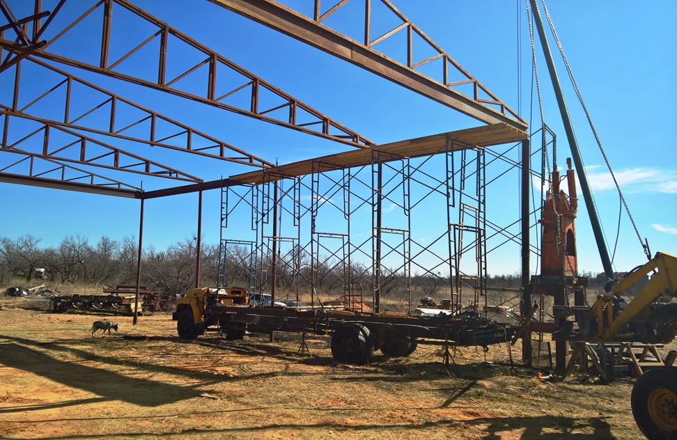

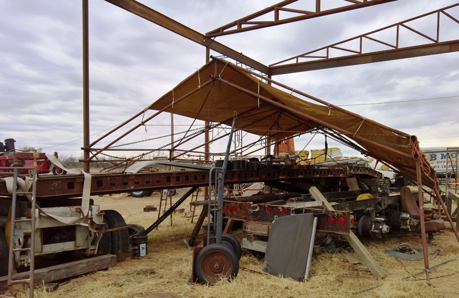

    Even after having to take time to change a tire then go to town get fuel have the tire fixed and a few other go to town things that had to be done.
    I managed to get 4 purlin installed today these area at the highest part of the trusses so my scaffold was more of a its there as a fall stop than anything else since the center of the trusses are over 6 feet from the bottom of them it meant climbing on them and working while standing on the braces or sitting on top of the truss to weld them in place.
    Took the first step towards building my shop-wp_20191226_17_07_00_richcv.jpg
    This puts the to the point of either doing the back half of the same side or moving a lot of stuff to do the other side. Or going ahead and sheeting what I have to give me a 30 ft by 36 ft roof over head. On the one hand having a partial roof would be better than no roof but that means having to change up what I am doing. IT would mean I would have a completed area to put the project that is currently under the tent though and the tent has to come down soon anyway. Heck I have almost knocked it down already.
    But I think I will carry on and install the other 10 purlin on the second half of the side I am working on then sheet the whole half then move everything from the other side and not have to take a step forward while taking 2 backwards.

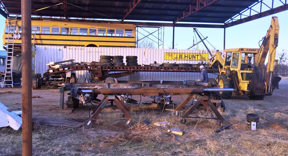

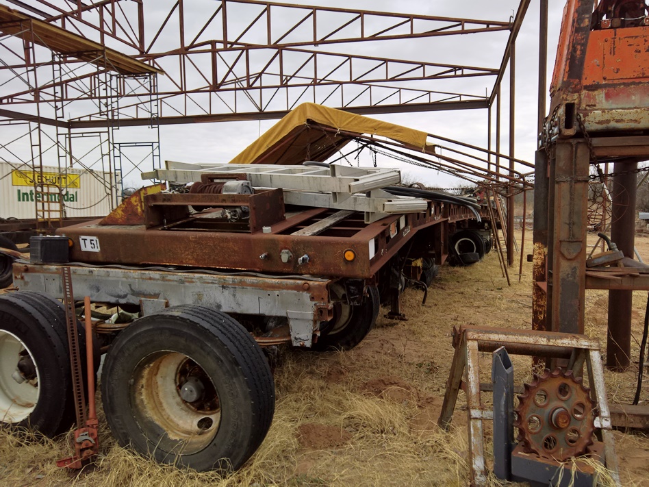

    The stuff that needs moved is the 3 axle set currently under the tent and the 50 ft trailer that I have on dollies and can only be moved sideways

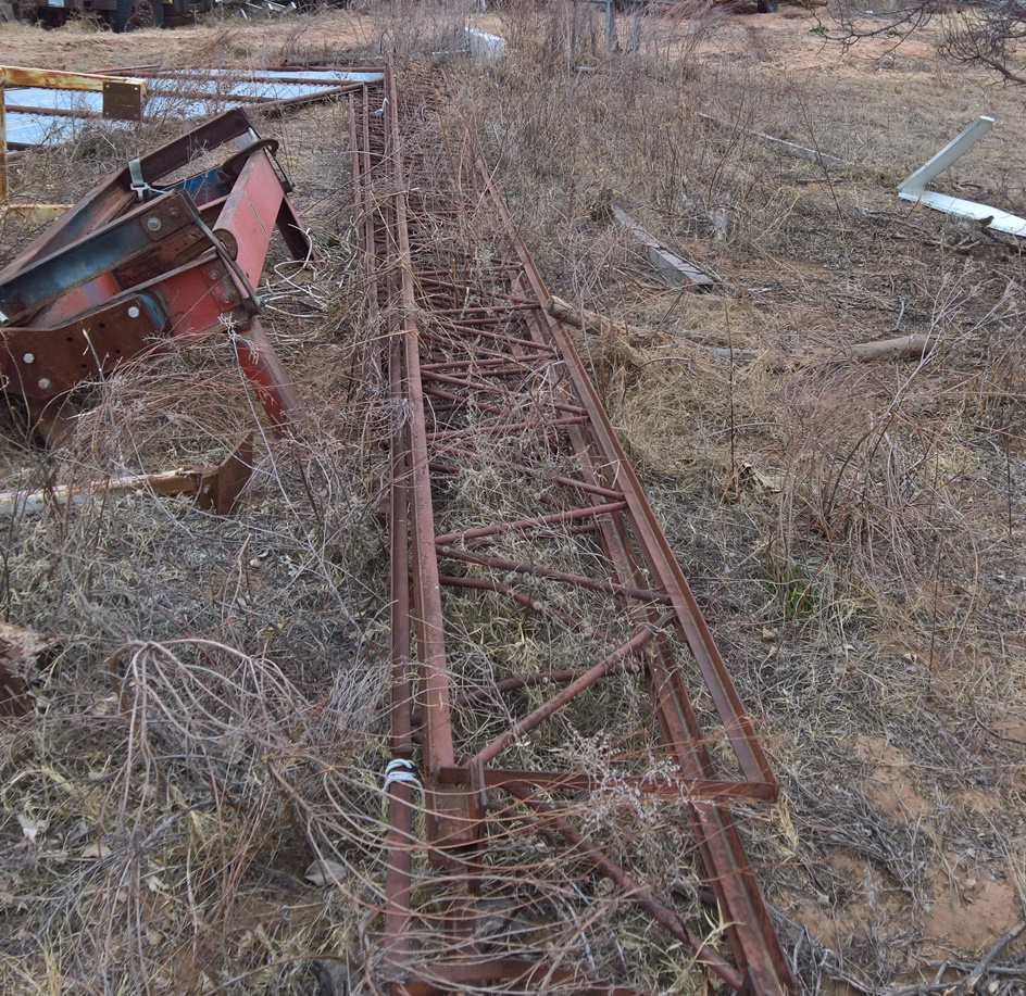

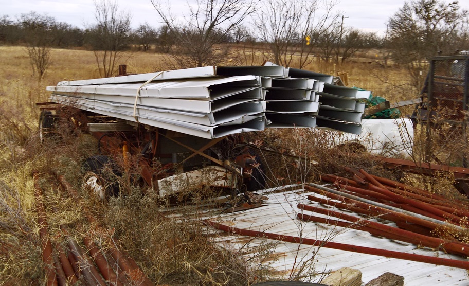

    Once I finish with the roof these bar joists will be used to make a 30 by 40 lean to on the south side of the building
    Took the first step towards building my shop-wp_20191226_17_14_05_richcv.jpg

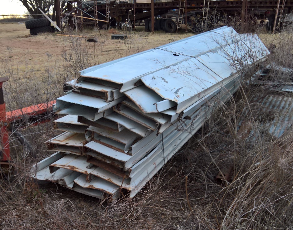

    these white standing seam panels will be the roof of the lean to.
    originally the bar joists and the panels were used as a cover for a large RV
    I have almost enough panels to make a 30 ft wide lean to the full length of the building

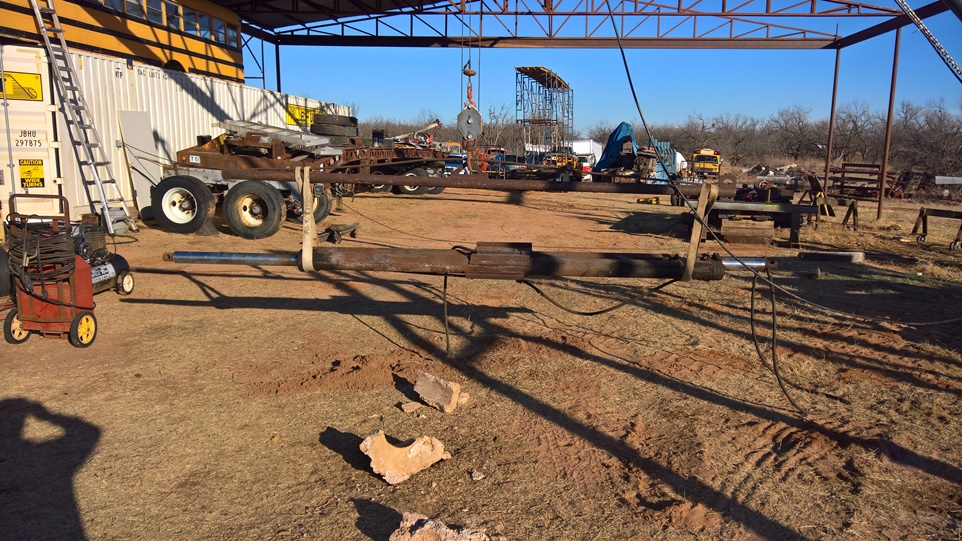

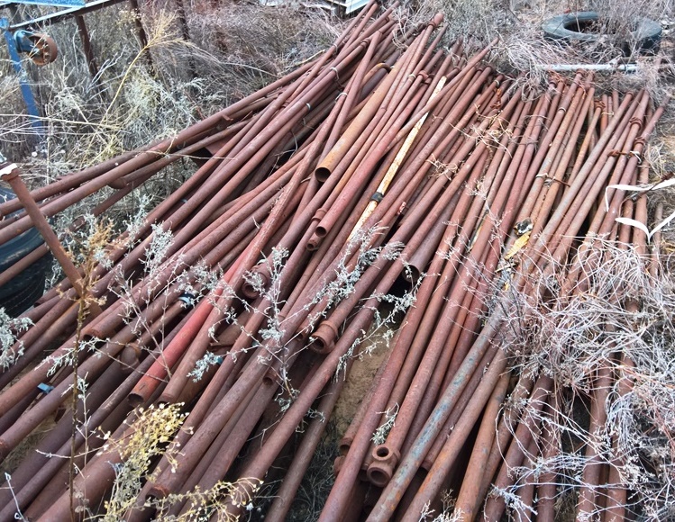

    This pile of pipes is what I will be using to run my air system throughout the shop I have close to 2000 feet of 1 " 1 1/4" and 1 1/2" pipe in that pile with a smattering of a couple hundred feet of 2 " & 2 1/2" pipe more than enough to plumb an air system with.

    A lot of pipe! Run a branch to St. Joseph? I'm not a big consumer of compressed air . . .
    Maybe I can find an unfracked reservoir in OK or southwest KS. Never mind, you are busy enough.
    Actually, I have a 3ph dual voltage 80 gallon upright and 60 gallon reservoir, in opposite corners. One for quiet, one where the action is. PLENTY!

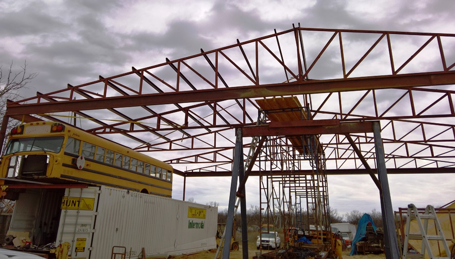

    I knew those clouds in the sky yesterday were not going to be friendly to my quest. Sure enough woke up this morning to the sound of moisture trying to fall from the sky. A Foggy drizzle just enough to make it less than appetizing to weld with an AC stick machine
