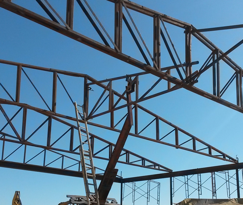

    Today another rare no wind day so I thought it might be prudent to secure the center of the truss before the winds start howling from the NE next week.
    The quickest and easiest was to utilize a section of a remaining left over truss. Surprisingly it took longer to install it than it had to get the truss in place yesterday. I have another section which will be used to connect the center truss to the 4th truss just as the center is connected to truss #2 . However I will be setting up a rolling scaffold before I do that one since I detest working from a ladder over 20 feet in the air

    I can't imagine the fun of going up the ladder with the stinger lead. I bet #2 or #4 copper lead would be a gravity fight.
    I was up on a 12 foot ladder yesterday to clean out gutters, once my feet are over 6ft off the ground, it starts to become enough to instigate self protection protocol.
    Scaffolding at that height would be too scary for me. The aspect ratio of foot print to height and bouncy planks with no guard rail, would exceed my sanity check.
    Has to be a good feeling to be at this stage of the assembly.

    I'm not vertically challenged in the least but I am very vertically cautious. The stinger lead is #0
