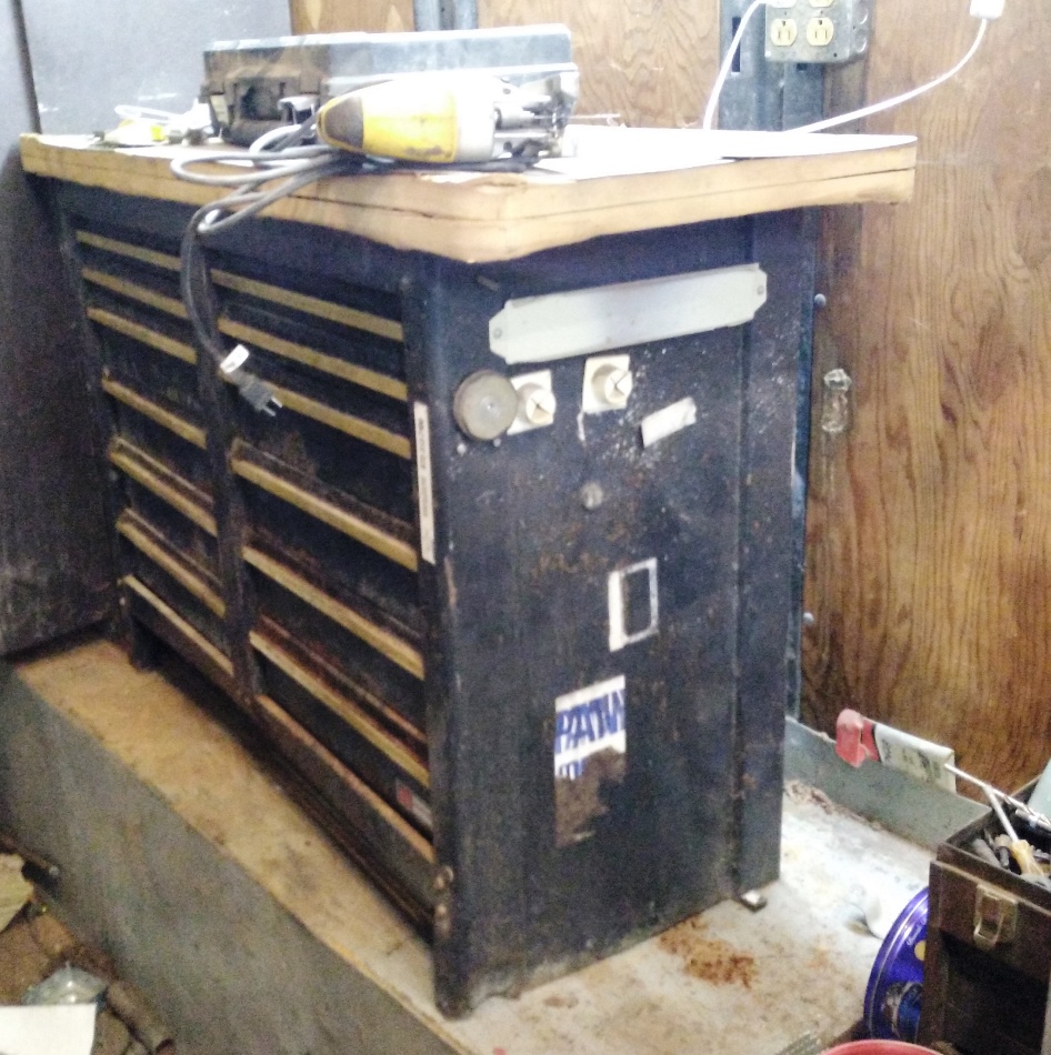

    Inside the machine shop van of my shop always seems to be a sore spot for me the way I had some of the cabinets and storage units were always over cluttered, No matter how I tried to arrange tooling for either of my lathes when I needed this or that I might have to spend a lot of time searching for the item. Plus it seems almost daily I have been adding more tooling to the menagerie, which ultimately winds up creating more clutter or filling already over filled drawers
    Yesterday it was windy with the windchill in the low teens so I sought refuge inside my machine van. I had the temperature inside of it up to around 60°f while trying to trun some parts I started searching for a special ground piece of HSS and couldn't find it anywhere. Finally I said enough of this I'm going to re arrange a few things so I can have some suitable drawer space
    First I had to clear an area at the end of my workbench then I moved a storage unit that is filled with stuf that really needs to be relocated to the parts and bolt van but that will have to come later.
    This cabinet was actually limiting my space in front of my bench mill and has always been in my way
    Took the first step towards building my shop-wp_20200911_18_34_54_richtb.jpg
    So I moved it to the end of my workbench which now is at the same height and extends the work bench

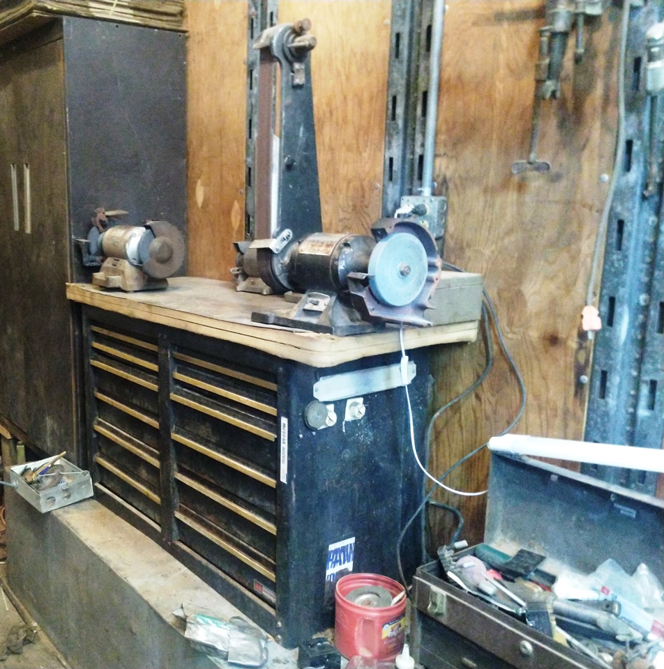

    Moved the tall wall cabinet about 3 feet West as well
    then put the bench box here
    I don't know where the grinders are going to wind up, but they are kind of handy right where they are. I still have a long ways to go to be able to create a location for each like item of tooling but it is a start. 1 drawer has my HSS (I still haven't found the one I was looking for), and reamers another has pipe taps and those recently bought extra fine taps and dies "I am going to have to make a special divider system for them later" Another has metric taps and dies

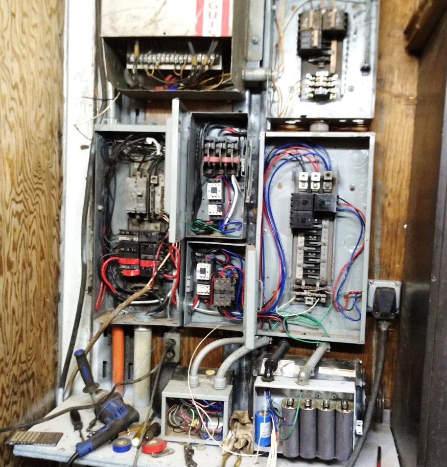

    The last couple of days I have been stealing time from myself to work on getting my 2nd RPC built and hooking up the 9KVA transformer for the 460v At the same time getting all panels closer to being able to install all of the covers The single phase main panel has 1 more temporary 220 line to remove then that panel can be closed permanently, the breakers with red tape are not to be switched on until other things are completed, the transformer is ready to have that cover installed after I get the phases of the 2nd RPC to a balanced output. I can close the door on the main 3ph disconnect now and the encloser below it as everything that is going to be needed in those is complete. I need to connect the magnetic contactor to a breaker and add a 24v transformer in the 3ph 240v panel "bottom right" then that one can have the cover put on I don't have any conduit run out of the 3ph 460v panel "top right" as of yet so no need for the transformer to be switched on until something is connected for it to power.
    I am thinking about not installing the capacitors in the connection box for the larger RPC but rather install them in a much larger separate panel to be mounted below the shelf due to my calculated number of capacitors needed to get proper output. By installing them in a larger panel is will also have enough room to add more capacitors should I require another idler motor later on.
    All single-phase 120v lines are black #2 lines for 240v single phase are RED all #3 lines for 3ph 240v are blue and the 460v line are BOY #1brown $2 orange &#3 yellow. any neutral lines through out are white and the bonded grounds are green

    Nice panel work.
    So do you have an auto start system for when you need the RPC running? Something that senses you turning the switch on at the machine, or remote start switch.
    I had initially used that to power my vertical mill, but the noise of the 3600RPM idler motor, and that it was on the far end of the shop drove me to use VFDs.
  13. #400
    11,716
    2,228
    Nice panel work.
    The RPC is activated by a magnetic starter with overload protectors and a 120v coil initiated by a simple wall mounted switch below my light switches
