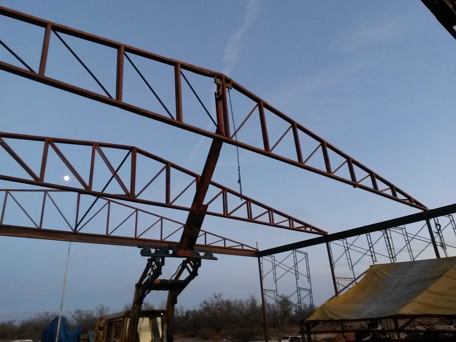

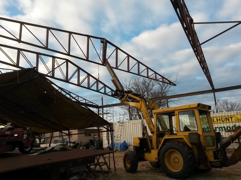

    At around 4 PM this afternoon the wind died to dead calm we got 2.7 inches of rain yesterday so no possible fire hazard to the dead grass around the shop.
    The wife was doing something in the house so I knew I wouldn't have to put up with her objecting my deciding to set the truss since I had already been running the backhoe and she would be paying no attention to hearing it.
    I put my fork boom extension on that I had made special for this task then raised the truss in place with the help of a palm sized chain com a long and a couple of large C clamps it was ready to be welded in place. This may have sounded easy but I had to climb the scaffold several times and go on top of the container several times to accomplish the task but it just goes to show that what I had been telling all my friends that these trusses could be installed by one person was true
    Now I am ready to move on to the next phase of the shops construction.

    Frank, you must have some eye alignment trick to put the truss up, and get the bottom to be nearly in the correct place to weld. Seems that with the fork extension holding it up, that you could slide one side to where you need it, but getting the other side correct via your tractor must have some trick involved.
    I bet you figure out how to put the purlins in without a helper.
  10. #40
    11,716
    2,228
    Metric_taper, there was no way to slide the truss from side to side as the device straddled the center support. at most I could fudge movement with my little come a long about 2 inches.
    The truss was canted slightly to one end which allowed me to sit that end down on the top plate then climb up and secure it with a rope then I lowered the other end until it just touched carried the coma a long and a C clamp up and the weld stinger. With the other end sitting firmly on the top plate almost perfectly over the column I welded the end I was working on then went to the opposite end and repeated what I had done.
    From start to finish it took a couple hours but a lot of that time was in just maneuvering the long truss up and over the things on the ground like the container and the tent where I have a trailer being worked on. then getting as close to center with the backhoe and as square to the building as possible, not easy with a machine of that size with actually limited maneuvering room when you stop to think about it. We had about as much if not more difficulty in positioning the Skytrack forklift when we set the first 4 probably more since I was not the one operating it the guy who was is a truck driver not a machine operator. and the 3rd guy helping had shoulder issues and 3 fused vertebrae in his neck preventing him form doing much more than hold a rope on the ground.
    I'll get the purlins up I'm sure. I may make some more mods to the extension and mount it on the hoe then probably remove the fence on the garden side and drive across it, no problem there since I haven't tilled it under yet
