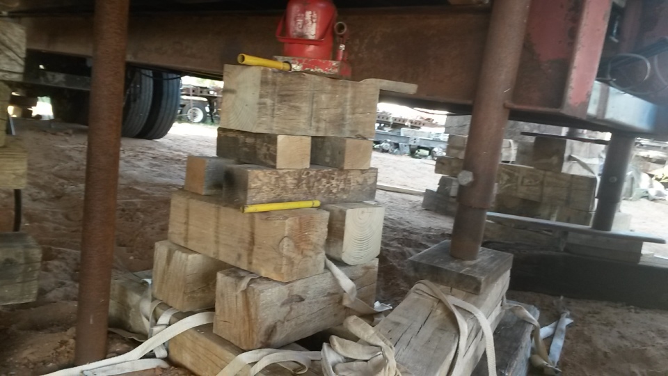

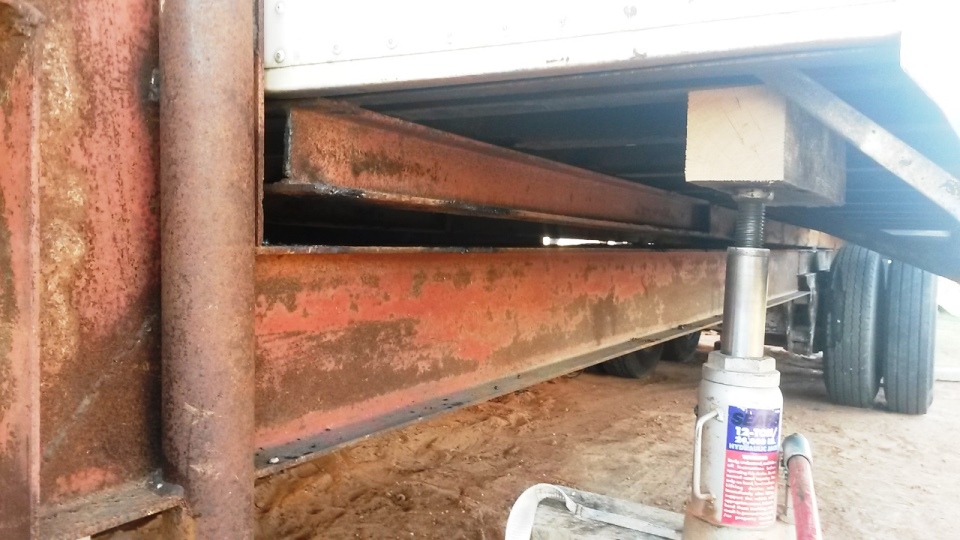

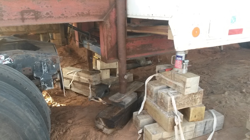

    Most of the day spent removing my not so temporary, temporary welds gouging with carbon arc and oxy/act to finally get all of them removed.
    A long time ago a guy said he would trust one of my tack welds to hold 2 sections of a bridge together I hope he was kidding but after having to cut out some 50 or 60 welds ranging up to 4 inches long I need to re visit my method of making a temporary weld.
    However they are all removed now and I did manage to begin the lift in preparation for separating the box from the trailer chassis
    It takes a lot of blocks I bet I have to use a 1/4 of my cribbing blocks on this task alone

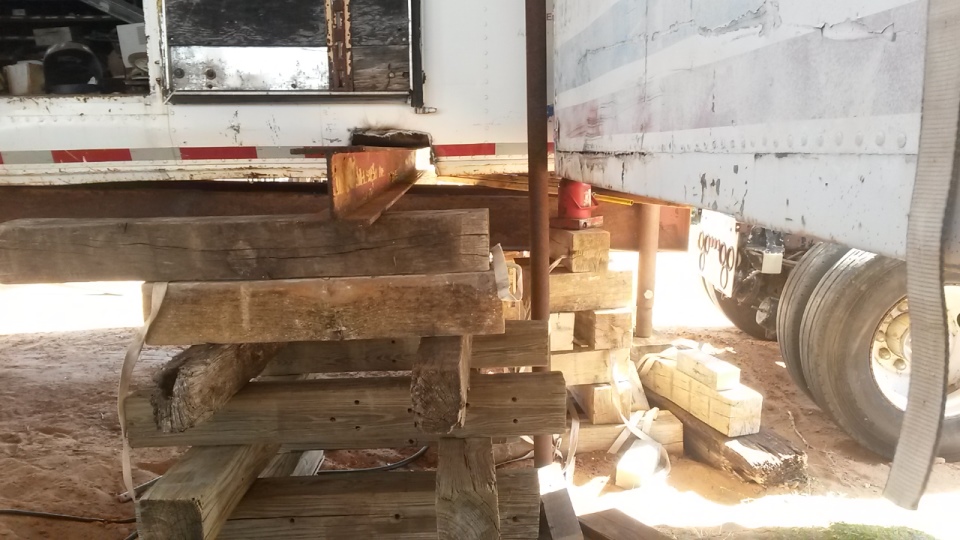

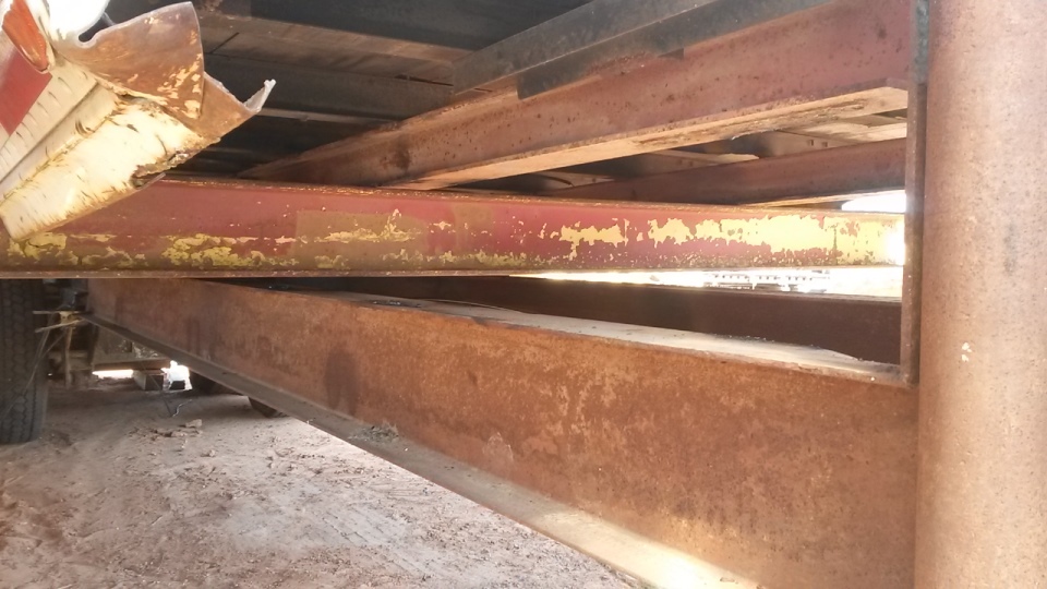

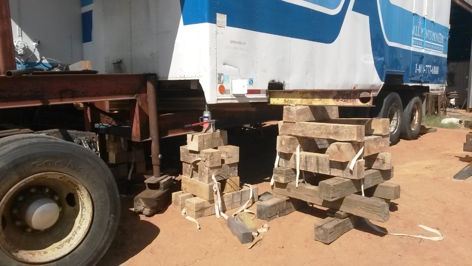

    Fully up on blocks with the beam in place now I have to remove the chassis which still could be a chore
