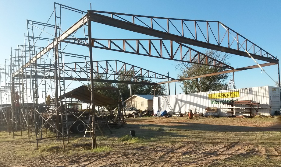

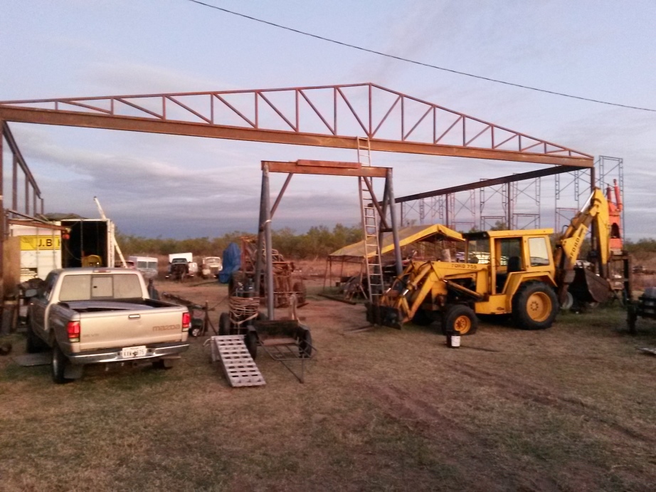

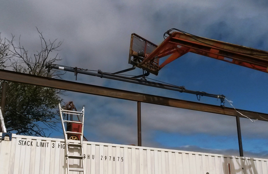

    A little better progress today even thought eh wind was 20 to 30MPH most all day

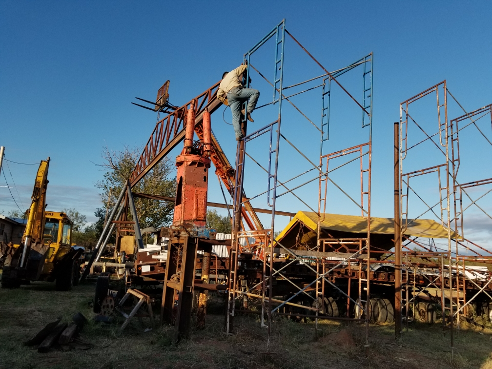

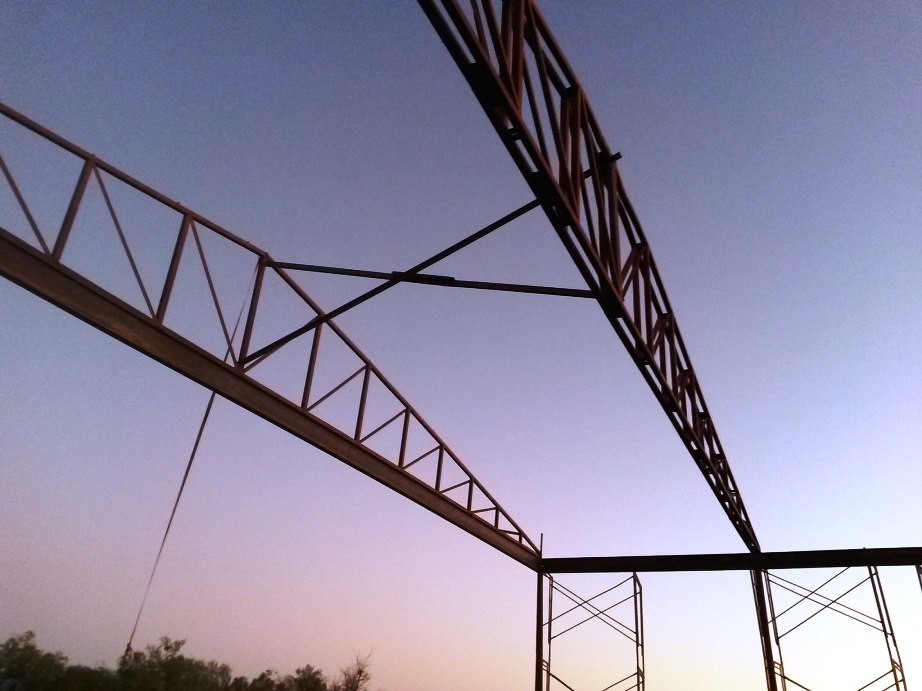

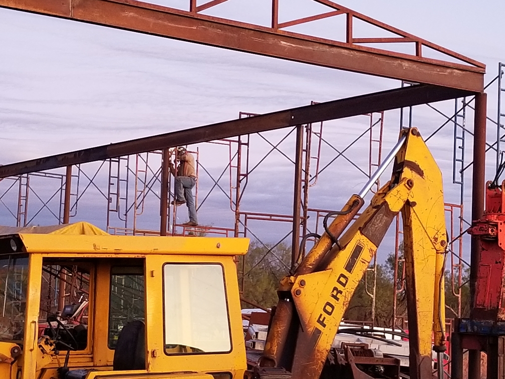

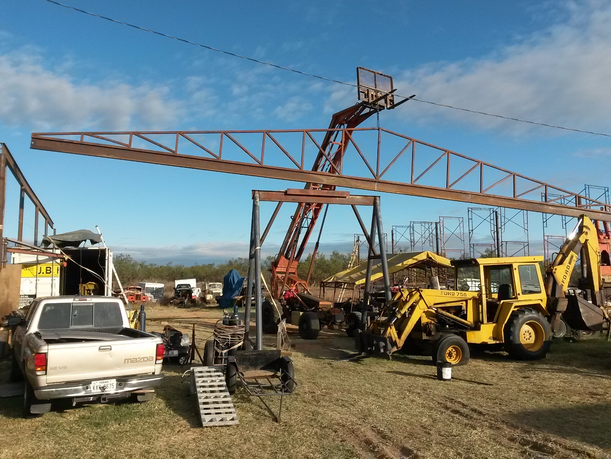

    3 days of climbing scaffolding dozens of times, hanging off the rungs of the scaffolding while welding is just about to get old for this old man. However I can see the light in the tunnel growing nearer with each passing day I think it may the a search light on a UFO or a train but the shop is coming along.
    now have 4 of the 5 trusses in place and some temporary x bracing welded in place just encase things have to go into slow motion for a while I don't want the wind to wreck what I've already done.
    that's me playing monkey while welding

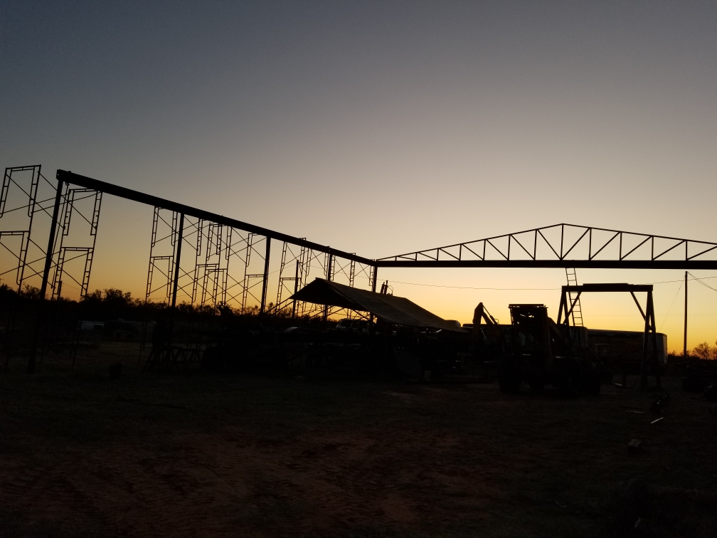

    Just after sundown yesterday

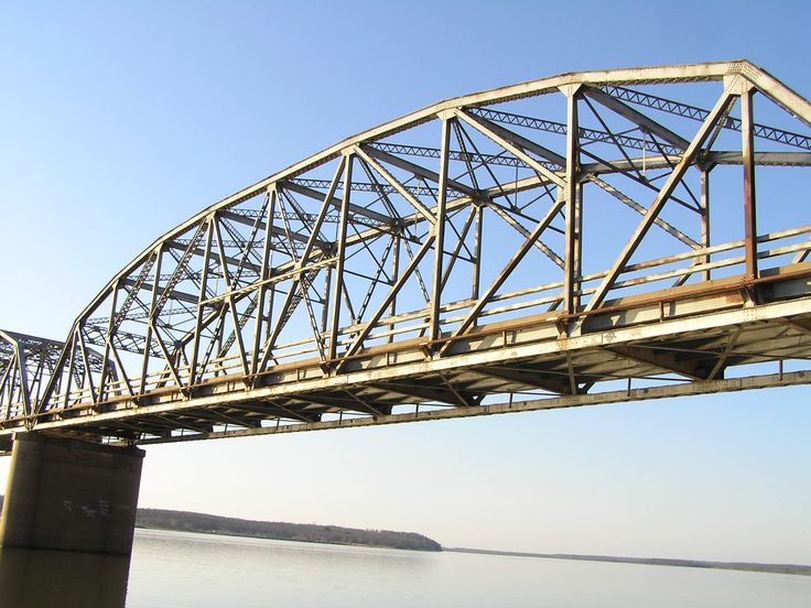

    To be honest I should start a thread called how not to build a shop building.
    A few things I have been thinking of doing to it as time goes along. First off I have a School buss that is just sitting in the woods collecting weeds around it. It has a good diesel engine I need to pull out to be installed in one of my "B" model macks that I want to turn into a pickup or a flat bed straight truck the buss though body wise is in great shape and would make for some really good mezzanine storage atop of the shipping container So what I will do is remove the body from the frame cut it off right at the windshield cut the skirt off the body so the bottom of the floor of the buss will sit flat on top of the container roof This will make a great storage area up out of the way of everything else.
    There is a good chance that I may do this to the 2 trusses on the West or Entry end of the shop a lot depends on how much excess materials I have laying around
    Took the first step towards building my shop-27652d01bb7f36458564bb73222558e1-oklahoma-bridges.jpg
    If I do then I can construct a 15 by 68 ft. office space between them and still maintain the clear span opening for a 3 top hung sliding door opening allowing me to have a 44 ft wide opening from either side or just open a 22 ft. wide single section
    this will also mean I will have a place to construct an elevator to lift materials to the mezzanine where the school buss will probably be placed and then on up to the office floor.
    But it will also mean that the building will wind up being 28 ft tall in front instead of the 24 ft height at the center of the trusses now
    But it will give me a lot more sq footage. Actually by the time the 45 ft machine shop van is attached to the South side and the 26 ft tool and bolt storage van attached outside of the East or the rear of the building I will have close to 6000 sq ft of useable floor space while still only having to pour a 4000 sq ft slab
    The plans are also to add a 38 by 40 ft lean to canopy on the south side to park my tractors and other equipment under

    My Idea of acquiring a pair of old steel bridge trusses got shot down the County road department decided to leave the old bridge where it is as a hysterical monument
    Not the one I showed in the picture but similar in design, about 8 miles from the house is an old bridge that has a span of 70 ft and is 17ft 4 inches outside to outside.
    Last spring they were talking about giving it to anyone who would haul it way We checked with the county this morning only to learn they had changed their minds.

    I demolished a 68 x 100 clear span building about 6 years ago it had 11 trusses some were damaged so what I did was repair then double 3 of them, the 2 end trusses were undamaged so I attached the 12 x22 lb beam to the bottom of them.
    the trusses in the old building were on 10ft spacing with almost zero bracing but they had crane rails hanging under the trusses at about 15 ft from either side of the building and a 35 ft long 2 ton bridge crane hanging on those the old building had stood for 40 years before the company who owned it sold it to a friend of mine they removed the cranes and the rails causing some damage to the trusses 10 years after my friend bought the building there was a freakish snow storm for the area where it was located the 15 inches of snow load was more than the damaged trusses could withstand or it may have been the 2" 16ga round tubular purlins the building was constructed with to support the roof either way one section of the building collapsed as it did the whole roof came down on 1 side in a domino effect further damaging the trusses I had removed a large portion of the damaged roofing and had started raising the trusses back to height the columns were also only made out of 11 ga 4" sq tubing 9 of these were bent during the collapse I had just about all of the trusses back to height and partially repaired but held up with temporary jacks with very little additional bracing I had all of the materials to construct tabernacle bracing from truss to truss when I became ill and I had to put the project on hold for a few days during that time we had an Ice storm very common here in Texas but not having competed the additional bracing the combination of the weight of 3 solid inches of ice inadequate bracing and 60 MPH winds brought the building back down this time we decided to just demolish it So I salvaged everything salvageable.
    Skip to the current building 5 trusses on 15 ft centers 2 single thickness trusses with 12' beams 2 trusses that are doubled with 2 1/2" spacer tubes between them additionally held together with 10ga by 6" by 12'' long strips of metal welded on top and under the trusses tying the 2 sections together making a truss that is 4 times stronger than a single width truss the 5th truss currently is 2 trusses sandwiched together but I damaged it slightly in moving it around previously so I will re build it and possibly use my remaining materials laying around to make it a triple width truss
    What I call Tabernacle bracing is essentially a lattice type brace that would resemble a bar joist down the center of the building the full height of the center of the trusses there will also be a grid work of horizontal bracing run diagonally between the trusses.
    By the time the building is complete it should be capable of withstanding the errant 100 year snow or ice storm
