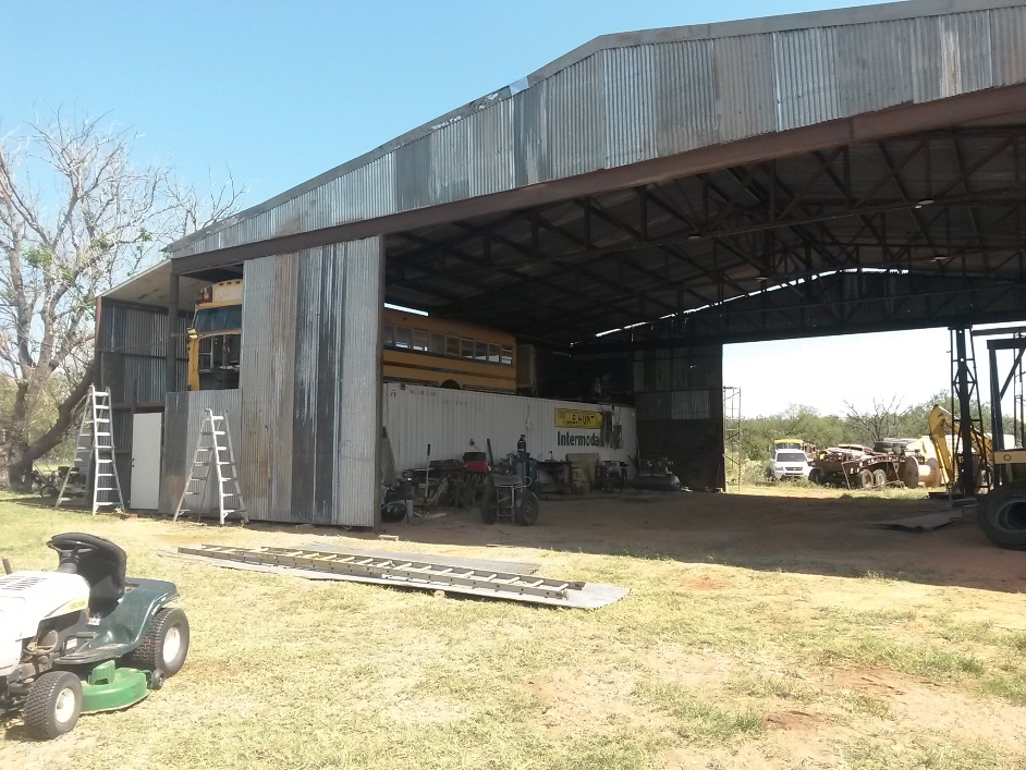

    Progress on the shop may, or I should say will slow down for a while. Today was the last day I had my helper from out of town also we have exhausted most if not all of the long sheets of sheet metal. And for the second time in a week we have ran out of screws again. When he arrived I had a bag of 750 then bought another 200 then another 500 and we might have had 3 left when we quit at noon today.
    I think I'll order another 1000 next week rather than pay the high prices of the hardware stores within 75 miles of me.
    Here is what we did this morning

    I think you said a 40 foot rollup door was going to be installed in these openings. Or is this one of those aviation hangar style doors that folds in the middle?
    What I have is a 17 by 48 foot billboard tarp that I will attach at the top and attach a long heavy pipe at the bottom with flanges on each end to form cable spools. with cables wound around on the ends then up to a set of pulleys and over to a winch when I wind the winch the spools on the bottom of the door will unroll while rolling up the tarp. I could also add another feature by attaching some braces and stays then roll out the tarp as an awning canopy. This would be a huge PLUS in the summer afternoons.
