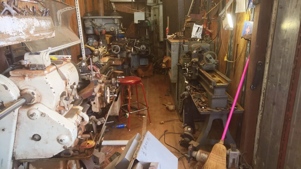

    In my 53 ft intermodal container I had 3 lathes, a Cincinnati horizontal Mill and an American Vertical mill. plus there is a lot of other stuff in there so the only part I could do any work out of was right at the entrance. I am thinking that soon I may need to have a couple of these lathes put in service or at the very least have them under power incase I may want to sell one of them.
    The first step was how to get the LeBlond 26x40 lathe out without having to remove everything in front of it Now that I have the electrical panels in place the fork carriage on the backhoe is too wide to fit inside the container meaning the Cincinnati was going to be difficult to get out and return after the lathe was out.
    I used a couple comealongs and lots of pry baring to turn it to an angle allowing just barely enough room to slip the 6000lb lathe past it, a long chain connected to the backhoe to pull it reduced the amount of jacking and baring for this task.

    in its new home inside the Allied moving van/ machine shop van

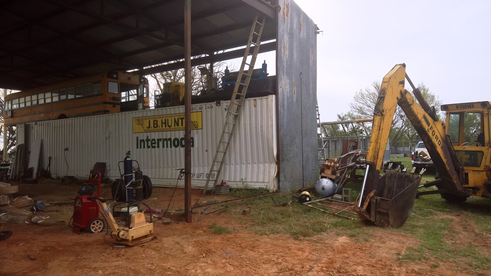

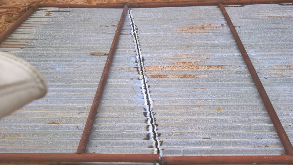

    Ever since I started the shop project I have had a thought of how to incorporate the tent door into the structure. the tent door some may remember was an 8 1/2 ft high 20 some odd feet long gate like wall I constructed to close off a side between my 2 shop trailers and serve as a door when needed to access the tent from the front side.
    So today after digging a hole in the ground then used my plate packer to embed another truck rim to serve as an anchor for a post I wanted to put in the East end of the shop so I could start building a wall there.
    I started thinking about the tent door once again. being 8 1/2 feet high it would have meant I could have the wall half way to the top plate almost instantly all I would then have to do would be to insulate it and sheet the inside to protect the insulation after taking a look at it I decided since the sheet metal had been run lengthwise making it horizontal and I want the sheet metal running up and down I decided to stand it on end and trim it to fit the slant of the roof I would still cover nearly half of the proposed wall area just all the way up in one section. plus it was the exact correct width to cover the entire end of the container and the elevated work space above.
    never waste time with a grinder or a saw when you have a torch available
    Took the first step towards building my shop-wp_20200913_17_10_52_richew.jpg
    I have it clamped in place will have to dig some dirt out of the way before I can plumb it to vertical then weld it in place
    Took the first step towards building my shop-wp_20200913_18_07_03_richew.jpg
