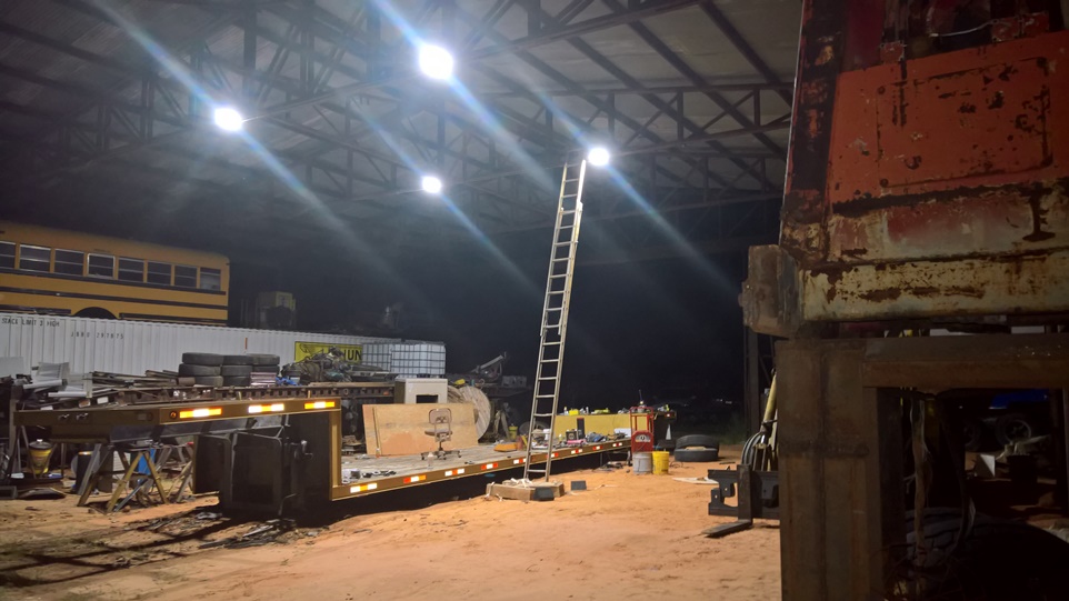

I been in shops that didn't have lighting that good installed for normal use. It's surprising to me that two 100s are giving off that much light.

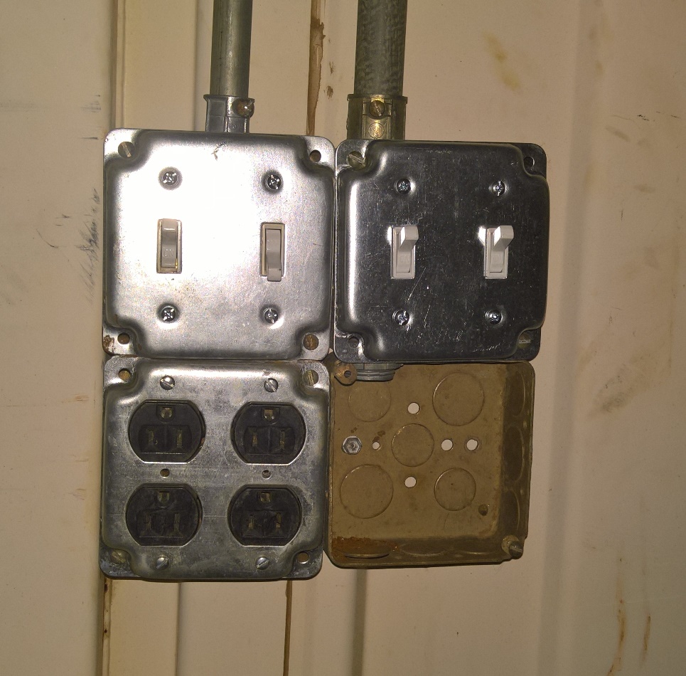

Well I now have 4 lights in my shop completely connected Eventually there will be 4 to 6 zones in the main shop area I probably won't have more than 500 wats per zone.
Right now I have them divided into 2 zones

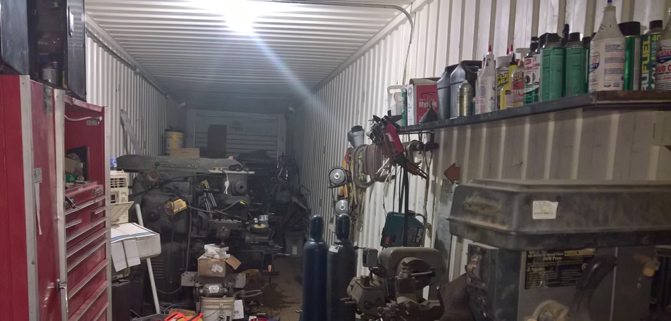

the switches on the left are for the inside of the container one switch will light it up enough to find stuff while #2 will make it daylight
the 2 switches on the right are the first 2 zones in the main shop I ran 3/4EMT to each zone so I can add as many conductors as needed later
This is what a single 15 watt light does inside the container
Frank; Where did you get your UFO high bay fixtures from?
I see them on eBay, but don't know about quality, they seem to differ in heat sinks.
I thought 3/4" conduit was big enough when I wired my garage in 1990, but back then I had TW insulated #12 wires, and pulling in 10 of them was a real workout. But I over wired it for 120 and 240 wall and ceiling outlets. I see the NEC allows 16 THHN #12 s. But I bet that's still a tight fit.
I got them off Ebay from a seller in Delaware the lights are obviously china made as are 90% of all these types of lights even big branded companies like Sylvania GE Osram have a huge percentage of their products made in the PRC
I bought mine on an 80% discount sale which tells me they were either an overstock or an item which was soon to be discontinued.
They may or may not last for a long time if they do, GREAT. if the don't , fine. I'll do like I have had to do with every other type of lighting I've used in the past. replace them.
The light assemblies weighed a little over 4 lbs each or about the same as the domed high bay of the same size did but they have a higher quality offered in the UFO style that weighs 9 lbs each with double the amount of heat sink These would be the ones I will probably be purchasing as I add more lights to the shop. I only bought these first 4 because I wanted to get some lighting up without breaking into my piggy bank at this time.
